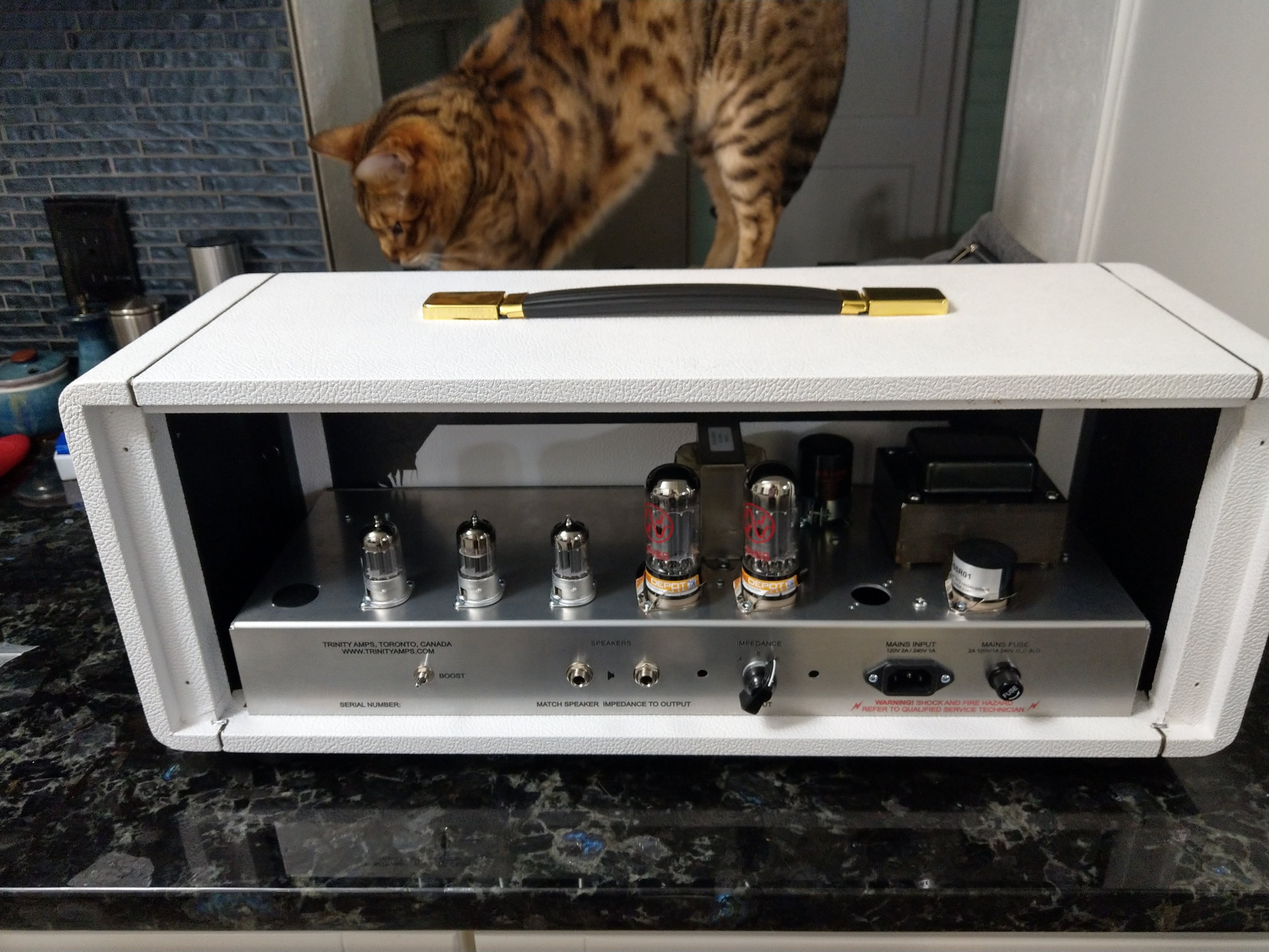

I wanted to provide a quick update and ask for some thoughts/suggestions. I burned in the amp on a dummy load for about 25 hours total (over a few days) by playing music from an iPad into the input with the channels jumpered.
When I initially tested the amp, I was playing through just the normal or just the plexi channel, not both. When I play either channel there are no issues, I can dime the gain and volume and it reacts like I would expect. I have never owned an amp before with channels that you can jumper, so I am not sure what I should be expecting. Overall the amp does seem quite bright (even with a Les Paul and very bright with a strat). It is manageable when playing either channel. When jumpered, it seems much more bright and I can only run the channels with moderate gain/vol otherwise it runs off into feedback like crazy. At levels where I can control the feedback notes will sustain indefinitely, but there is very nasty distortion happening that is very present/resonant on lower notes.
I am plugging straight into the amp with a 20ft cable, no pedals. Maybe I need to reverse the leads of the OT primary? I don't otherwise have any "classic" symptoms of the leads being reversed like squealing, but I understand it can manifest more subtle than that. Is this a lead dress issue? I can chopstick around if needed.
I tried to at least eliminate the speakers being an issue. I tightened all the screws on the back of my cab, did not really help. I removed the middle piece to make it semi-open back. Helped a little, but I think that is because the bass is less dominant. Loosened the screws mounting the speaker a 1/4 turn each, no change. I also tested through an egnater tweaker 1x12 cab with a broken in G12H30. The highs were much more in line with what I expected, also a lot less bass than I would have imagined (it is a vented cab). But the nasty distortion is still present, though not as prominent.
I swapped tubes around too in the preamp and do not think that is the issue. I don't have an extra set of power tubes, but can order if that is advisable to eliminate it as a possibility.
Thanks in advance!

To report my progress since my last post, I have moved wires around with a chopstick quite a bit with no significant changes. Sometimes by moving wires I could induce more background hum, etc. But it did not impact the amp having nasty distortion riding under bass notes or it wanting to feedback with channels jumped.
I swapped OT leads for the primary. When I did this the amp did not squeal/howl, etc. It did seem like it wanted to feedback easier and more brittle/high pitch sounding when channels are jumped. So, I swapped them back as they were.
I took another set of voltage readings, a couple notes...I have swapped preamp tubes a bunch so this is a totally different lineup than when I took the initial voltages on fire up. Also, when I first took voltages, I was on a dummy load. This time I was on the 1x12 G12H30 cab. When I took the voltage for pin 3 of V4, it induced squealing and the voltage was moving quickly around in the range of 393-399VDC. No behavior like that on pin 3 of V5. I did not take voltages with OT leads swapped.
I am going to visit my parents for the weekend. When I get back, I'll make a short recording of the sound. I am thinking it may be crossover or blocking distortion and I may need to try the Paul Ruby zener diode clamps.

Dan, I don't know if this relates to your problem, but I noticed that a lot of your wiring on V1,V2 and V3 parallel each other (plate, cathode, screen and shielded) and some cross over the black heater wires. The parallel wires in particular concern me because if I recall correctly wires crossing 90 degrees are usually OK, but it is recommended that wires carrying signals DO NOT run parallel. Also DC crossing AC (heater wiring) is probably a bad thing, especially DC wires carrying signal. So, you might try adjusting your lead dress. Think vertical plane, too, instead of just one horizontal plane. Wiser heads may have more insightful advice :!:
PostPosted: Tue Oct 20, 2020 6:19 pm
viewtopic.php?f=7&t=6120 Here is a thread where Coco and mitch m comment on lead dress
