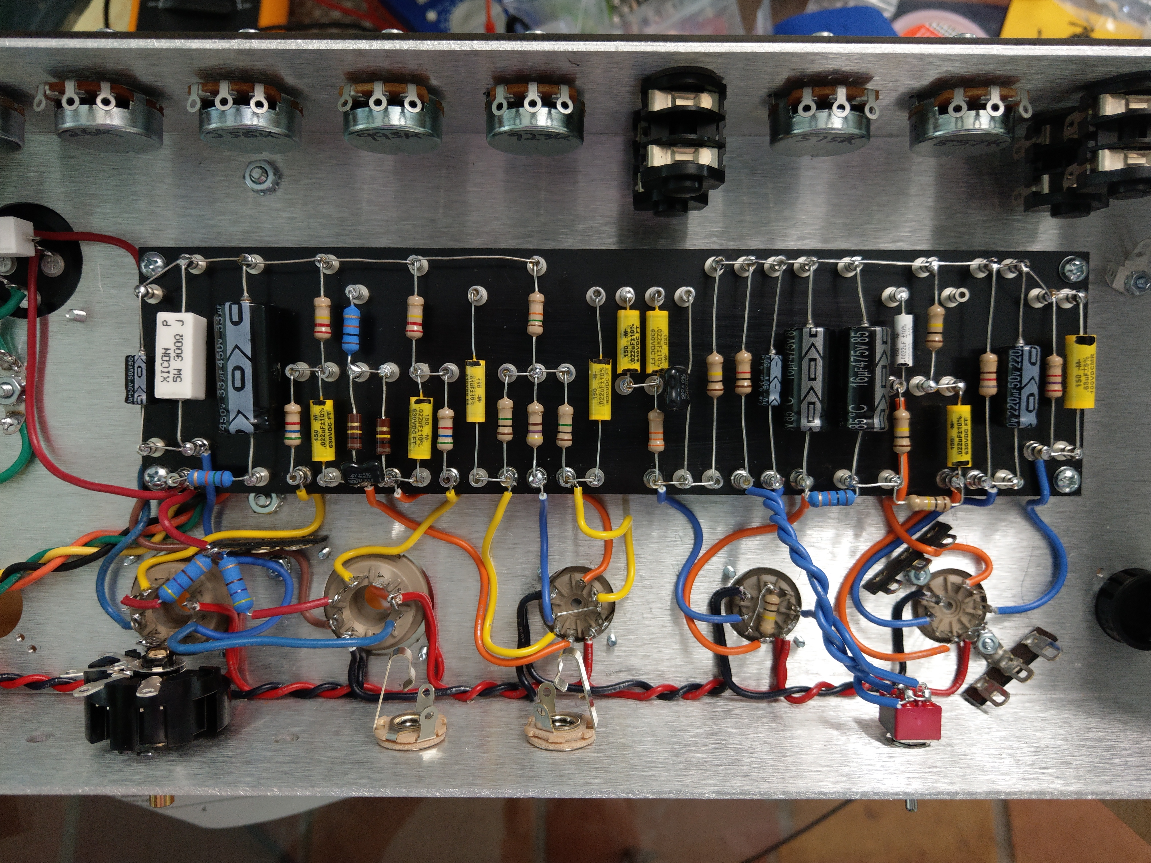

I also got the board populated. My first time with turrets. I think it went pretty well so far. I had previously tested all the Mallory caps for outside foil and marked them accordingly.

PostPosted: Sat Sep 12, 2020 7:14 pm
Nice build. I wish my first and second builds looked that good :!: :thumbsup: :thumbsup:
PostPosted: Sun Sep 13, 2020 1:07 am
The board looks good. I assume the turrets that aren't full of solder yet are so you can attach the fly off wires.
The white cabinet with the gold piping and Bluesbreaker grill cloth looks amazing. Really nice workmanship.
Yes, the extra gasket material for the speakers is so you can front mount them.

Posts: 31
Thanks for the feedback, I appreciate another set of eyes!
I was going to fly the wires from the bottom of the turrets on the top side of the board. When I was adding the resistors and caps, it seemed like some turrets wouldn't fill up all the way with solder. All of these seem to have a solid connection and aren't dry joints. I also checked the pictorial reference thread for the plexi and it looked like many of those turrets were the same.
I can go back and add more solder if this is an issue.
