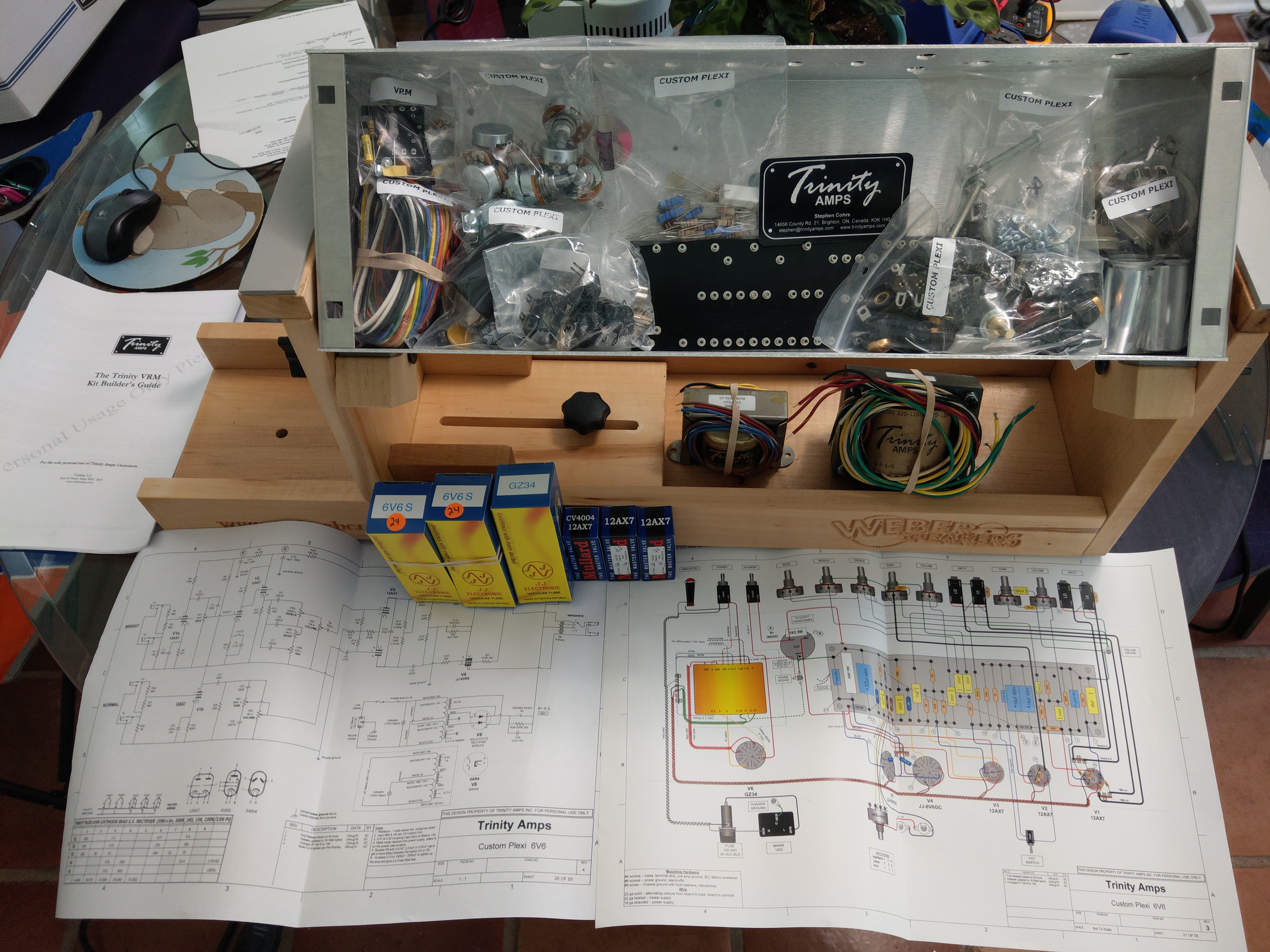

Hi All,
This will be my first amp build, but I have built lots of pedals and modified a Fender Champion 600 amp previously. I'll update this thread as the build progresses. Received my kit in the mail today and got started. My tubes and speakers are here too and my head cab and extension cab have shipped and should be here Wednesday from Guitar Cabinets Direct.
Tomorrow, I am going to go through the resistors and caps to check values. I am also going to give a go at identifying the outside foil on the Mallory caps.
One thing I did notice so far, the 300r resistor for the 6v6 cathodes is 5 watts in my kit. It's identified as 10 watts on the schematic and layout. Will this present an issue?
I also measured all the pots while installing them and selected among the the 1M values for the positions I thought made the most sense. Lowest in Normal Channel Volume, 2nd lowest in Plexi Channel Vol; highest in Gain, and 2nd highest in Bass.
-Dan

PostPosted: Sun Sep 06, 2020 2:21 am
Hi Dan, welcome to the forum!
I never thought about grading the pots as you have done. They are all fairly close to the expected values, though, as tolerances in the 1M range for tube equipment goes. I don't think it will make much difference which one is installed where in the amp. The way you have them is good. The only place where the value could be a bit critical is the bass control since it's part of a tone stack tuned for a certain frequency response.
That 300R 5-watt cathode resistor is probably OK if that's what you got with the kit. Once you get the amp working just check its temperature. If it's too hot to comfortably touch, then the wattage should be higher.
It's good to identify the outside foil on the capacitors. It's easy to do and there aren't that many in the amp so it shouldn't take too long. Installing them the right way will help keep the hum and noise to a minimum.
Your chassis is looking good. Best of luck with the rest of your build!

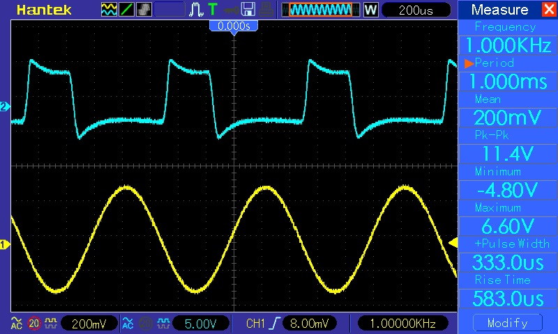

Alright yall, I'm back and hoping this post may help shed some light on where to look to fix this issue. After much digging on several forums it seemed like I was going to need a scope to properly diagnose the problem, so I took the dive. Here are some screenshots from the scope. It appears to me, I am dealing with crossover distortion. But, not sure what to do about it.
I ran a 1K sine wave into the input of the amp, from an app on my tablet. I'm commenting the amp settings in the caption below each picture. Scope was on on the output jack. I'm attaching pictures at clean settings and then the setting where crossover distortion is most apparent. Past that it goes very square wave.
On the Plexi channel and with them jumped, I can control/effect that hump in the trough with the treble control.
After this I did probe a few different parts of the signal, and I believe this problem first shows up pins 3 of the power tubes.
Let me know if there is anywhere else you would like to see scoped out or anything different, etc. I have a lot more screenshots at volume settings 2, 4, 6, 8, and 10 for a few configurations.
Thanks for any insight!
