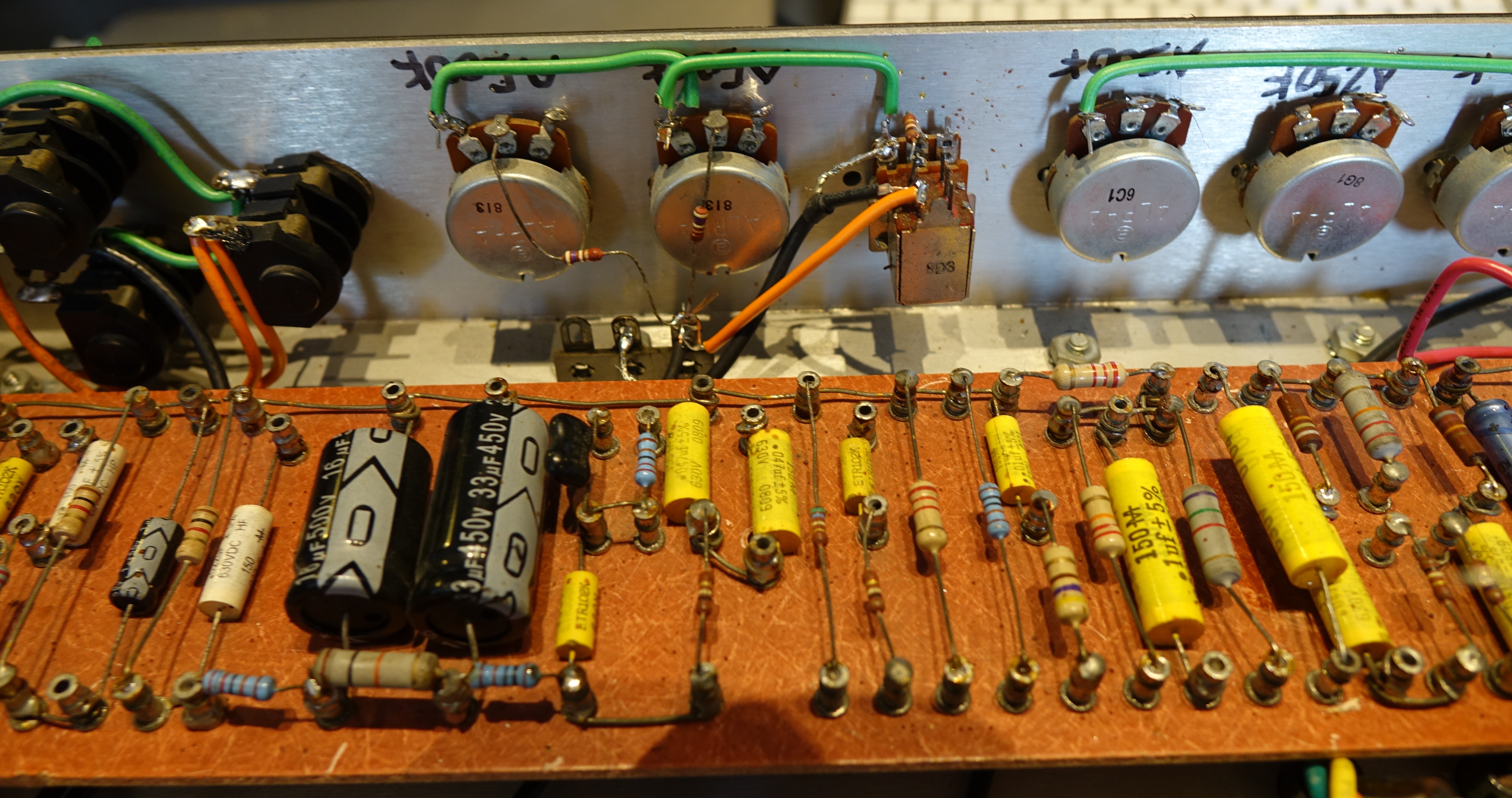

Another question.
I am checking everything from scratch, desoldering most.
But I am having some doubt on which way to solder the caps.
My caps are not same as you have posted here
viewtopic.php?f=14&t=3734
which are all sozo caps, so I am not sure.
I do assume though, that the right side, according to the text on the caps are +
Please see attached picture.
www.paradisepi.com

Ok, so I just read thi post.
Do direction on tone caps.
viewtopic.php?f=7&t=3175
www.paradisepi.com
My caps are not same as you have posted here which are all sozo caps, so I am not sure.
Only electrolytic caps are polarized with a + marking. Typically over 1uF values.
The coupling caps (.022, .047 etc. ) are Mallory, not Sozo, in your case and it doesn't matter which way they go in.
