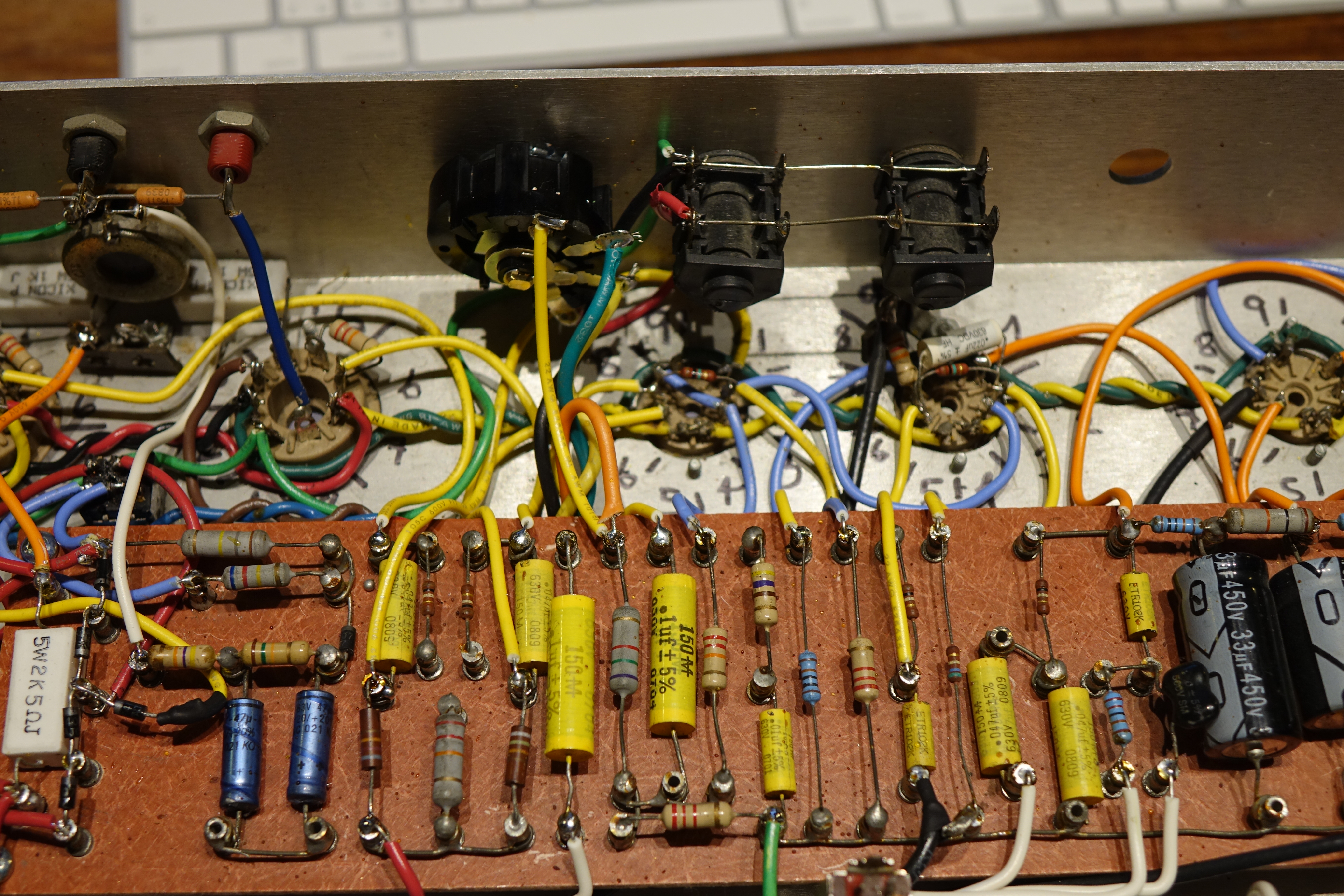

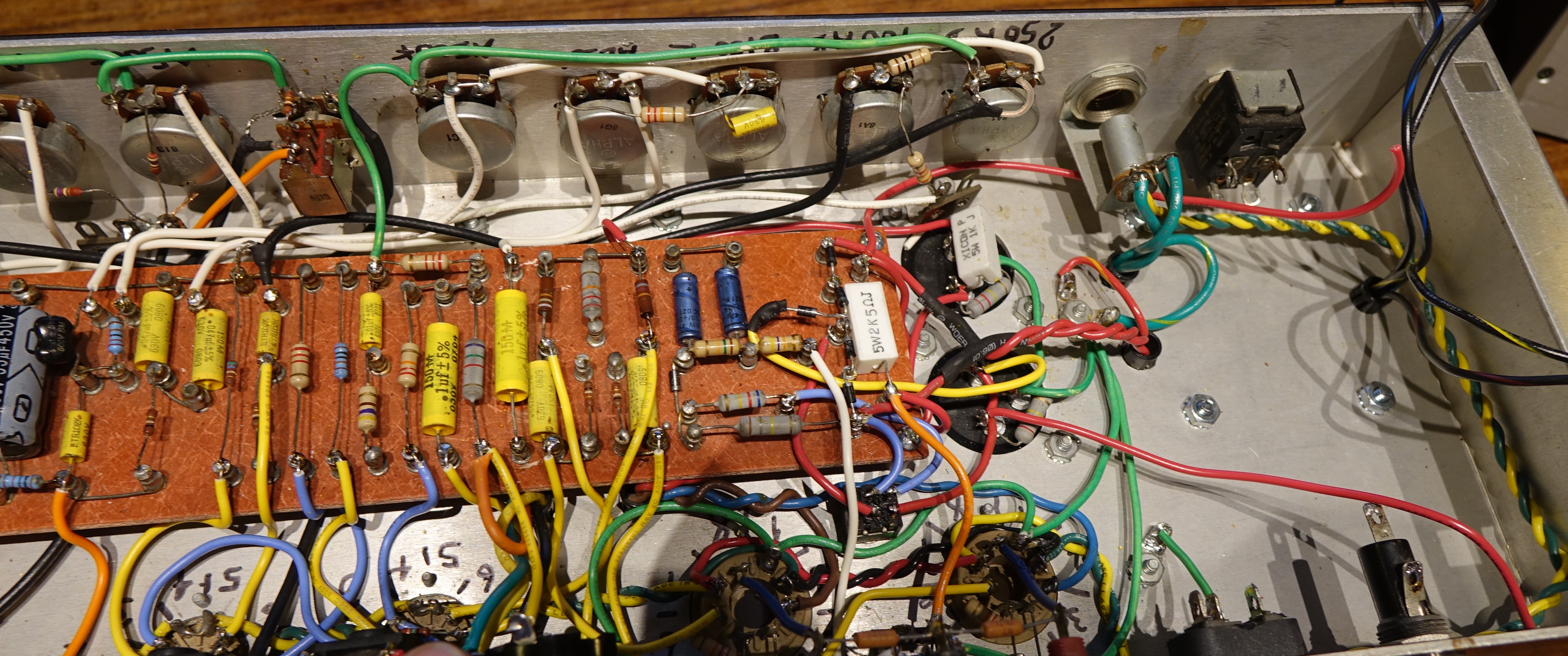

A couple of pics from yesterdays efforts.
I know it looks a bit shabby, but its been dormant for 8 years.
However, all solderings are solid, and all the caps still measures.
So it should work. Well see.
Should be able to finish it today.

 Post subject: Re: Triwatt Revisited.
PostPosted: Wed Apr 04, 2018 3:22 am
Posts: 112
Location: Bangkok
Stephen, do you have a layout for the 240v PT. I am not sure how to solder it.
www.paradisepi.com

Not the cleanest build, but everything checks out.
All the resistors, resists....
Some pics. Let me know if you spot something odd.
PostPosted: Thu Apr 05, 2018 8:42 pm
Looks like you got the OT wiring right. But in an amp that uses negative feedback, there's always a chance the phase might be wrong and it will oscillate like crazy. If that's the case just reverse the blue and brown wires that connect to the anodes of the output tubes.
I have never built a Triwatt, let alone one wired for 240 volts, but looking at the schematic I'd say the 240-volt wiring for the PT primary would be:
Live (from power switch) to Black-Red, Neutral (from IEC connector) to Black, and connect Black-Blue and Black-Yellow together.
