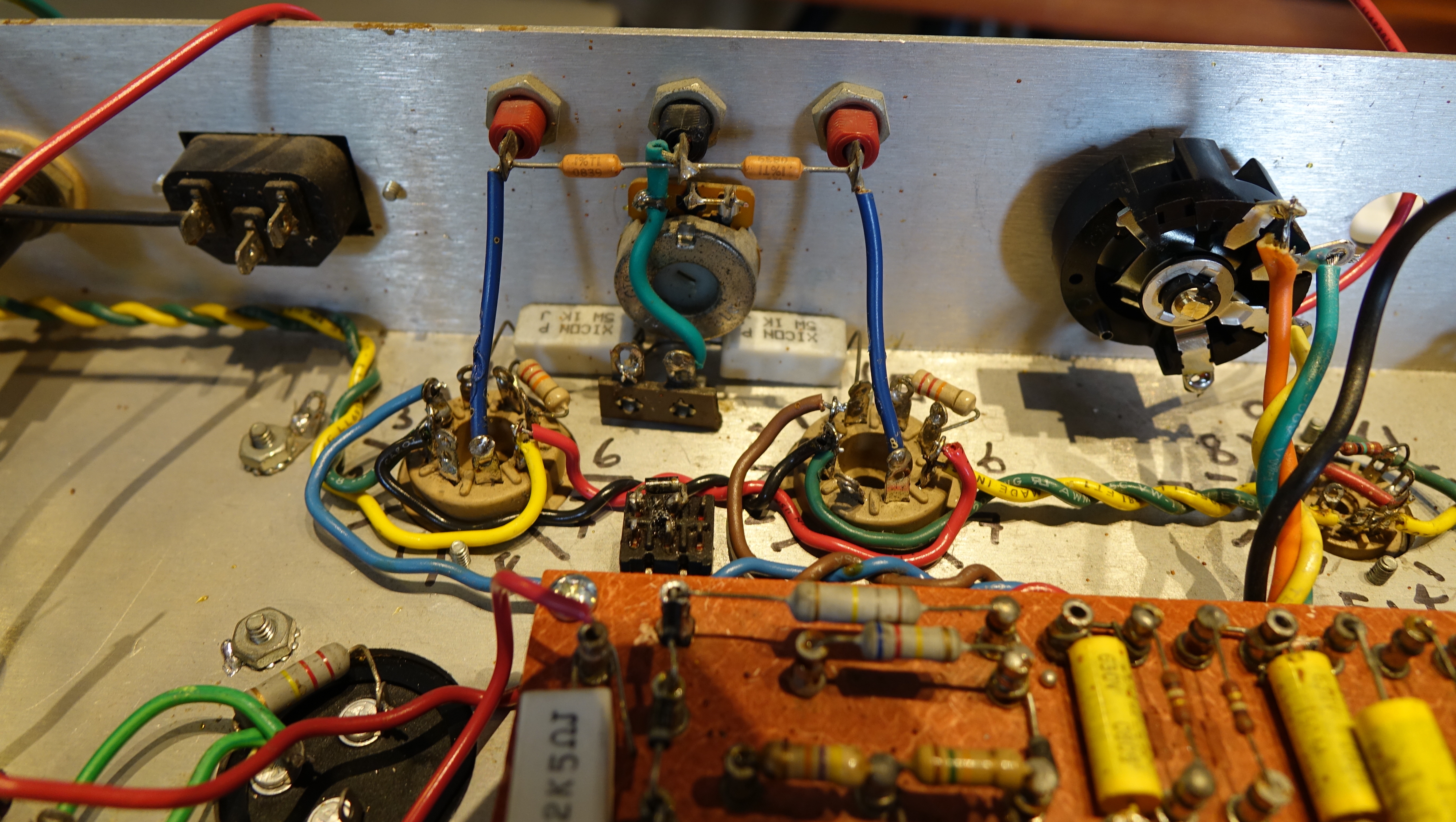

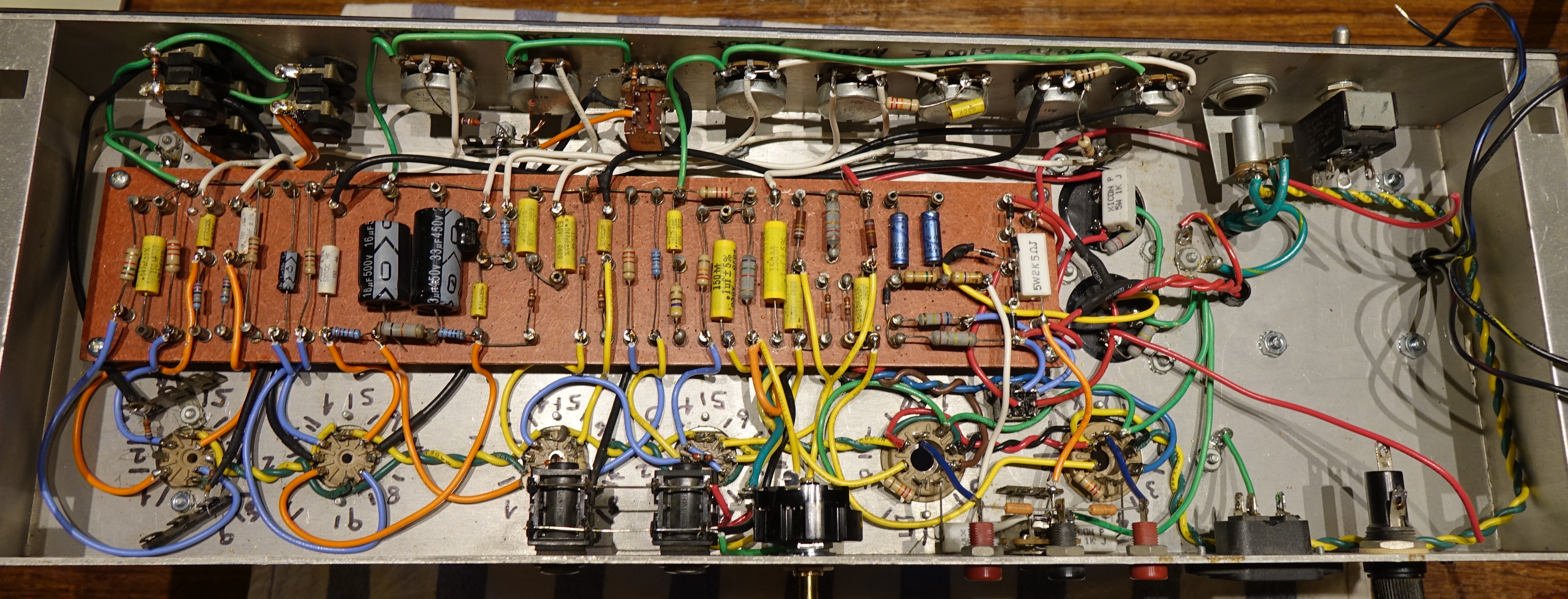

Almost done, just need to wire the PT.
Not the cleanest build, but everything checks out.
All the resistors, resists....
Some pics. Let me know if you spot something odd.

Looks like you got the OT wiring right. But in an amp that uses negative feedback, there's always a chance the phase might be wrong and it will oscillate like crazy. If that's the case just reverse the blue and brown wires that connect to the anodes of the output tubes.
I have never built a Triwatt, let alone one wired for 240 volts, but looking at the schematic I'd say the 240-volt wiring for the PT primary would be:
Live (from power switch) to Black-Red, Neutral (from IEC connector) to Black, and connect Black-Blue and Black-Yellow together.
