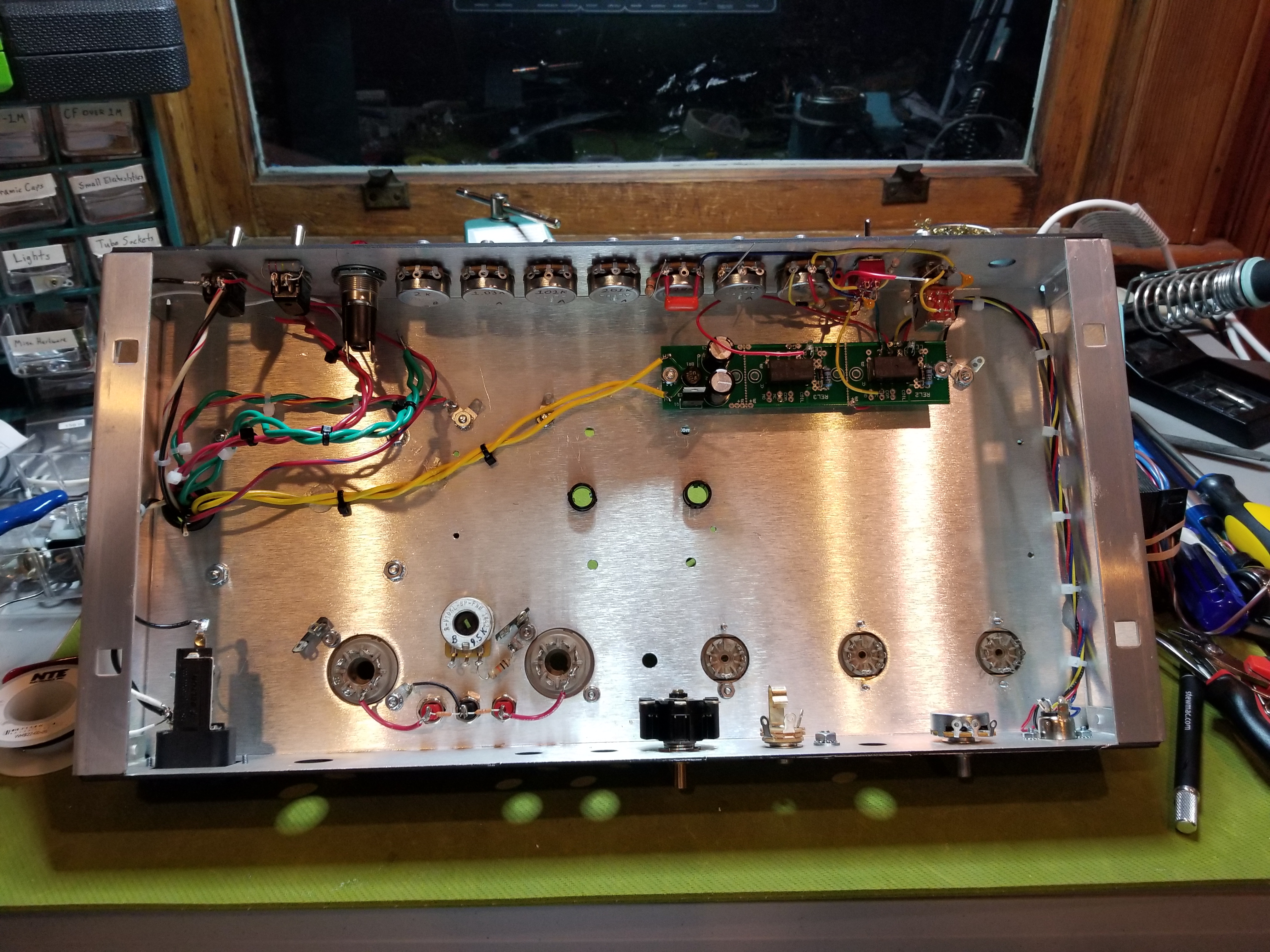

New member to the forum here. I thought I would post pictures of my OSD build as it goes along. I've long loved the tone of Dumble style amps, and I've made some attempts at Overdrive Special style builds in the past. I bit off a little bit more than I could chew at the time though, so I wasn't really satisfied with the results. I've built some Champs, 18 watters, and Trainwreck stuff since then, so it has given me some much needed time to work on my amp-building skills.
I picked up an OSD kit at the beginning of the month because I really liked how Trinity updated the layout - especially removing the FET board and powering the relays straight from the PT. I've been slowly working on it since then when time has allowed so. As you can see from the pics, I used a few different components for the coupling caps and the power light because I had them on hand and have worked with them in the past.
Special thanks to Stephen for his quick email responses when I had a question about the layout or builder's guide!
If anyone spots anything obviously incorrect please feel free to point it out!!!
All the best,
- Matt J.

Here's more of the relays, main board, and chassis.
I haven't attached the leads to the board yet. The stuff you see on the capacitors is a silicon sealant that acts as a shock absorber since this chassis is eventually going to go into a combo cabinet. I don't want the speaker vibrations to cause too much stress to the solder joints or cause the power supply caps to rattle.
Today my goal is to wire up the PT and test the relays.
- Matt J.

Wired up the PT yesterday and tested the secondaries. Everything checked out ok.
Built the footswitch and tested the relays. LEDs on the relay board and the footswitch lit up fine and the contacts points tested ok with my DMM.
I am considering building a different footswitch, or modding the one that came with the kit so that there are different LED color for the OD and PAB switches. Anyone know exactly what type/voltage of LED I would need to look for that would work with the current footswitch layout?
Up next, I'll install the back panel materials, then the tube sockets and accompanying components.
- Matt J.

Got some more work done this week.
Most of the chassis work is now finished. I've tested all soldered connections and things are checked out ok.
Next I'll be measuring and soldering in the flying leads and getting the circuit board ready to be installed.
I did notice that the mounting holes in the chassis were a bit too small for the bias probes, so they had to be enlarged. The same goes for the mounting holes in the relay board. I had to widen them slightly to get the board to fit into place.
- Matt J.
