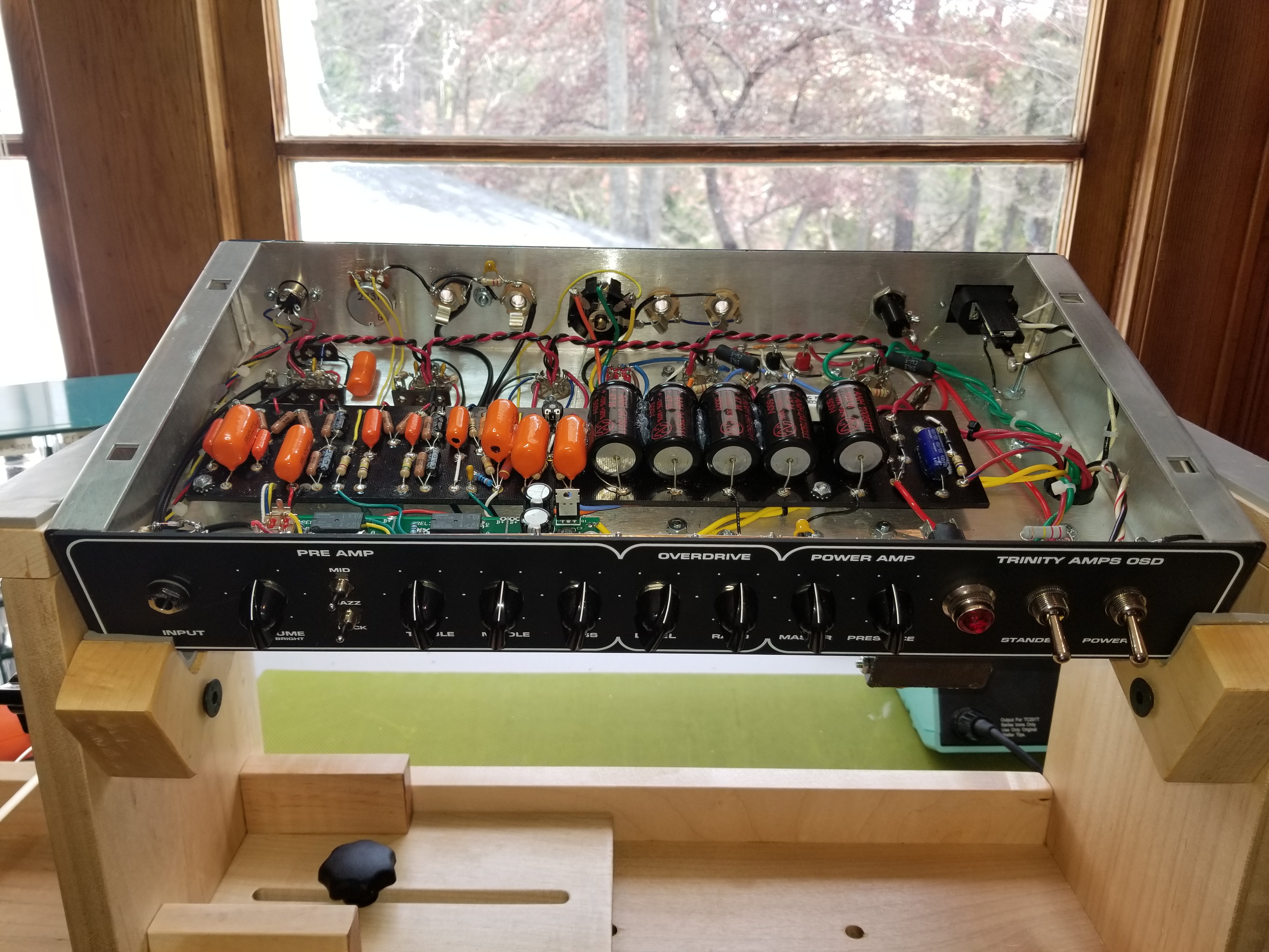

Hey everyone!
New member to the forum here. I thought I would post pictures of my OSD build as it goes along. I've long loved the tone of Dumble style amps, and I've made some attempts at Overdrive Special style builds in the past. I bit off a little bit more than I could chew at the time though, so I wasn't really satisfied with the results. I've built some Champs, 18 watters, and Trainwreck stuff since then, so it has given me some much needed time to work on my amp-building skills.
I picked up an OSD kit at the beginning of the month because I really liked how Trinity updated the layout - especially removing the FET board and powering the relays straight from the PT. I've been slowly working on it since then when time has allowed so. As you can see from the pics, I used a few different components for the coupling caps and the power light because I had them on hand and have worked with them in the past.
Special thanks to Stephen for his quick email responses when I had a question about the layout or builder's guide!
If anyone spots anything obviously incorrect please feel free to point it out!!!
All the best,
- Matt J.

Got some more work done this week.
Most of the chassis work is now finished. I've tested all soldered connections and things are checked out ok.
Next I'll be measuring and soldering in the flying leads and getting the circuit board ready to be installed.
I did notice that the mounting holes in the chassis were a bit too small for the bias probes, so they had to be enlarged. The same goes for the mounting holes in the relay board. I had to widen them slightly to get the board to fit into place.
- Matt J.

Update:
Finished wiring everything up. Checked all connections and made sure there were no shorts. Gave it a test run with the current limiter. Everything came out ok with. Switched on the Standby and checked the B+. The power supply voltages came out ok, within the specified ranges from the layout. I set the bias for the 6V6s and checked plugged in a guitar. The amp did work when I plugged in a guitar, but the volume started dropping pretty soon and eventually cut off. I doubled checked the plate voltages and found an issue with V1B. There, the plate voltage was well over ~310DVC, when it should be about ~210VDC.
I've checked over the plate resistor, it measured out to the correct 100k, same with the 1.5k/10uf cathode setup. I switched out tubes in case one was faulty and got the same results. This is the section where the LNFB is located, so I'm curious if that could be affecting the voltage. Any suggestions or feedback would be greatly appreciated!
- Matt J.

Update:
IT'S ALIVE!
I replaced the ground wire for V1B and fired it up. Voltages were much better this time, right at ~200 VDC for V1A and V1B. Gave it a go with the guitar and everything checks out ok: channel switching and panel switches. The presence control really doesn't seem to have that much impact between zero and full, but that might just be from the stock design. There are, of course, LOTS more to do with tweaking the bias, setting the PI balance, OD trim, plus some good old fashioned burn-in time! I want to try it with the normal 6L6s as well. I'll post more pics once the cabinet arrives and start finalizing everything with it.
Right now I'm testing it with my Stratocaster. I picked up a 1990 Gibson Les Paul Studio last week and as soon as I put some new pickups in it and properly set it up I'll give it a go too. I'm really looking forward to seeing how a humbucker equipped guitar functions with the amp.
I took the ground wire I removed and tested it with the DMM, the continuity seemed to jump in and out with some slight flexing, so something must have shorted out within it.
Happy Easter everyone!
- Matt J.
