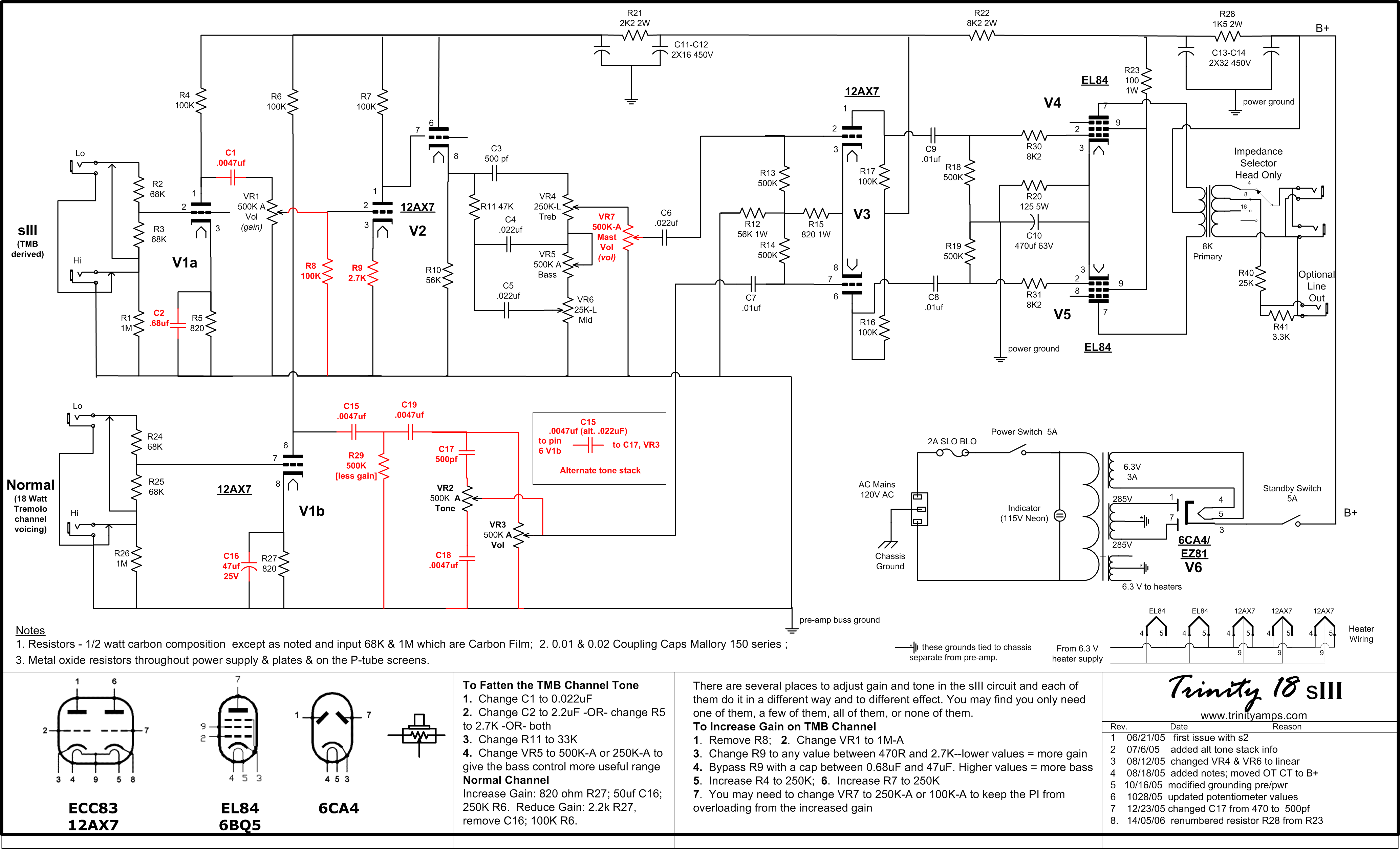

sIII Schematic rev 1.9:

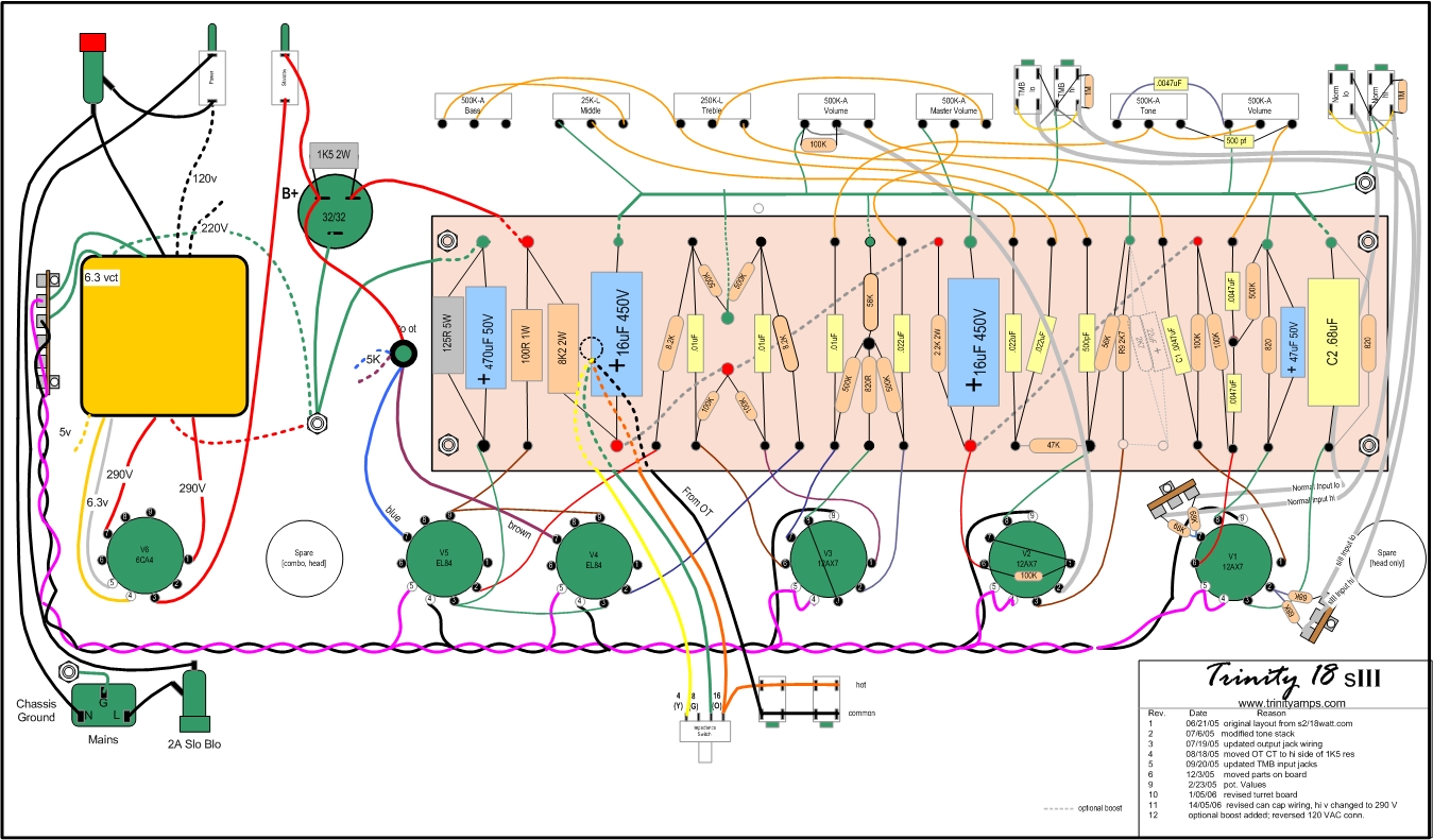

sIII Layout rev 2.1:
Note: You can Right-Click on the picture and save to to your computer for later reference.

sIII Version 1.4 now posted. This one has the 4 input jacks.
PostPosted: Sat Dec 31, 2005 1:57 pm
Schematic rev 1.62 and Layout rev 1.8 posted

 Post subject: Version control
PostPosted: Mon Mar 13, 2006 12:03 pm
Joined: Sun Mar 12, 2006 6:46 pm
Posts: 23
Location: AMSTERDAM The Netherlands
Hi Guys
Gonna build me a 18 watt sIII. I dont need the treble.
Is the latest version of the schematic Rev. 7?
I am gonna build from scratch :shock: I found the trannies in my junkbox.
Orderd the R's and C's at Conrad's, chassis will be made at work.
The woodwork for the cabinet i dont know yet.
I will keep things posted
GRTZ
Ed
PostPosted: Mon Mar 13, 2006 12:50 pm
There is a new rev that I need to post. Basically, uses 500K 25K & 250K pots instead of 470, 22, 220.

PostPosted: Fri Mar 17, 2006 11:32 am
sIII Layout v1.91 Update & posted

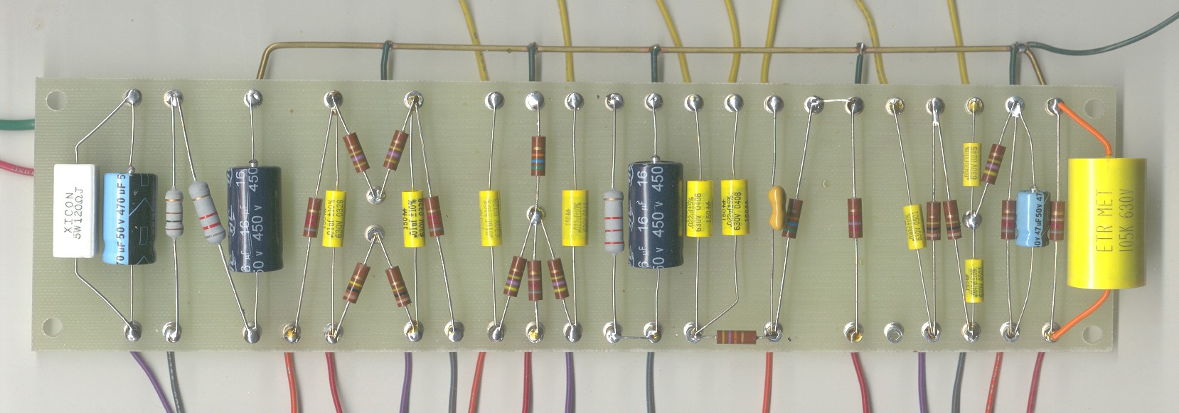

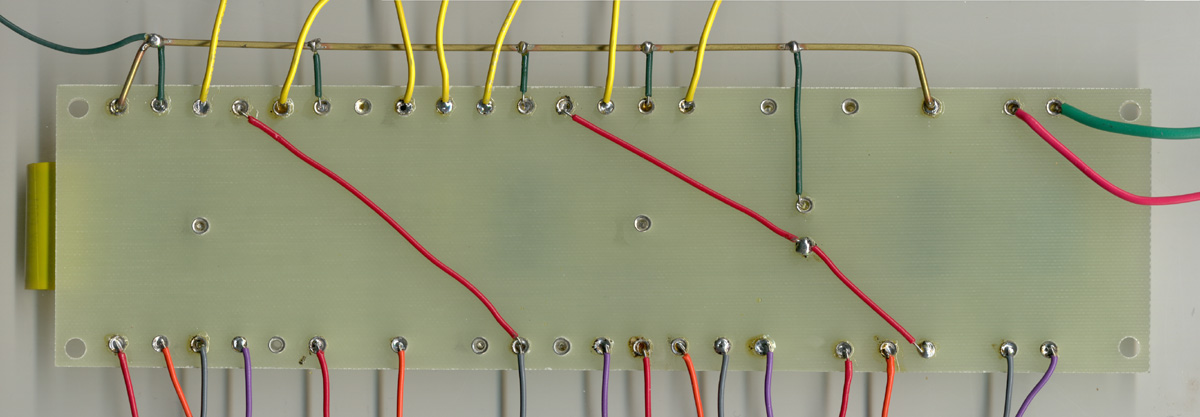

 Post subject: sIII Board Pictures
PostPosted: Sun Apr 09, 2006 10:00 am
Trinity sIII Board - Top View. Right Click to Save to you Computer
Trinity sIII Board - Bottom View. Right Click to Save to you Computer

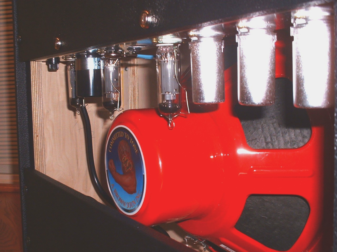

Here are some shots of the NEW in-line sIII chassis. It will work for a TMBMV as well!
In a small head, just 8" X 8" X 24" with 16-1/2" cut-out for the panel. It's oh so nice. Can't wait to get some Tolex on it!
The rear view.

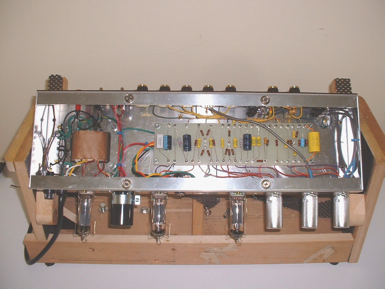

And what would a set of pics be without showing the guts of the shiny new beast ... 8)
PostPosted: Sun Apr 09, 2006 12:44 pm
Joined: Tue Mar 22, 2005 8:56 am
Posts: 126
Location: Virginia
8)
Looks Great Stephen! Are the Orange 16/450s E-caps Ceriatones?
Thanks for sharing!
CR ><>
WoodCross Amps
http://www.geocities.com/woodcrossamps/
PostPosted: Sun Apr 09, 2006 2:16 pm
Yes, those ones were.
PostPosted: Sun Apr 09, 2006 6:58 pm
Posts: 746
Looks great Stephen, when are you going to post some pictures of the guts of the combo you are doing? I am interested in your chassis layout as that is coming up the list rapidly.
Nigel

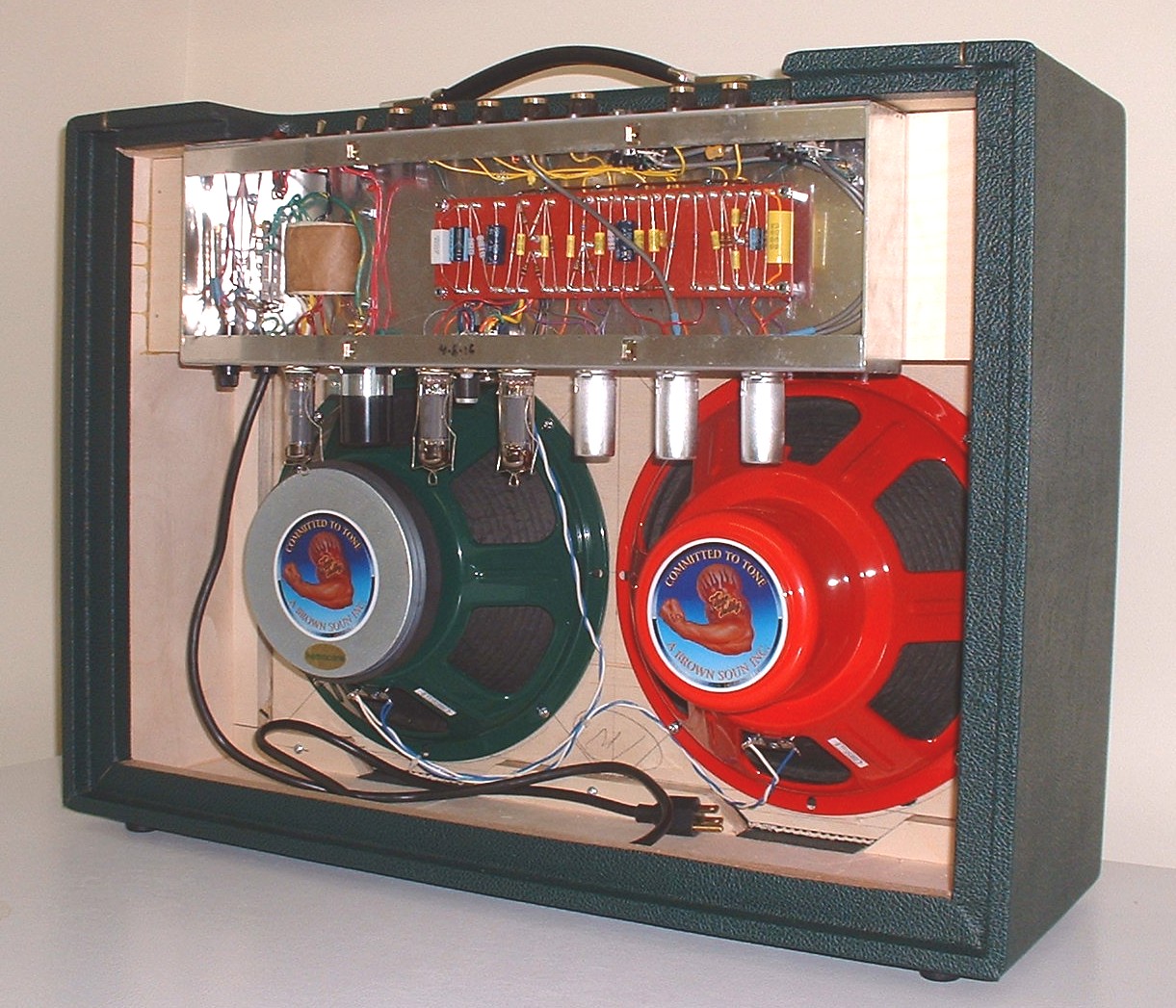

PostPosted: Sun Apr 09, 2006 7:28 pm

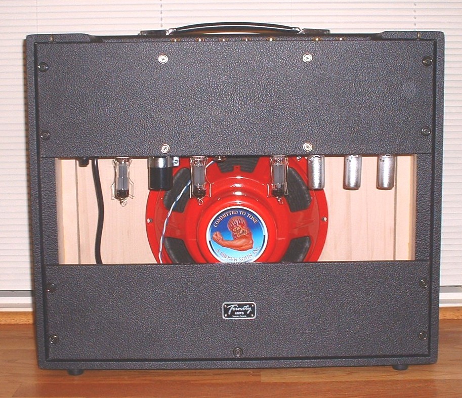

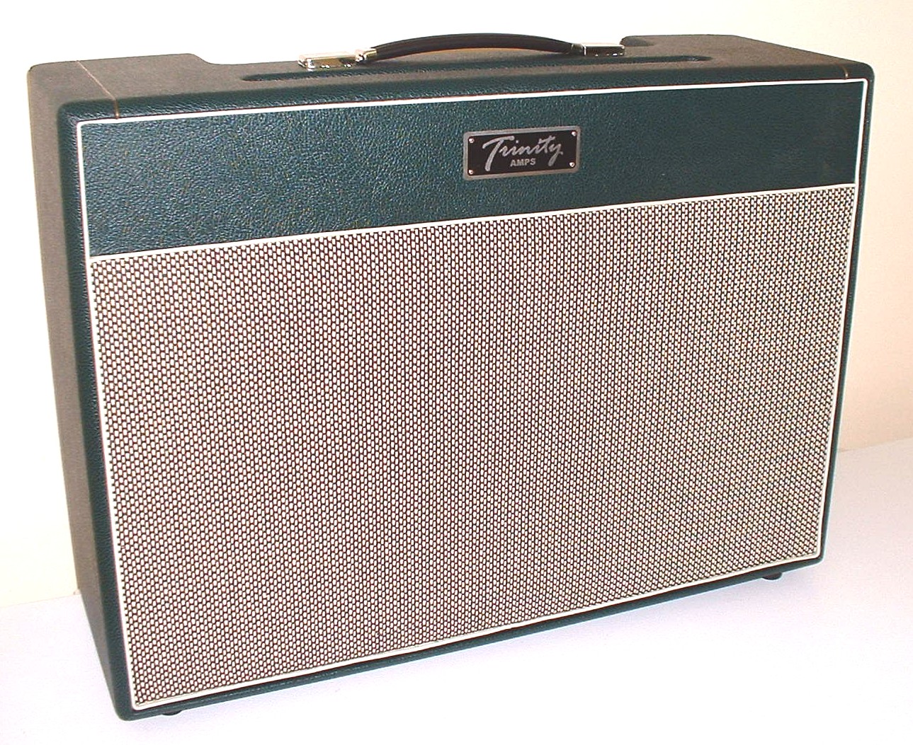

Recent Combos. Sorry for the size!!
