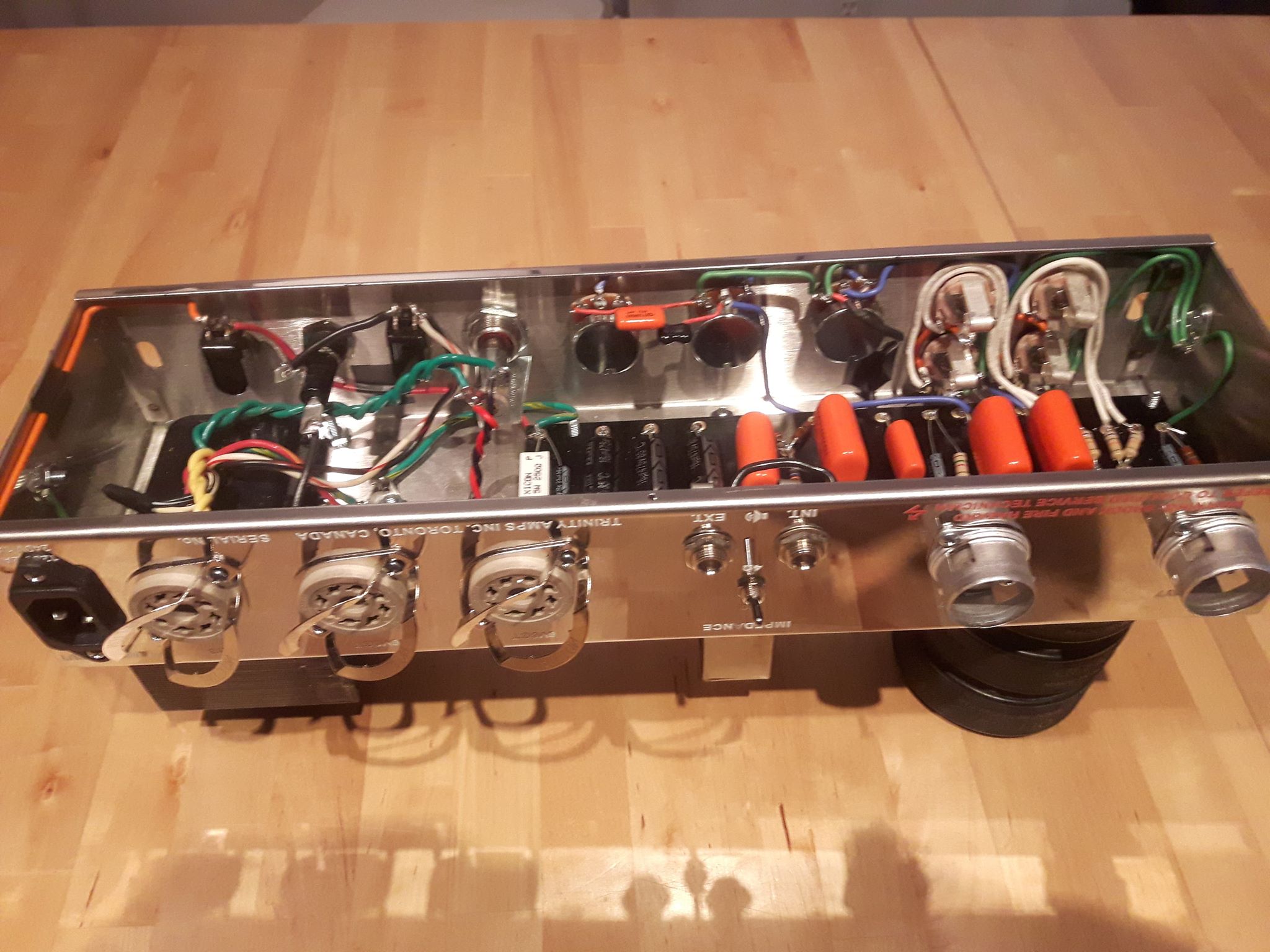

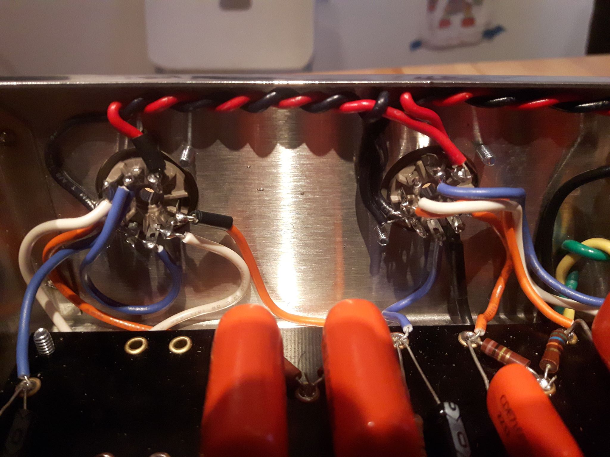

Ok, I've put it aside for a while but finished the build this evening.
I'll do more checks tomorrow but I think it will be ok. I've checked connectivity with my multimeter after each soldering. I've tried to keep wires close to the chassis when possible and keep them away as far as possible from the heater wires. I've put the coax cable is under the eyelets board. Since it has also to be close to the chassis I thought it would make sense. I've taped to it. I was also finally able to twist the yellow wires together from the power transformer, same for the reds. They are tied but I think it's overall better now. I've tried to have an overall neat build and soldering ( and to be able to desolder if necessary).
Oh and yes... I put the screw from the outside to install the board (on purpose, I prefer this way). I'll get 4 nuts tomorrow.
I haven't install the VRM. Maybe later.

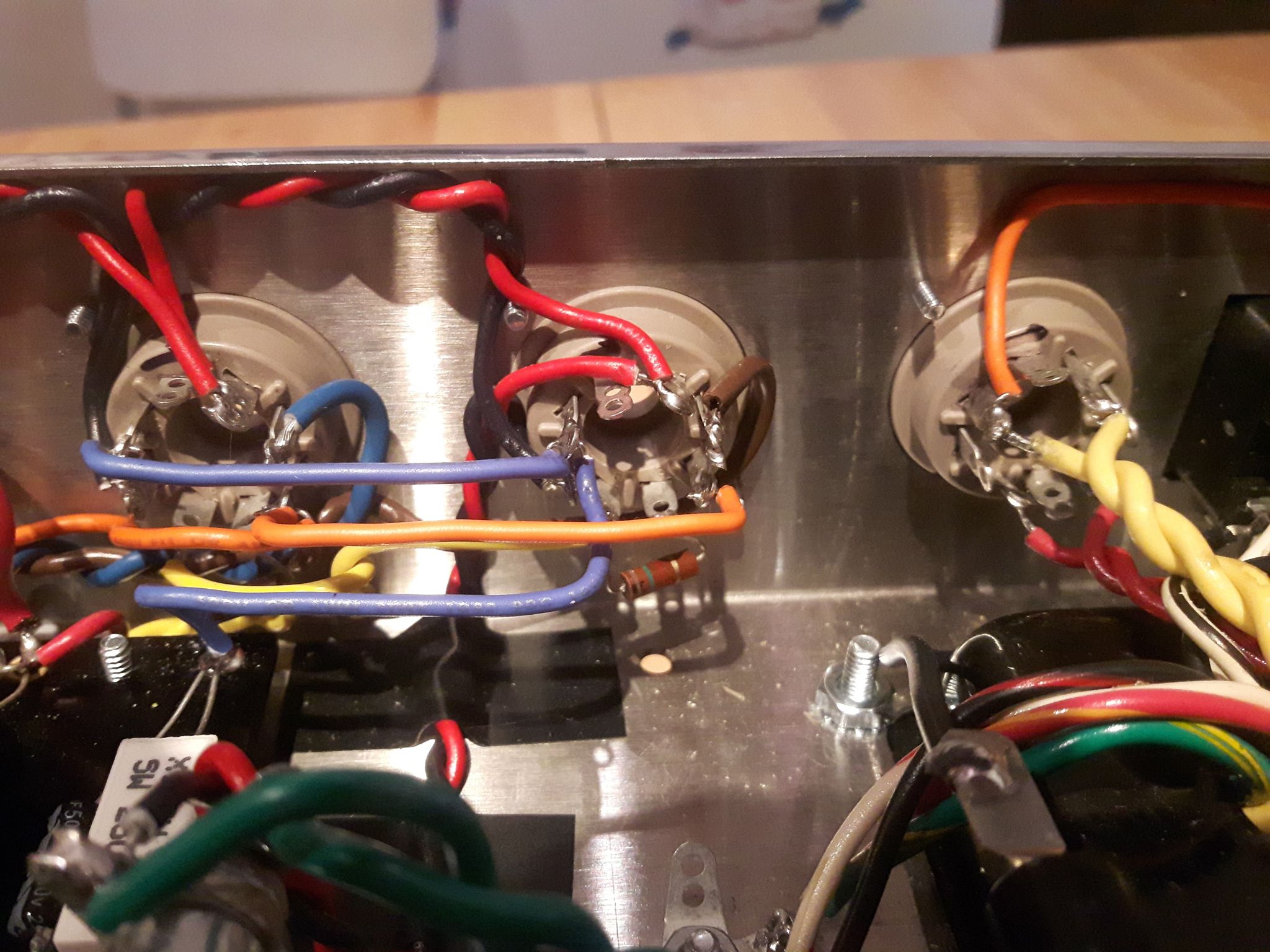

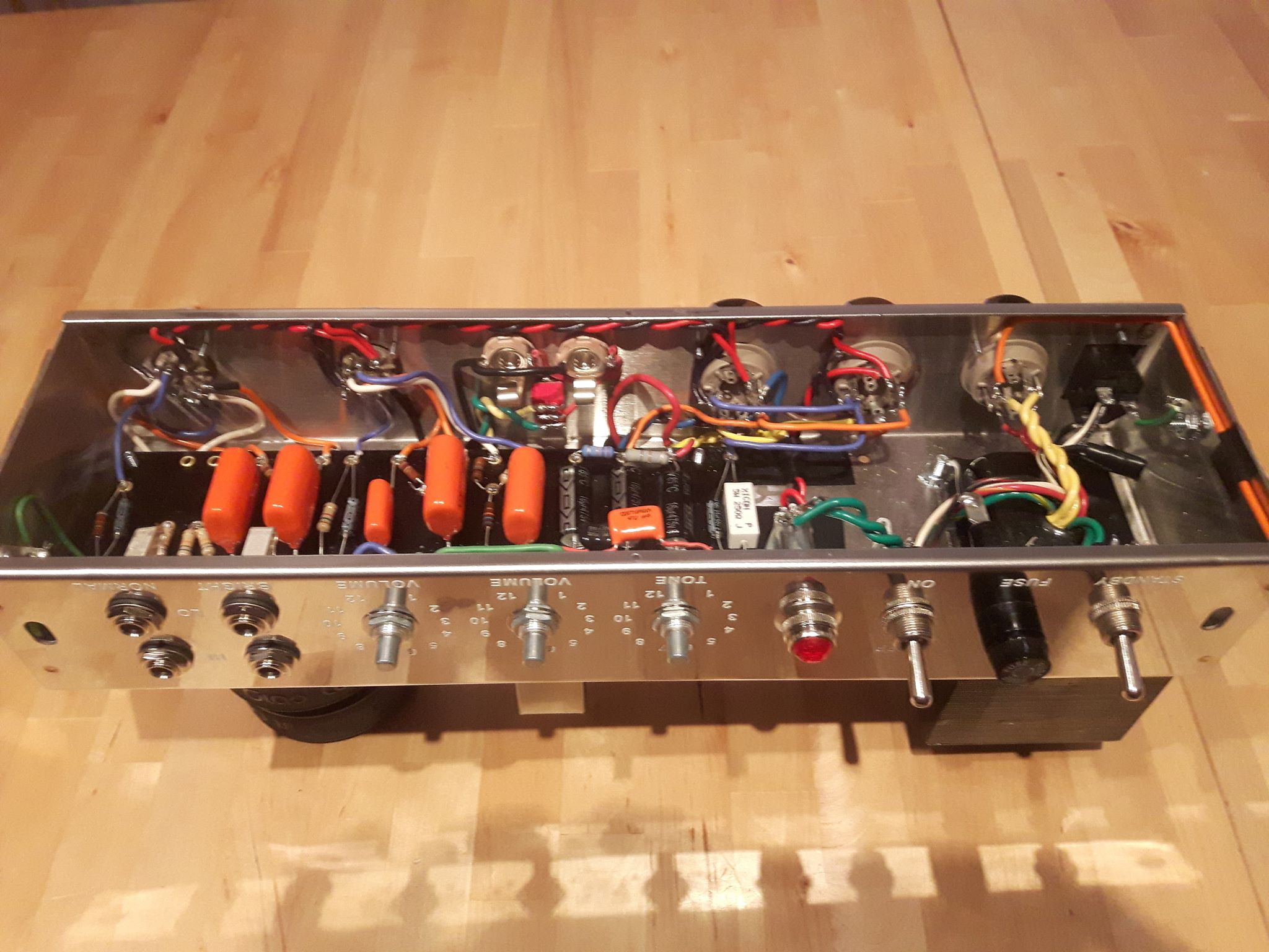

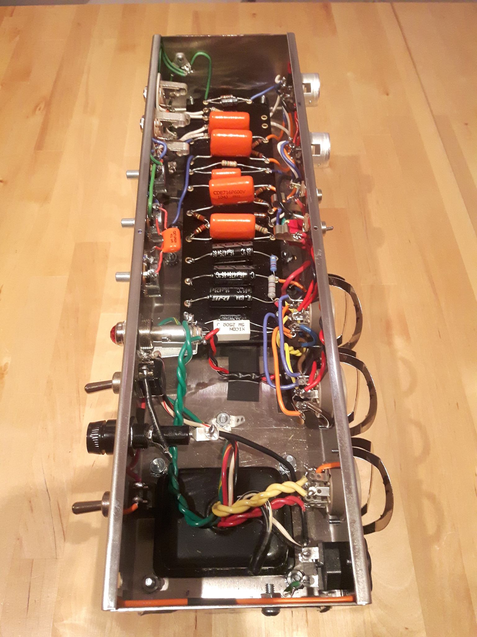

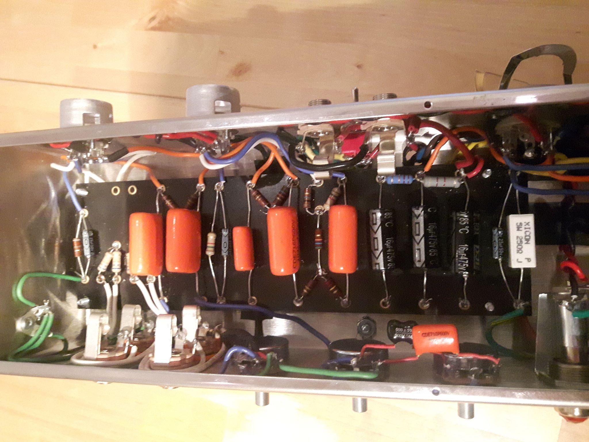

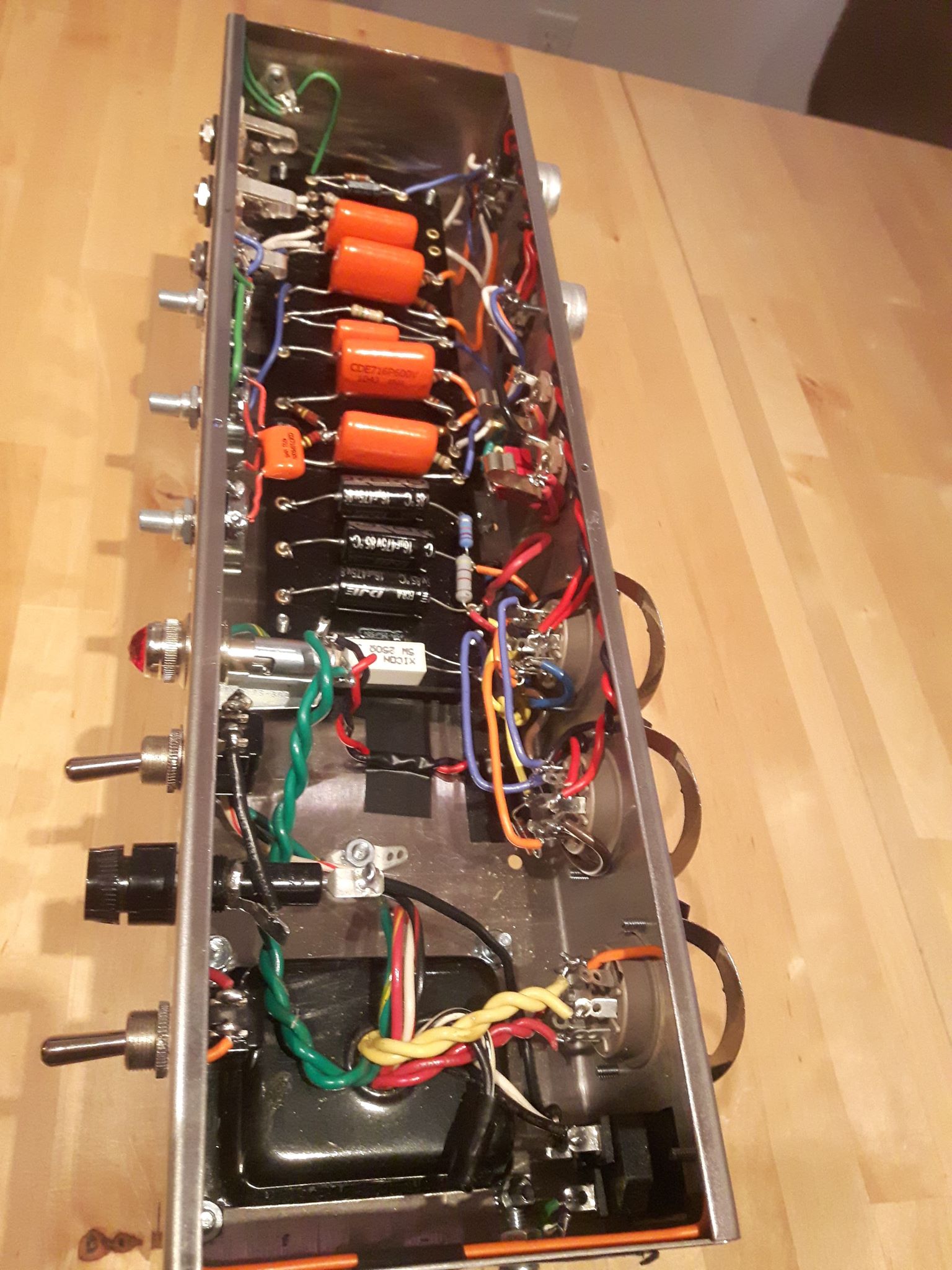

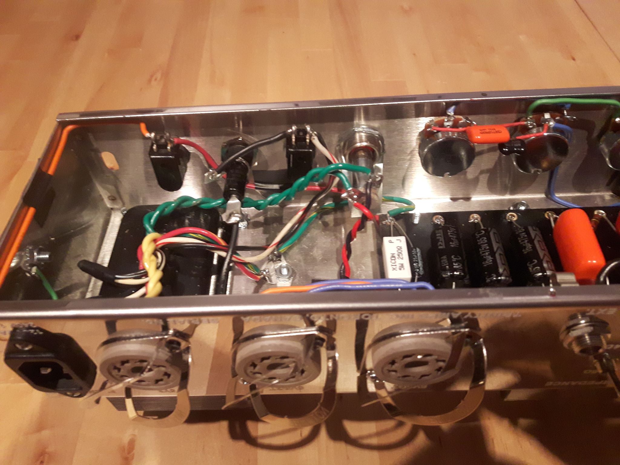

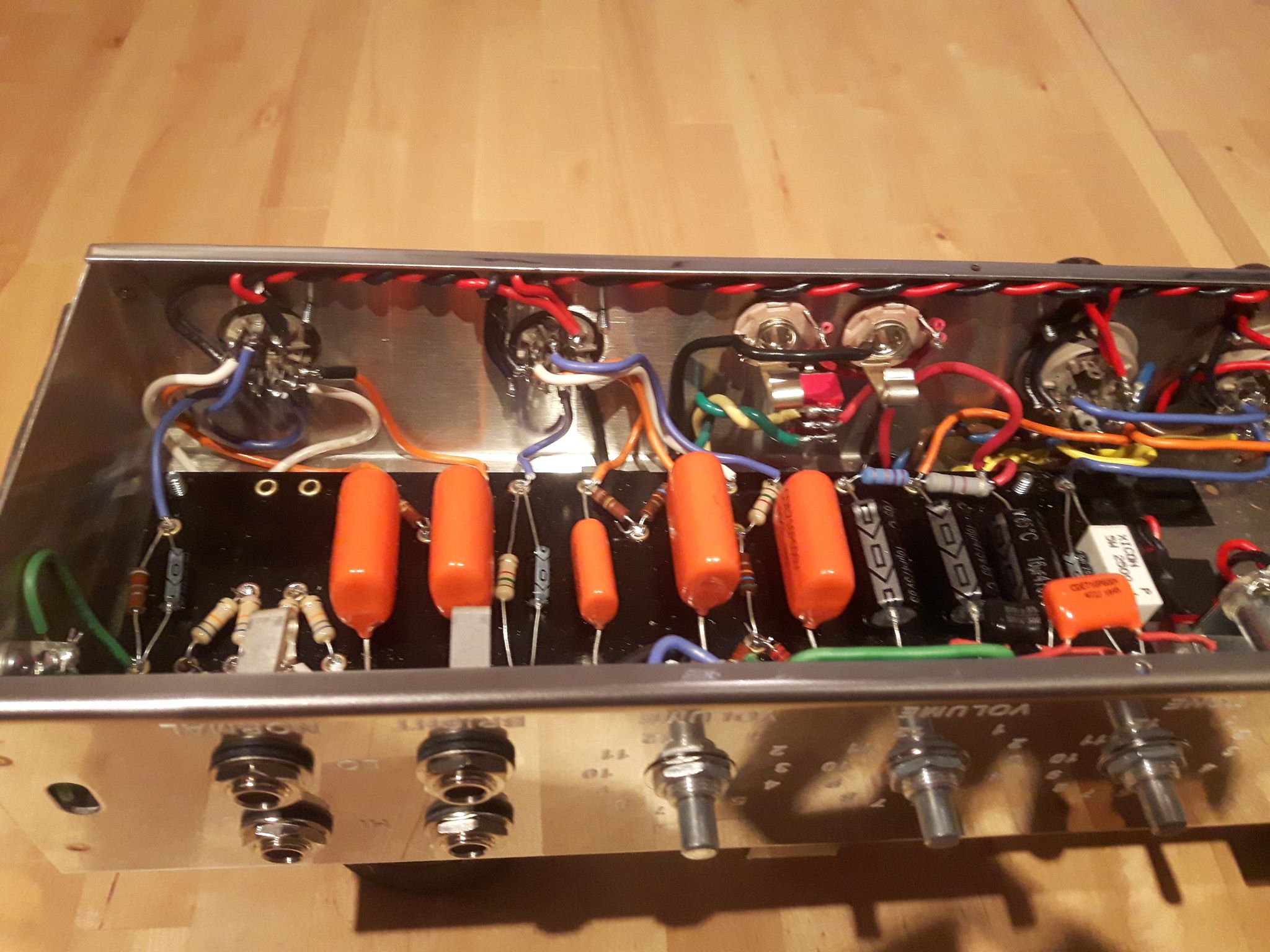

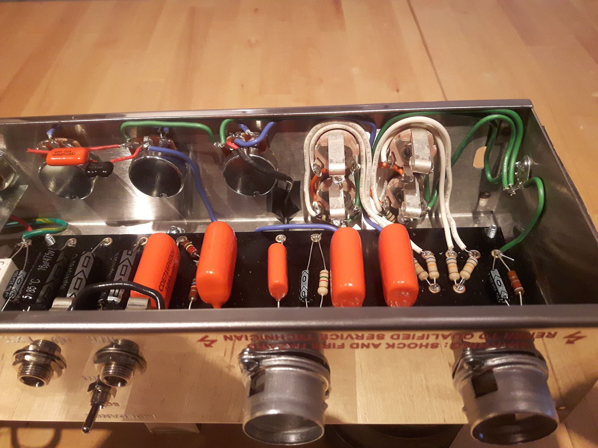

In the meantime here are some pictures of where I am now.

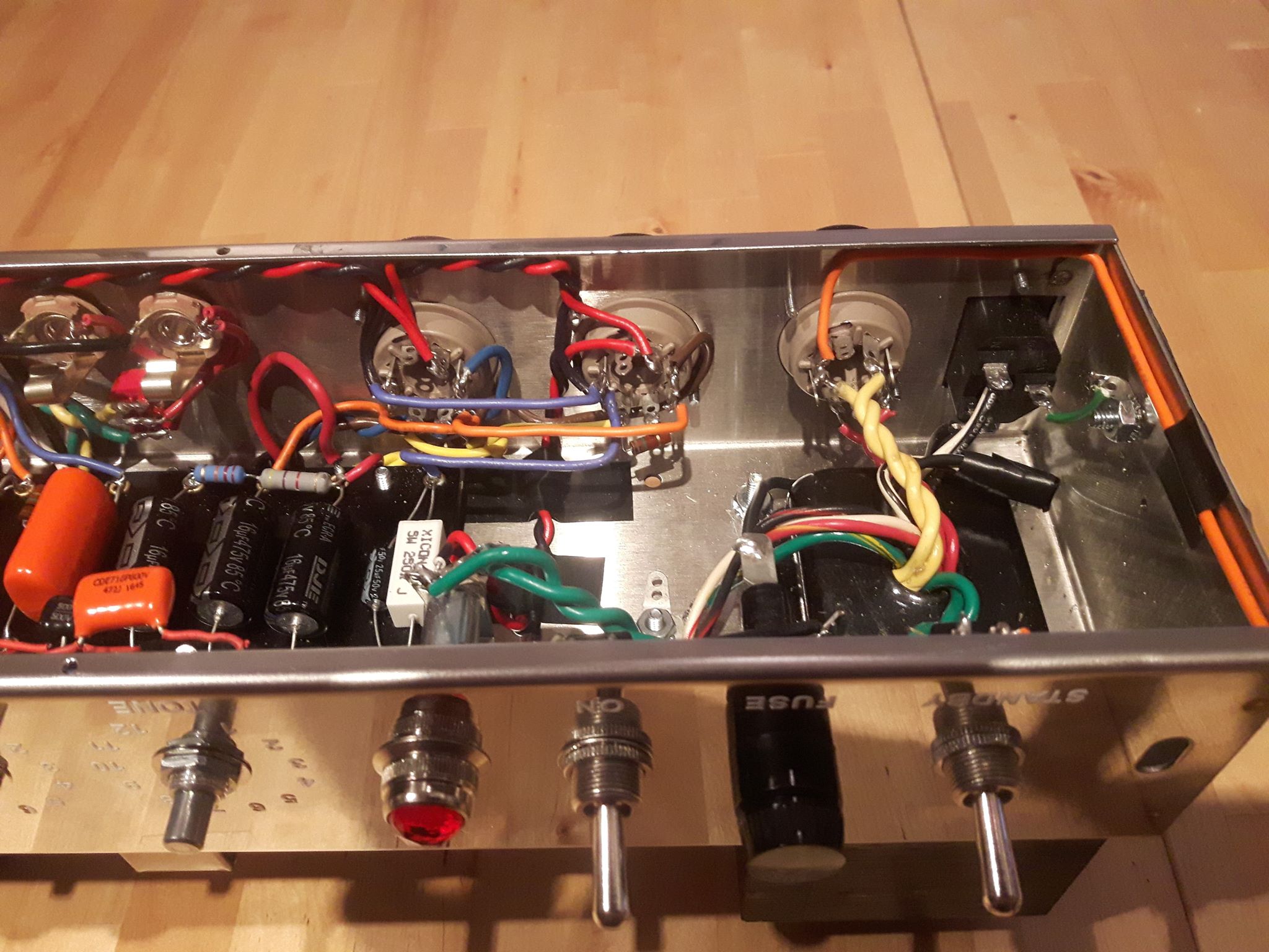

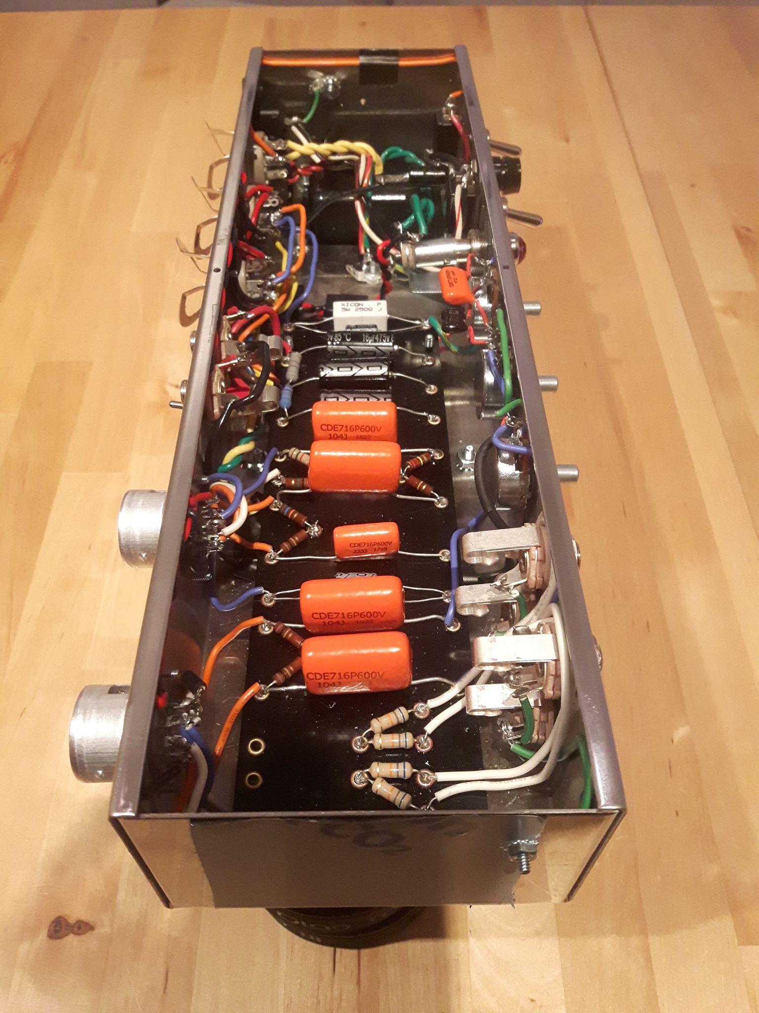

PostPosted: Sat May 23, 2020 2:46 am
Thanks for the pictures. The build looks good. Nice and neat. Looks like the amp should work well. The only thing I noticed that could be improved is using more solder on some of the eyelets on the board. I like to see them completely filled to make sure the connections are good.

I'll add more solder on few spots on the board as you say (I like/try to think in advance and I was concerned about futur service. I didn't want to put too much to get more easily removed in case pieces need to be changed :) But of course, main and first concern is to get a proper/durable connection ! I'll do it !

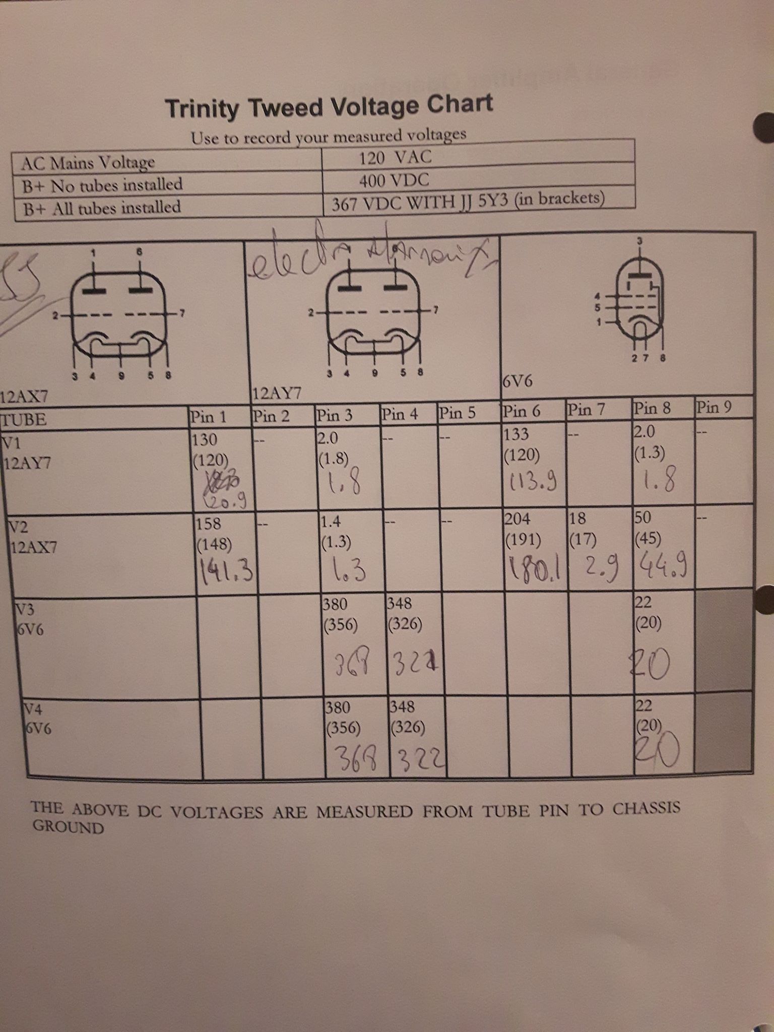

Hi, I've done the measurements. Here are the result :
As you can see,
- pin 6 of V1 and V2 // pin1 of V2 are smaller than expected
- Pin 8 of V1 is slighty above than expected
- pin 7 of V2 is way off with 2.9 instead of 17
About the sound, the amp plays but it doesn't sound as it should. The interaction between both volume control is weird (increasing hiss when turn the pots but it may not be the right term here..). But anyhow I'll write another time about that. Need to sleep now.
Any comment about the measures would be appreciated Thanks !

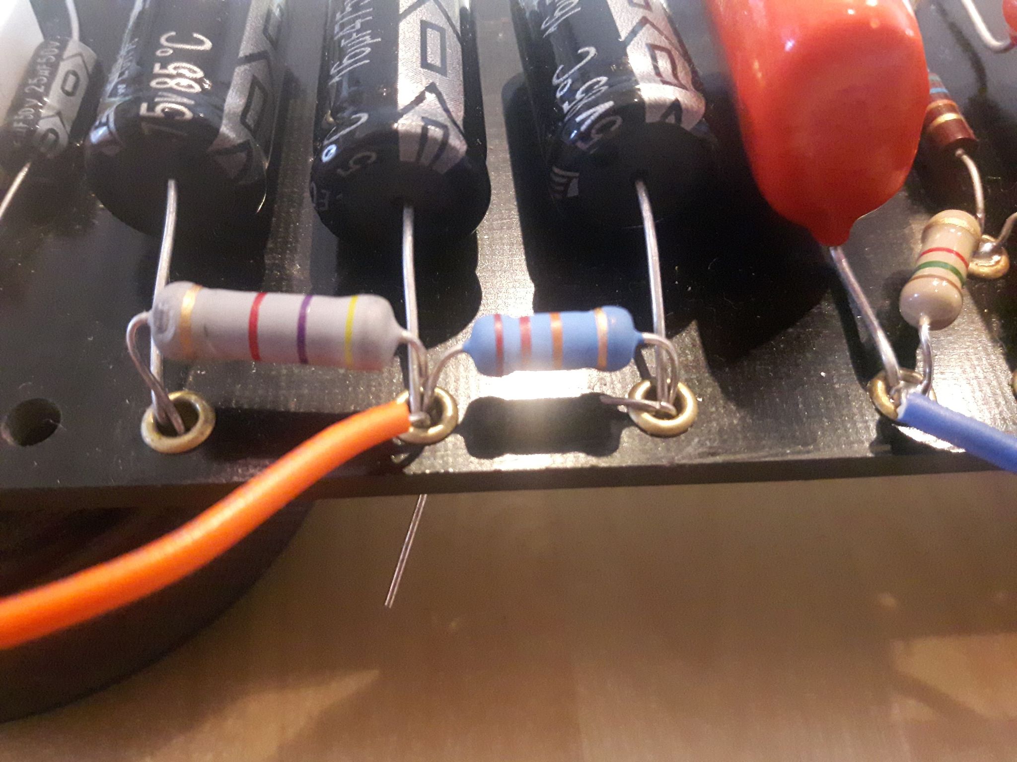

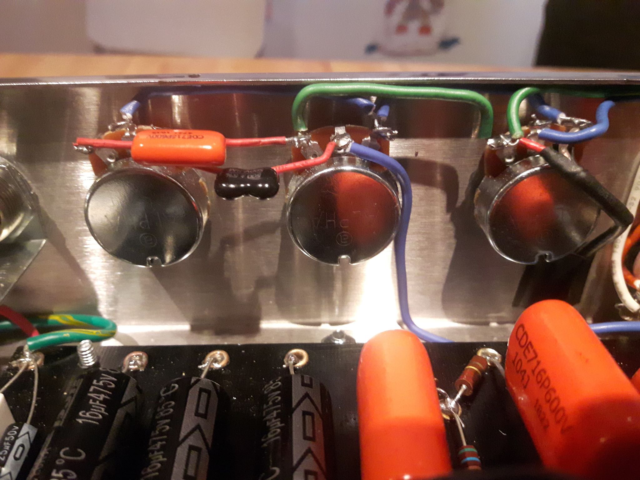

Also, I was wondering about the 22K resistor. I've seen it on every build it's a bigger one in size, like the 4K7 just besides. Mine is blue body and smaller, I guess it cannot cause any issue.. They are only two different kind, bothe metal film and doing the same job, right ? it's supposed to be 2W but I was only able to confirm the value of the resistor.

The volume controls do interact. That's normal on 5E3 amps, even the originals.
But if the sound isn't right, check all your connections, looking for bad solder joints. Also make sure all the parts and wires are in the right places. Looks like they are in the photos, but it wouldn't hurt to check again.
As I said earlier, the eyelets on the board should be full of solder to make sure the connections are good. It's easy to take a component out of an eyelet later for maintenance or modifications, even if the eyelet is full.
The 22K resistor looks OK. The one in my Tweed amp looks the same. Sometimes it's hard to tell if a resistor is 1-watt or 2-watt.

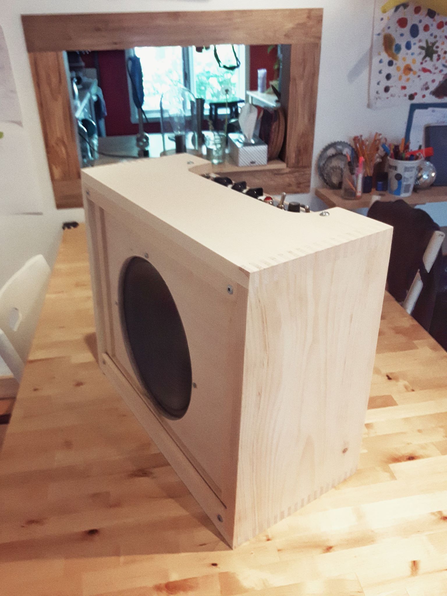

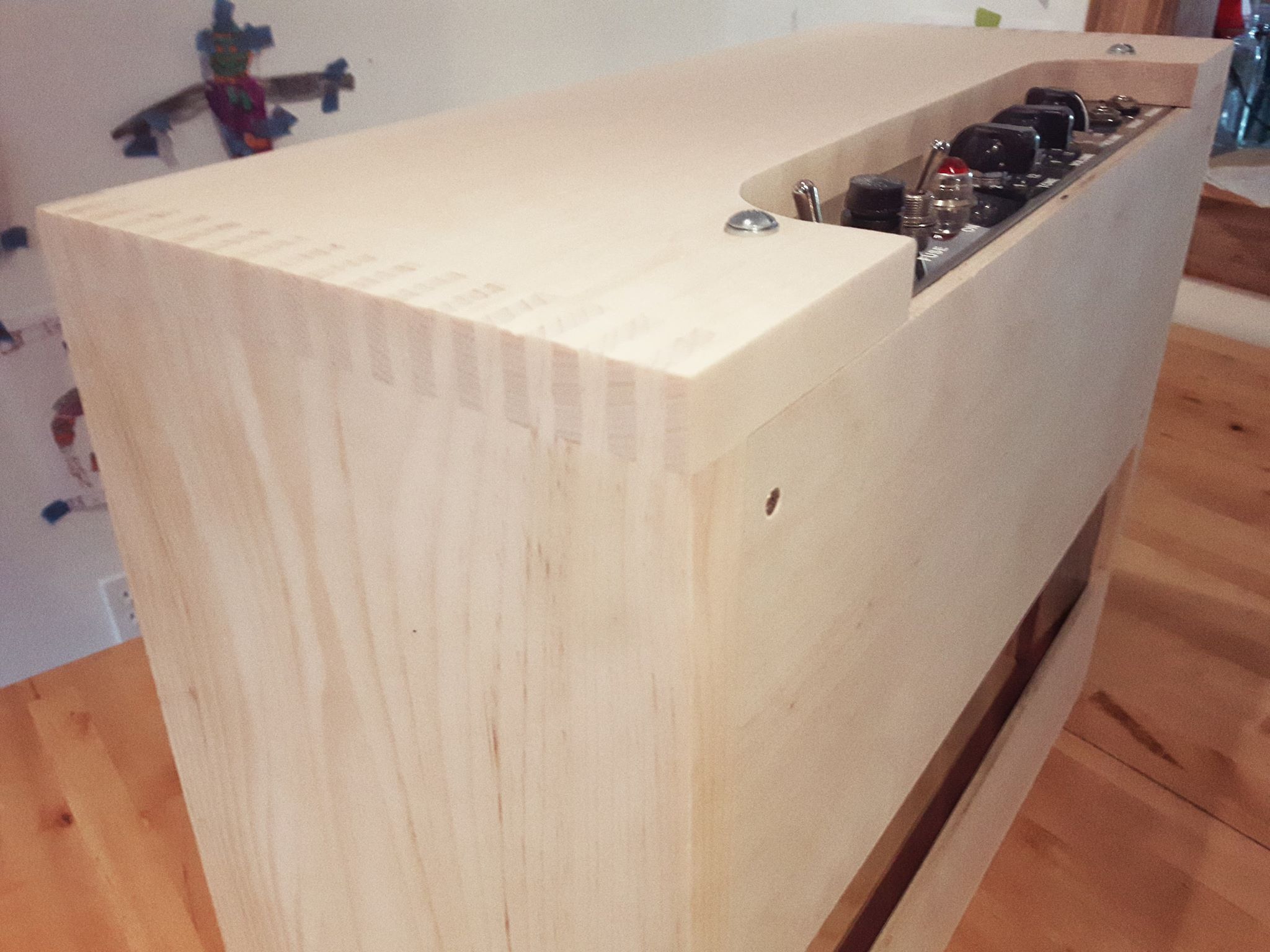

Hi Mitch, thanks for the answer. I took some time to work on the cabinet in the meantime. It's not finished but at least I've been able to play the amp in the cabinet. Not the final speaker (I've installed one of the two in my Bandmaster reverb, a C12N, 8 ohms). I have also read some stuff https://robrobinette.com/How_The_5E3_Deluxe_Works.htm and https://robrobinette.com/How_Amps_Work.htm among others. I'm far from being an expert now but at least few thing make more sense. I should have definitely read that before the build !
Installing the chassis in the cabinet helped I'd say (+ moved/played it in a room with much less electric devices). There's absolutely no hum. I do like the sound but the interaction is a still a little weird I'd say. I'll redo some stuff just to make sure. I'll make a short video later to explain but for example, I don't hear the -6db between the Hi and Lo from the normal channel. For me they are at the same level (on the bright, no pb, the -6db is clearly audible). Also, when plugged on the bright channel, when the volume of the normal channel is between 10 to 12 it decreases the volume (no change if I dial between 1 to 10 on an other hand..). But that's examples. It may be as it supposed to, I've never player on a Tweed before.. I don't know...
I'll install the VRM later for sure. I don't have access to the great gain/distortion since the amp is way too loud when these sounds are reached. For now the sound really hurts my hears (really) if above a certain volume (I've never exeprienced this with other amp and my vintage Bandmaster). I'll see what happend with the right speaker (certainly a W.eber).
So, here are some pictures of the amp/cabinet so far. I still need to order a grill cloth, an handle etc. (+ shape the two pieces of wood in the back).
I love wood in every aspect so I won't put the traditionnal tweed fabric on it. I'll just put few layers of (dark/brown) shellac as base coat. Maybe I'll french polish it as I do for the acoustics I build (even if it's absolutely not the best/suitable finish for a cabinet). Btw, that's the last Telecaster I've 100% built for a friend. The maple top is gorgeous !

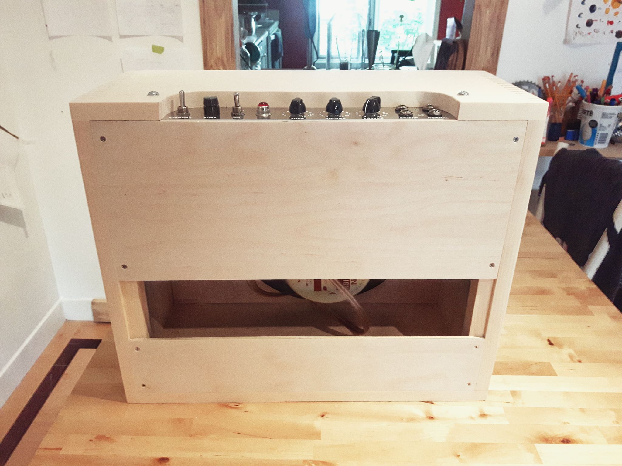

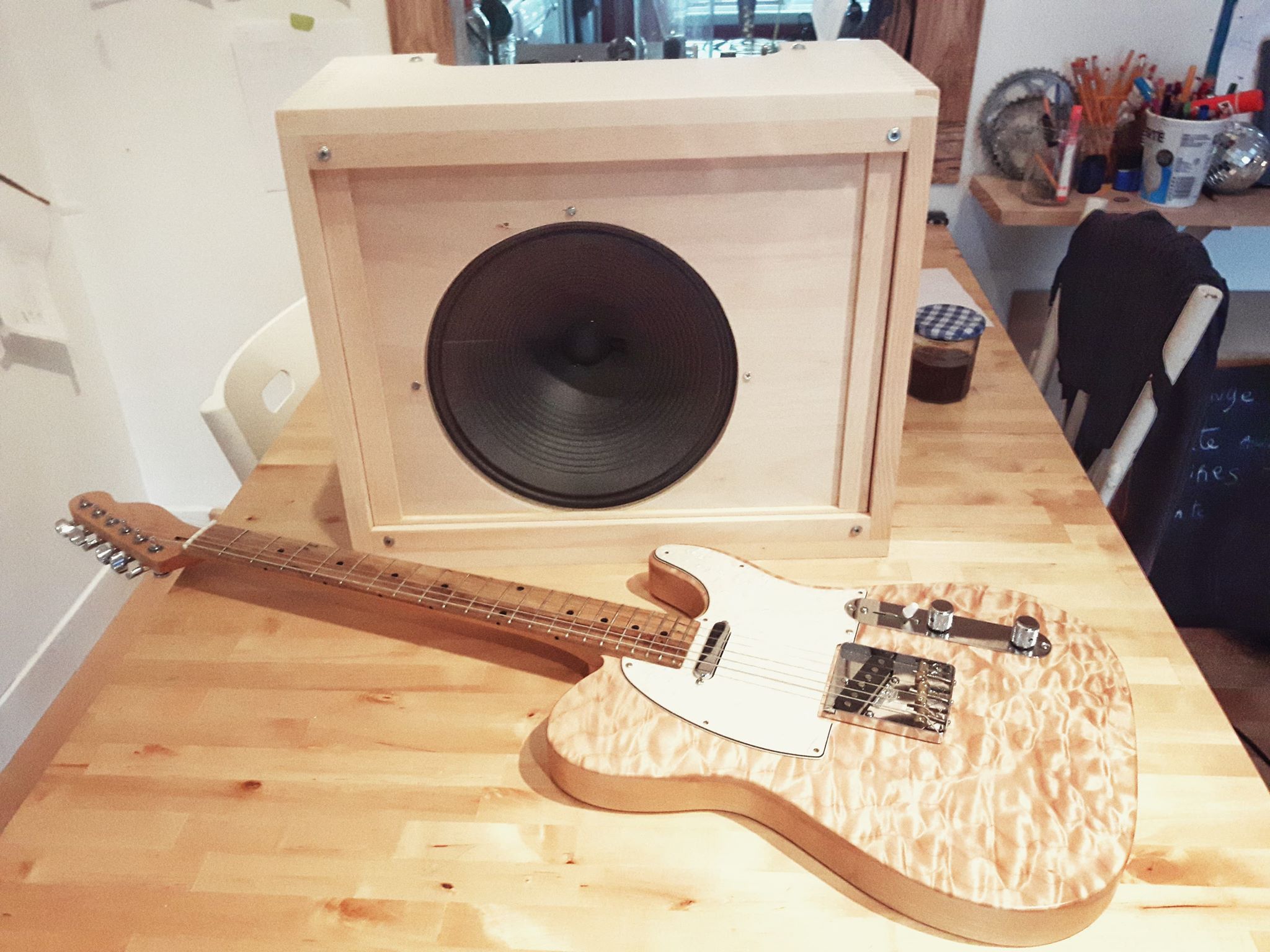

PostPosted: Sun May 31, 2020 7:56 pm
Cabinet looks great, are you planning to ease (round over) the corners? Also, are you going to put some cutouts in the top rear panel? Tubes need air. One of these days I'm planning on making a genuine slant front 5E3 combo cab, courtesy of Modulus Amps in UK. He has some nice downloads at the bottom of the page on his site (Imperial/metric and box/butt joint options in the plans). And the quilted maple on the Tele is gorgeous.

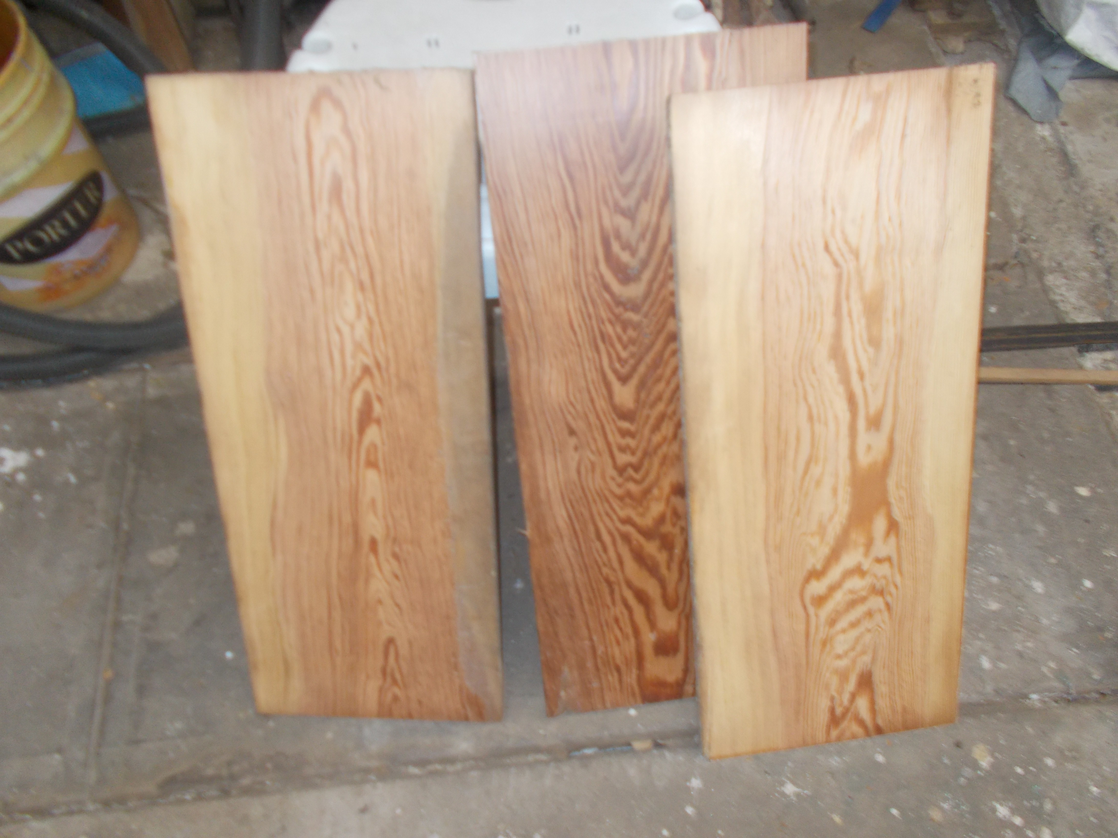

It looks like you appreciate good wood, found these in grandfathers garage, were shelves in white painted storage cabinet. Ran them though the planer and found what I think is long leaf Southern yellow pine. Can't use in a cabinet, though, it's really dense (read as HEAVY!) and someone would probably hurt themselves trying to lift it.
PostPosted: Sun May 31, 2020 8:22 pm
Posts: 24
Thanks! About "rounding" the corners, just a little. I'll definitely won't use the traditional/suggested radius. I'll round the edges at the same radius as the Telecaster I think. I want to keep it that way.
Yep, I wrote that in my comment before, the cabinet is not finished yet. I'll shape the rears panels soon for sure... :)
Modulus, yep, that's the plan I've used :) It may not quite well visible on the pics but it's slanted, 8.5 at the top and 9.5 at the bottom. If I remember well the fingerjoin were supposed to be 0.5 but I did them at 0.25 (they will last forever !)
Too bad if it's too dense/heavy for the yellow pine. Higher density would mean less vibrations and then decreases the low frequencies I suppose. Matter of taste.. What I like with pine is that it's so light ! Now when I see the solid pine shelves in my house, I see amp cabinet.. No choice, since I have all these raw materials at home I will have to do others builds in the future, it's too late now... ahah ! (I think I'll do a Blackvibe from Robinette and since I've been hesitating with a Tramp, maybe a Tramp. Low wattage for sure for the last one..)

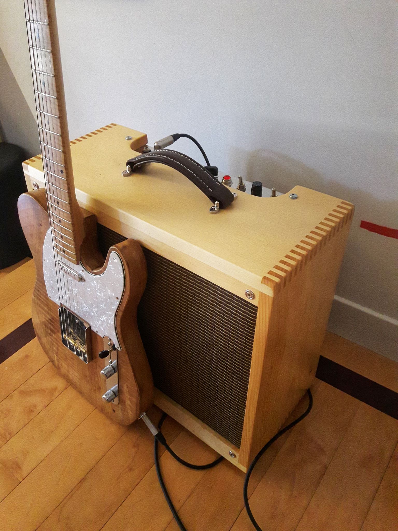

PostPosted: Sat Jun 06, 2020 2:02 pm
The cabinet is looking good. It should look great with slightly rounded corners and a french polished finish.
That's a beautiful Tele you made too!
Yes, Rob Robinette has lots of great information on his websites. You can learn a lot there.

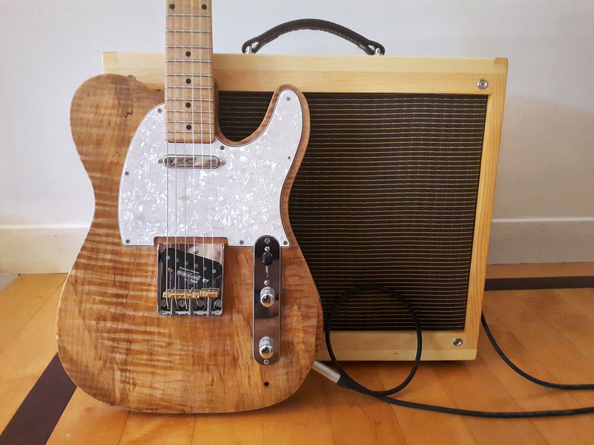

Hi ! Here's my Tweed so far (pictures below // not french polished yet) with my homemade Telecaster (this one is mine). I still haven't received the speaker from W.eber (I don't think it has even been shipped yet). So I expect to hear some tonal differences as soon as it will be installed...
I really like how the amp react. It's so sensitive acccording to the attack (fingerstyle only here). I love it. Very organic ! I've made some tubes rolling with differents combinaison of tubes I have at home 12AU7/12AT7/12AX7 and it's very enjoyable/interesting to switch between them (I made the test but wasn't sure if it was safe for the amp so didn't tried it for a long time.. Are 12AX7 on both V1 and V2 OK if I want to play sometimes with both installed ?)
I'll then tweak the tone a little to experiment. I understand it's ineherent to the 5E3 but I find the sound procuded is overall too "dark" or "muddy" (I can't find the right word) to my taste/hears and I will want to get ride of few frequencies. Some tone/volume configuration are just not usable and it limits the use I think.
So when I'll got the new speaker I plan to :
- change few resistors to metal film one (got some unwanted hiss on few volume/tone configuration which limit the recording usability). Btw are 1/2 watts enough as remplacement for all resistors when the wattage is not specified ?
- replace first two coupling caps to .022uF (+maybe hte 2 others changes listed here download/file.php?id=695&mode=view // Thread : viewtopic.php?f=11&t=2841)
- install a simple 10% power switch or the VRM (not sure yet, I'm not sure if the PCB connexion are still ok with the stupid installation mistake I made... arffff)
Even if it's a long learning curve and there are millions of things I don't understand, it's very enjoyable to make up the sound we play/use. I have the feeling it makes us "better" musicians...
I'll write a followup when the W.eber speaker will be installed.. I'll also make/post videos... :)
