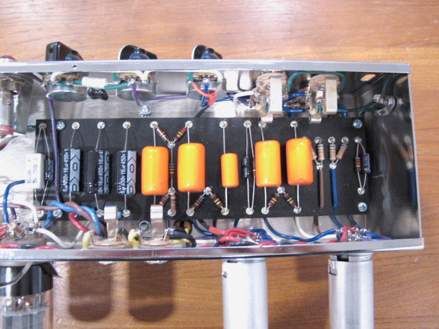

I've assembled the eyelet board in the meantime (not soldered yet). I have quick questions about it and the resitors. But I'll post about them later... :)

Ideally, those red and yellow wires should be twisted together, but it's not mandatory. Just being very close together is OK, too. Yours isn't bad. You could use some cable ties to keep them together if you want.
The layout drawing is the key to the assembly. Just follow it and you should be good. There are lots of posts here about neat and successful Tweed builds you can look at for reference, too.
Here are some pictures of the Tweed I built.

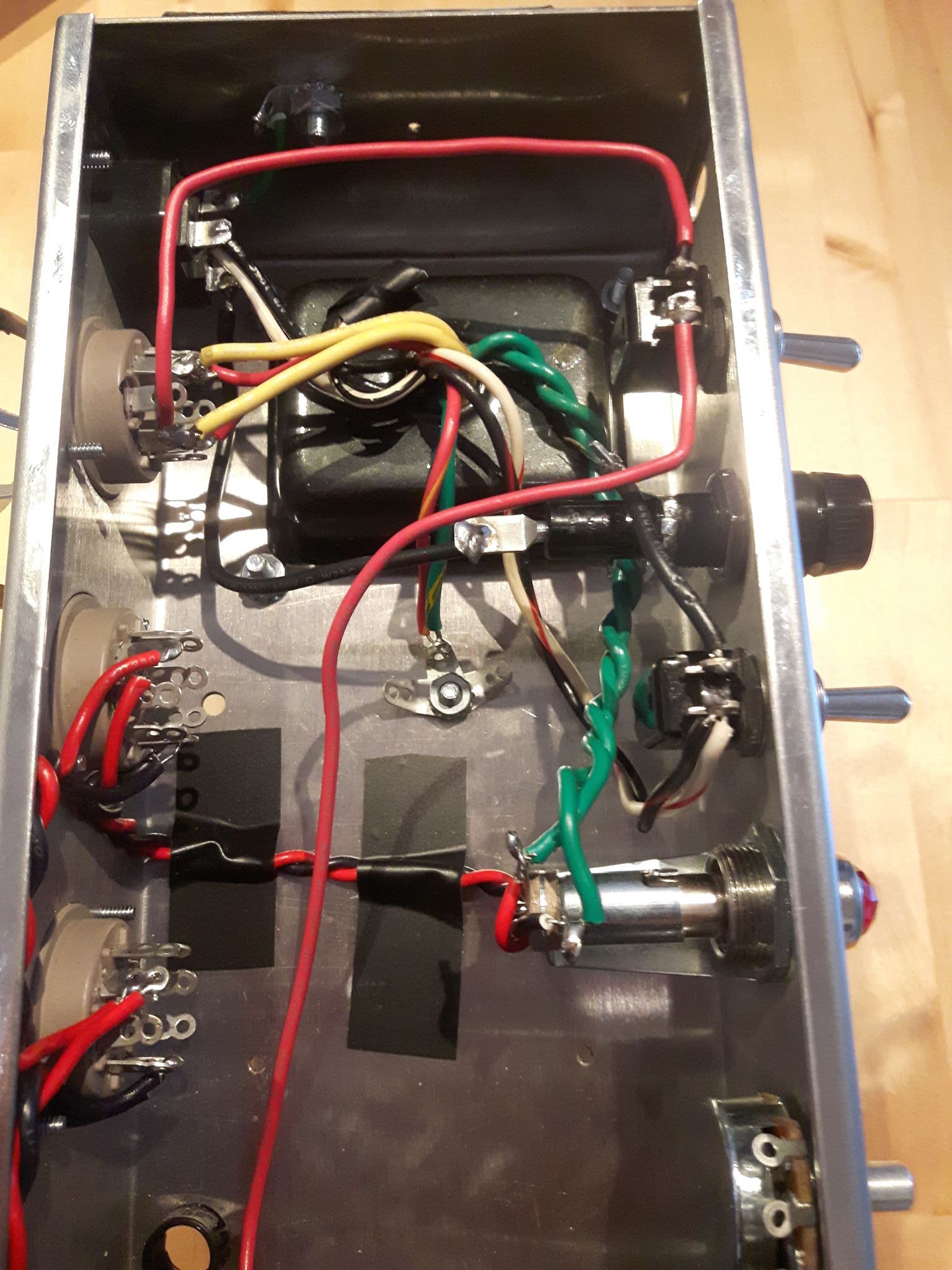

Hi all ! Little followup and a batch of questions... I saw that a resitor was missing so I had to wait to get it to continue. In the meantime I've started the build of the cabinet (cf. last pictures below). So as I said I have few questions. I've tried to find answers on my own but still I'd need some explaination. Hopefully it will be ok for you guys. I realize I have many... :nervous:

- Yellow wires (twisted from the board) : (cf. pciture below..) Do I use the big heat shrink for this wires ? I may have missed the info but I don't see the use of it anywhere in the documentation. The 2 others (the small and medium ones are for the co-axial cable, aren't they ?)

PostPosted: Thu May 14, 2020 11:37 pm
1) Don't know for sure on the resistors
2) Signal wires are the co-ax cable (from V2 to Normal Volume)
3) You can, but you don't have to use the heat shrink on the yellow wires. It does help keep them twisted until you solder them on the pins.
4) Optional cathodyne resistor: Not required unless you decide to. If you do, solder one lead to V2, pin7 and the other to yellow wire. See Trouble Shooting/Tone Tweaking section of Build Guide.
5) Only one end of the shield on the co-ax is grounded . On the layout it is indicated by a thin gray line on the Normal Volume control (along with two other ground wires). Be careful soldering the shield and conductor (signal) wires. You can melt the insulation between the shield and conductor and ground out the signal. There's a photo tutorial somewhere on how to prepare the co-ax, will post when I find it.
6) If you are installing a VRM, connect yellow wires and one end of the capacitor to eyelet 1 and the other end of capacitor to eyelet 2 (x2) and leave out the dotted section. If not installing VRM, leave out caps and wire as shown with the dotted lines.
7) Yes that's where it goes. Don't forget the to put the gray sil-pad between MOSFET and chassis.
