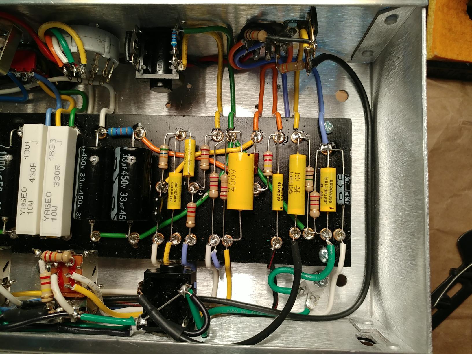

Now that I have a solder I like, I got started on the eyelet board. I decided to wire all the jumpers on the front face of the board, rather than the back. I don't want to wind up pulling the board back out of the chassis if I make a wiring error, or if I want to modify the circuit in some way. Putting the infrastructure wiring on the front, where I can get to it, seemed like cheap insurance.
File comment: Starting on the eyelet board
If I were doing this again, I'd consider running the jumpers a little more neatly. I'm not crazy about how they look.
The photo above also shows a little clip-on heatsink. The tip temperature I'm using is about 100F hotter than I would normally use for tin-lead solder. Also, the eyelet joints take quite a bit of dwell time to get up to temperature. This makes me worry about how much heat gets conducted into the components, especially ones with shorter leads, so I used a heat sink on the leads of capacitors and diodes whenever I could fit it.

I used 10 Watt power resistors for the new bias circuit (vs. the stock 5 Watt resistors). I don't think this was strictly necessary. Even allowing for the nominal 29V cathode voltage of V2 to be a little high (say, 33V) and the 330 Ohm resistor to be 10% low (297 Ohms), the power dissipated by the resistor is still under 4 Watts in 6L6 mode. OTOH, I don't want the neighboring electrolytic caps to get too hot, and the larger size of the 10W resistors spreads the heat dissipation out, so it seemed like a good call.
File comment: Installing the updated bias resistors
Here's a crudely edited layout picture showing how I'm wiring the mod.

Here's a picture of the eyelet board all wired up and soldered, except for the eyelets that are waiting for the MOSFET pins, and the power/ground eyelets that are waiting for wires from the chassis.
File comment: Ready to install in the chassis
In retrospect, I think it would have been cooler to organize all the flying leads by making a fixture like the one in post #23 of this TDPRI thread by @BobSmith, but it didn't occur to me until afterward: https://www.tdpri.com/threads/lunchbox- ... 175/page-2

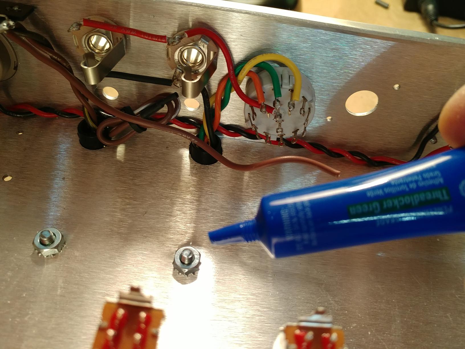

Before installing the board, I got worried about the transformer mounting screws and nuts loosening up. I don't want to later have to deal with tightening nuts that are hidden behind the eyelet board. I had some "green" threadlocker that's supposed to wick into the threads of already-assembled fasteners, so I put a drop on each of the nuts. Next time I'll put blue threadlocker on before assembly.
File comment: Adding threadlocker after assembly

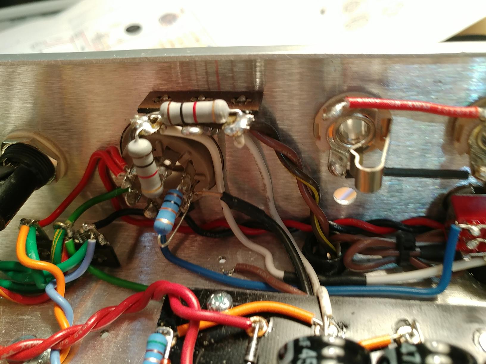

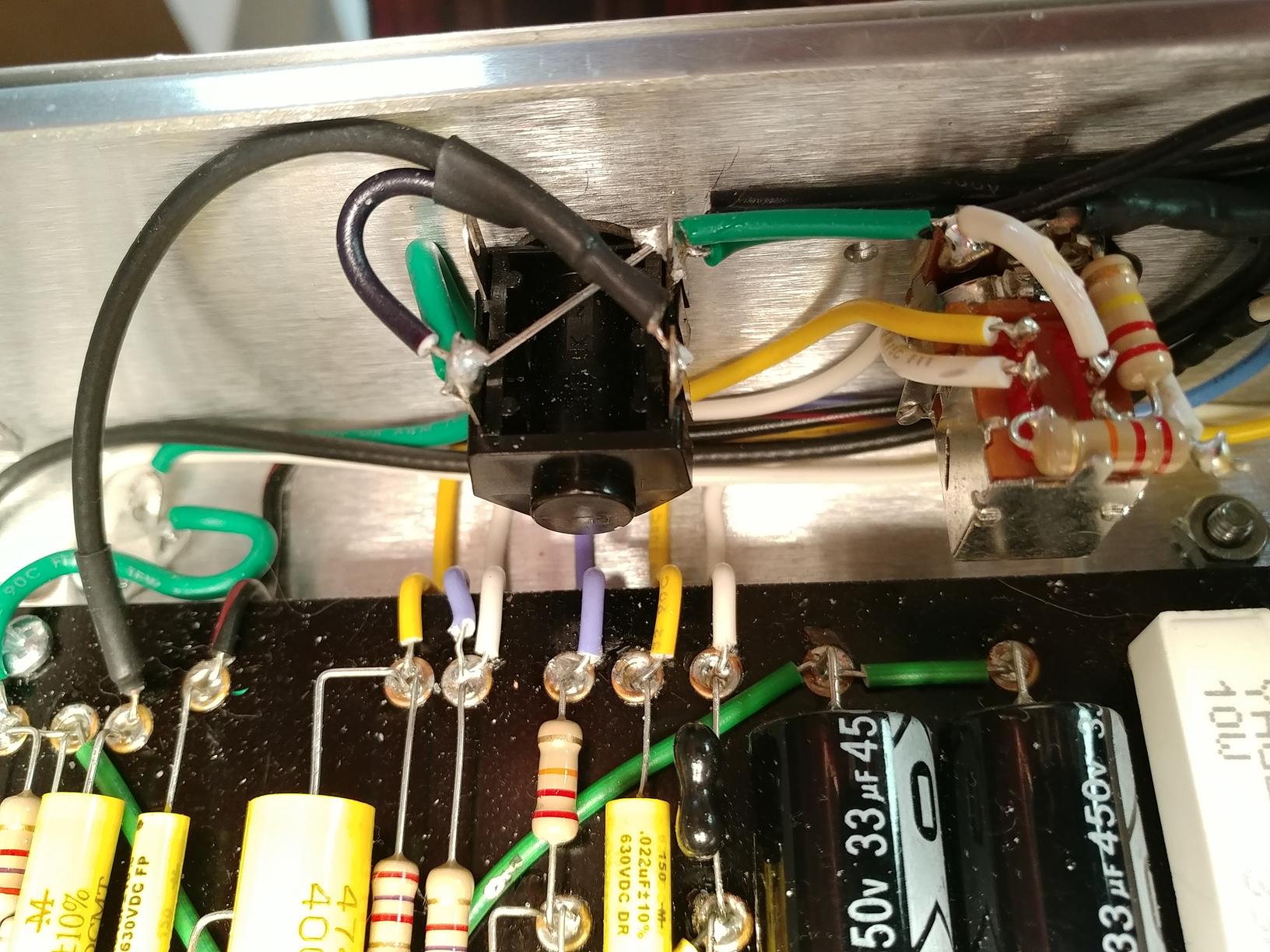

Next I wired up the remaining connections inside the chassis.
There are a few connections that run from one side of the chassis to the other, such as the negative feedback line from S5 to R18, and the line from the wiper of the Volume pot to R14 on the grid of V2. Instead of running those directly across the chassis opening, I routed them under the board because I think that looks neater. For the line from the volume pot I used shielded wire to make up for the longer (and likely noiser) wire routing. The Builder's Guide mentions using shielded wire for this on pages 48 & 49.
I decided to omit the high-voltage impedance selector switch on the primary of the output transformer. It sounds like this is a common source of problems, and I think I can get the same effect by printing a different label for the low-voltage impedance selector switch on the secondary. More on this later.
Here's a picture of the completed chassis build.

I used a 470k resistor for the PAB circuit because that's what I had handy. I'll see how it sounds, then go up or down if necessary.
Here are some more or less blurry detail shots in case they're useful to anyone.

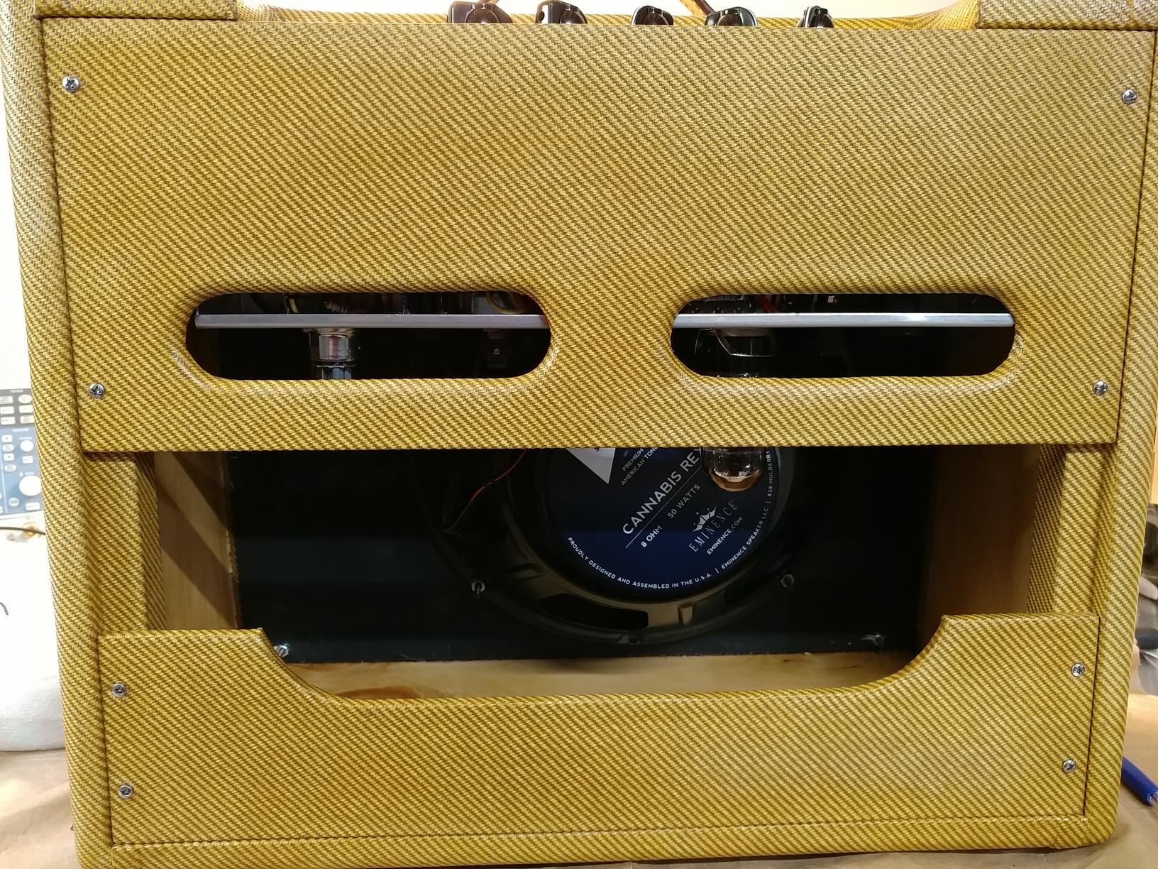

OK, one last post this morning to catch up with the weekend work.
I tried installing in the cabinet last night, and immediately ran into a clearance problem. The Jensen Blackbird is a big speaker, and there's not enough clearance for the the 6V6 tube.
File comment: Clearance problem
Removing the magnet cover from the speaker _almost_solves the problem, but there's still not enough space for the power tube.
I tried turning the baffle upside down, which moves the speaker to the left in the picture above and gets it clear of the power tube. Unfortunately, this also raises the speaker in the cabinet, so it interferes with the chassis.
File comment: Baffle upside down
I see two possible solutions: I could install a different speaker, or I could try reversing the speaker baffle (removing the grill cloth, recovering the back side of the baffle, and then reinstalling it with the back side facing out-- this would move the speaker horizontally without raising it in the cabinet). I'm open to other ideas if anyone has any.
PostPosted: Mon Jan 06, 2020 5:55 pm
I vote solution #2; because that's a very nice (and expensive speaker) (P12N?) which should sound great with the Tramp and the cabinet you built is very nice and it's fairly easy (and cheaper than another speaker) to relocate and re-cover the baffle with grille cloth.
PostPosted: Mon Jan 06, 2020 6:53 pm
Yes, reverse the baffle if that gives you the clearance you need. Maybe even make a new baffle if that's what it takes to get the speaker in the place you want it.
Nice job on the amp! Glad it's working well and thanks for posting all the detailed pictures.

Thanks Hankules and Mitch for weighing in. Hankules you have a good eye... it's a Blackbird, which I believe is a close cousin of the P12N. And giving credit where it's due, it's a Mojotone cabinet... I just laquered it. :)
I decided to make a new baffle, which means a delay waiting for grill cloth. In the meantime I've installed an Eminence Cannabis Rex that I have from the days when I was making friends with my Blues Jr. The Eminence speaker fits fine. Here's a photo showing the speaker-to-tube clearance, as well as labeling changes on the chassis.
File comment: Temporarily installing a smaller speaker...
The bias labels reflect the 3-way bias mod I built into the amp (described in my Jan 1 post). Once I get a few more tubes I'll check biases to make sure the labels make sense.
The impedance label reflects the decision not to include the "load" switch. I left it out because of reports on this forum that it tends to arc when playing flat out. As far as I understand, it's the ratio of turns in the primary and secondary that matters, so instead of switching the tube to the 2.5k primary winding, it should be OK to instead switch (for example) an 8 Ohm speaker to the 16 Ohm secondary tap. Similarly, you could get a 2.5k primary impedance by putting a 4 Ohm speaker on the 8 Ohm secondary tap. That sounds confusing and easy to forget, so I printed up a label to make it simple.
There are a couple of other minor nits with the fit between the Mojotone cabinet and the tramp chassis. For example, the vent slots on the rear cover don't match up well.
File comment: Vent slots...
[Edit: I suppose this isn't so minor if there are kids or pets around. I guess I'll make a new rear cover, too]
Overall, though I'm very happy with the appearance of the amp.
