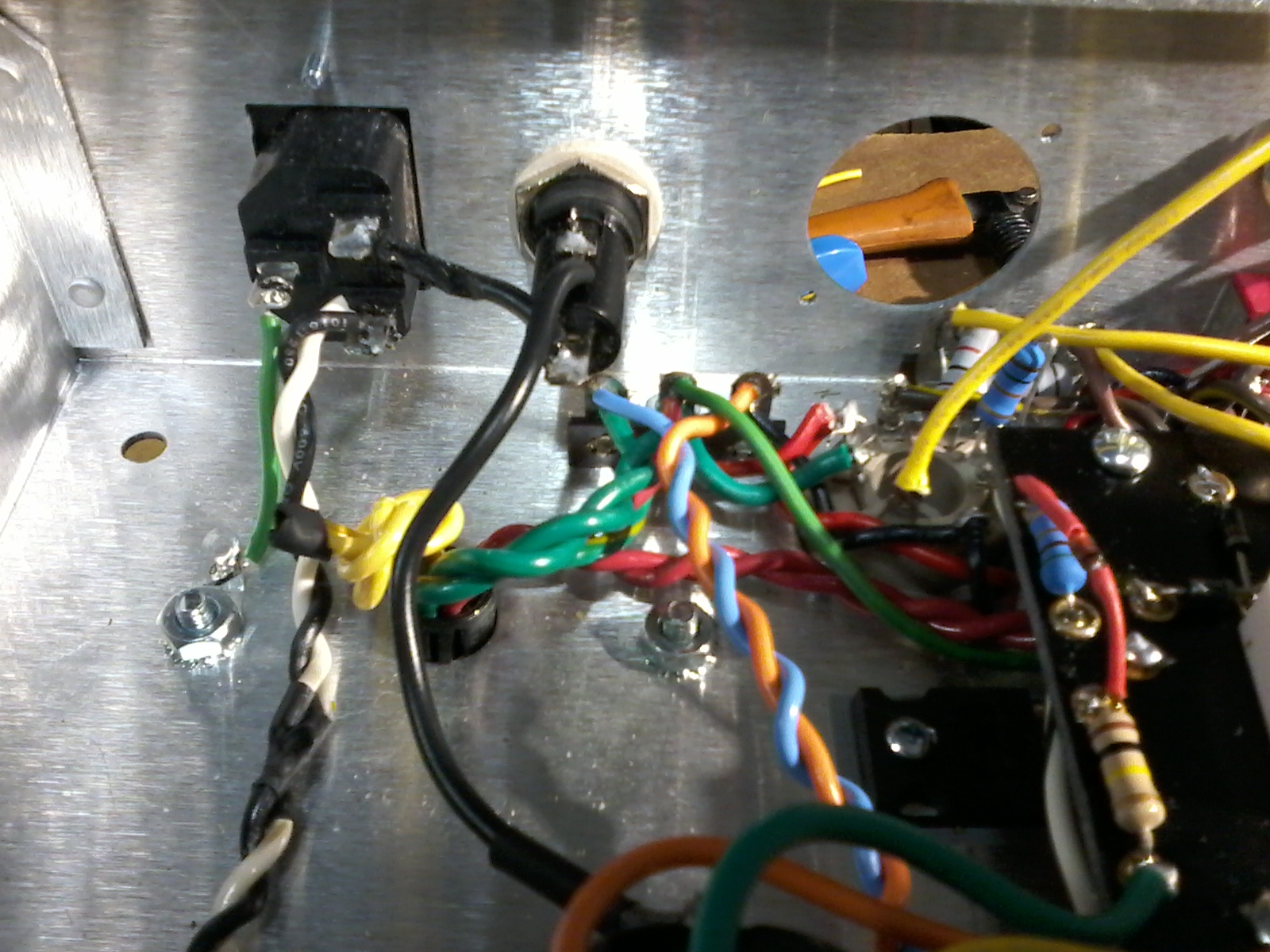

I put together a Tramp head. When I switched it on to test voltage with no tubes the LED lit up for a couple seconds then died. Fuse blown. I took voltage readings of the caps after this and they all report zero.
One oddity is that I broke the 6l6/6v6 toggle by over tightening the bolt - the whole thing just fell apart. I wired it direct to 6v6, or so I think. Other than that everything is by the book.
Does anyone have any clues on where to start to debug this?

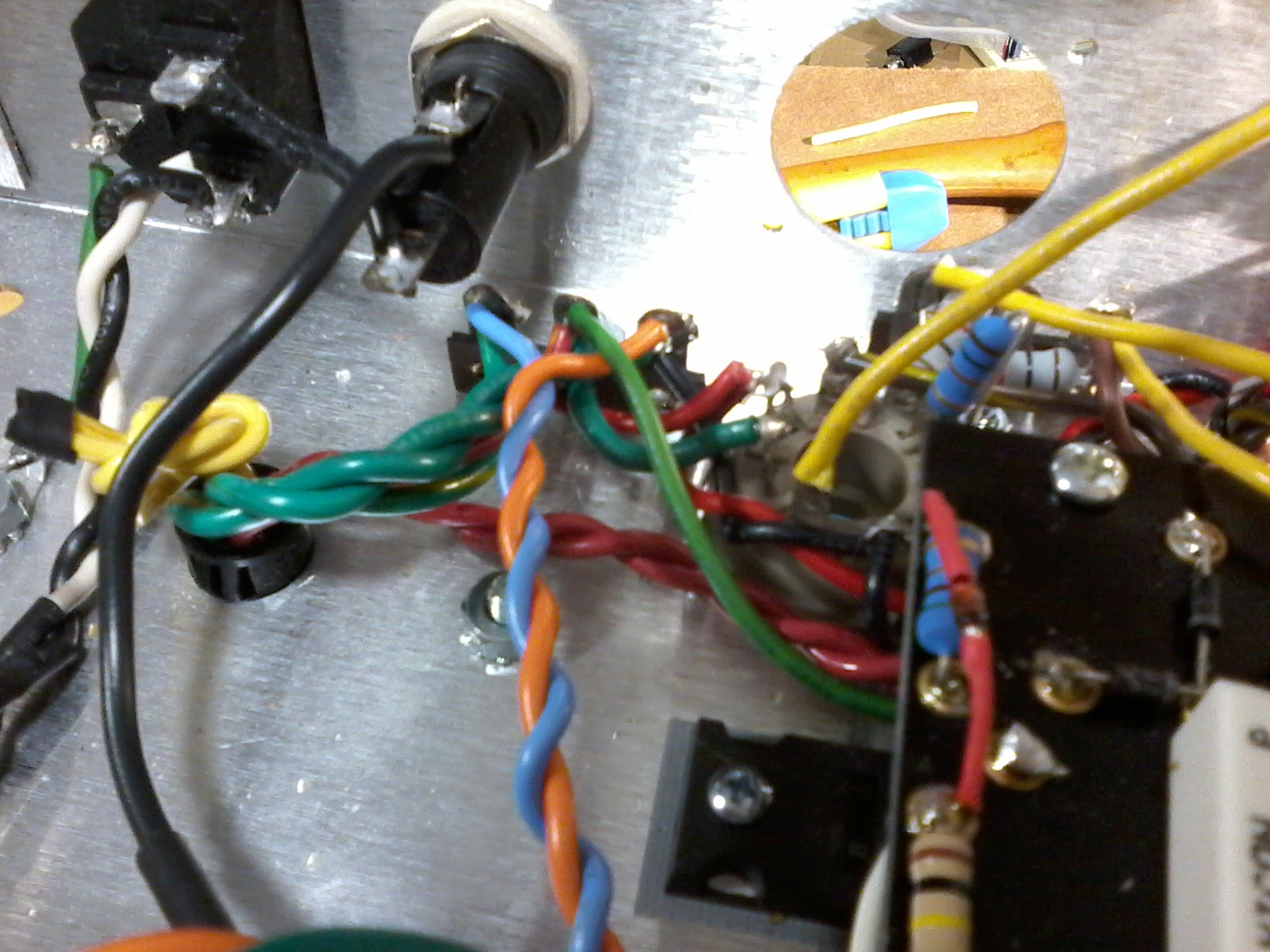

More pics at different angles on the power xfmr end, Difficult to see where your wires begin and end. Also, I have read of fuse holder being shorted w/ excessive heat on terminals. Might want to UNPLUG and do continuity checks. Note also that that selector switch seems to be wired in an different manner than I've seen before, usually terminals 1,2, and 3. That's all I can suggest for now.

The output ohm selector is wired to the diagram - it's just in there upside down. yellow to 1 , green to 2, orange to 3 and A to output jack tip.
I'll check the fuse holder first thing, once I pick up some fuses. One thing - on the amp it says 120v 2a / 240v 1a. Does this mean my 120 volt should have a 2 amp fuse? It came with a 1 amp 250 volt fuse.
I've been thinking about it and I'm guessing it's a mechanical short under the eyelet board - stray wire clip or solder or something, but I think it's a good idea to ask here for clues before I start desoldering to look under there.
Here's a few more pictures. (excuse my crap camera)
Some of the early solders look dull. I was using lead free solder at first, but I didn't like working with it and switched to the good old poison stuff.
