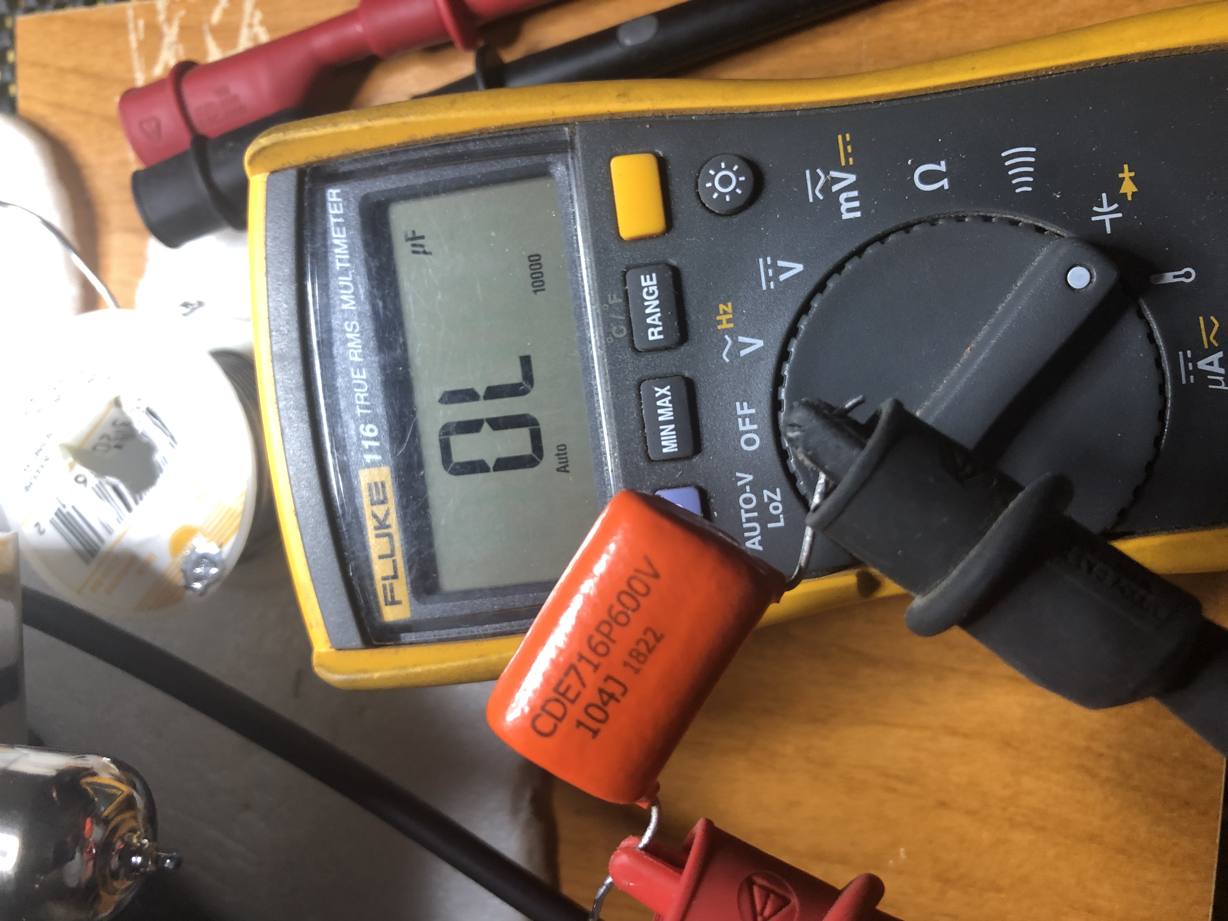

I checked and redo the connections to make sure a good solid connections and in the process I also check the values of caps and resistors and what I found 2 dead orange caps .1uf which are in V1 and V2 circuit reads OL on my meter and also compare to the other 2 which have the right value. Was that wrong resistor value ( supposed to be 4k7) cause this 2 caps to fail?
 Post subject: Re: Tweed build no sound
PostPosted: Wed Sep 18, 2019 9:06 am
Joined: Mon Aug 19, 2019 12:01 pm
Posts: 9
That’s the bad caps
