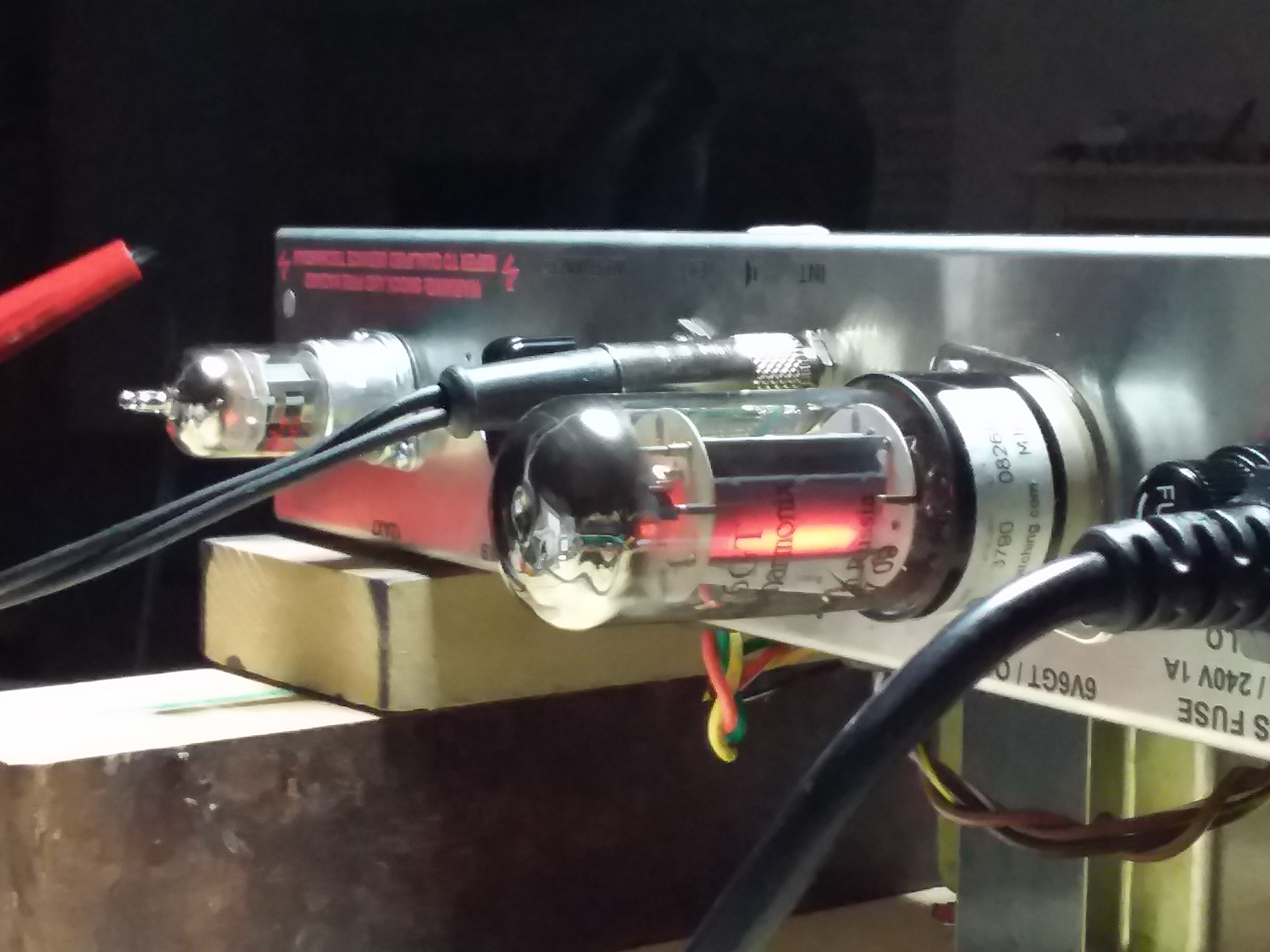

My voltage at B+3 appears to be a lot higher than it should be. I'll have to check the resistor (R10) that sits across C6 and C7 to see if it's good. I'm not sure what to make of the voltage of Pin 8 on V1/12AX7. According to the schematic, the voltage should read 1.7 and I have 1.67. What does Off On refer to? There is one other odd thing that's happening. After I've had my amp turned on for a while and have been playing it the volume just disappears. I have to shut the amp off and wait, then turn it back on. I also noticed that the power tube seems to be glowing pretty brightly. What part of the tube is the outer metal part? Plate and Cathode? I'm going to try and take a picture of it.

Re-checked the voltage at B+ 3 again based on the layout location. It's reading 323v now. I probably measured the voltage at the wrong location. :oops: Tomorrow I'll try playing my guitar through the amp again with VRM set at 400v and see how long it takes until the volume drops off. Then I'll take a picture of what the power tube looks like.

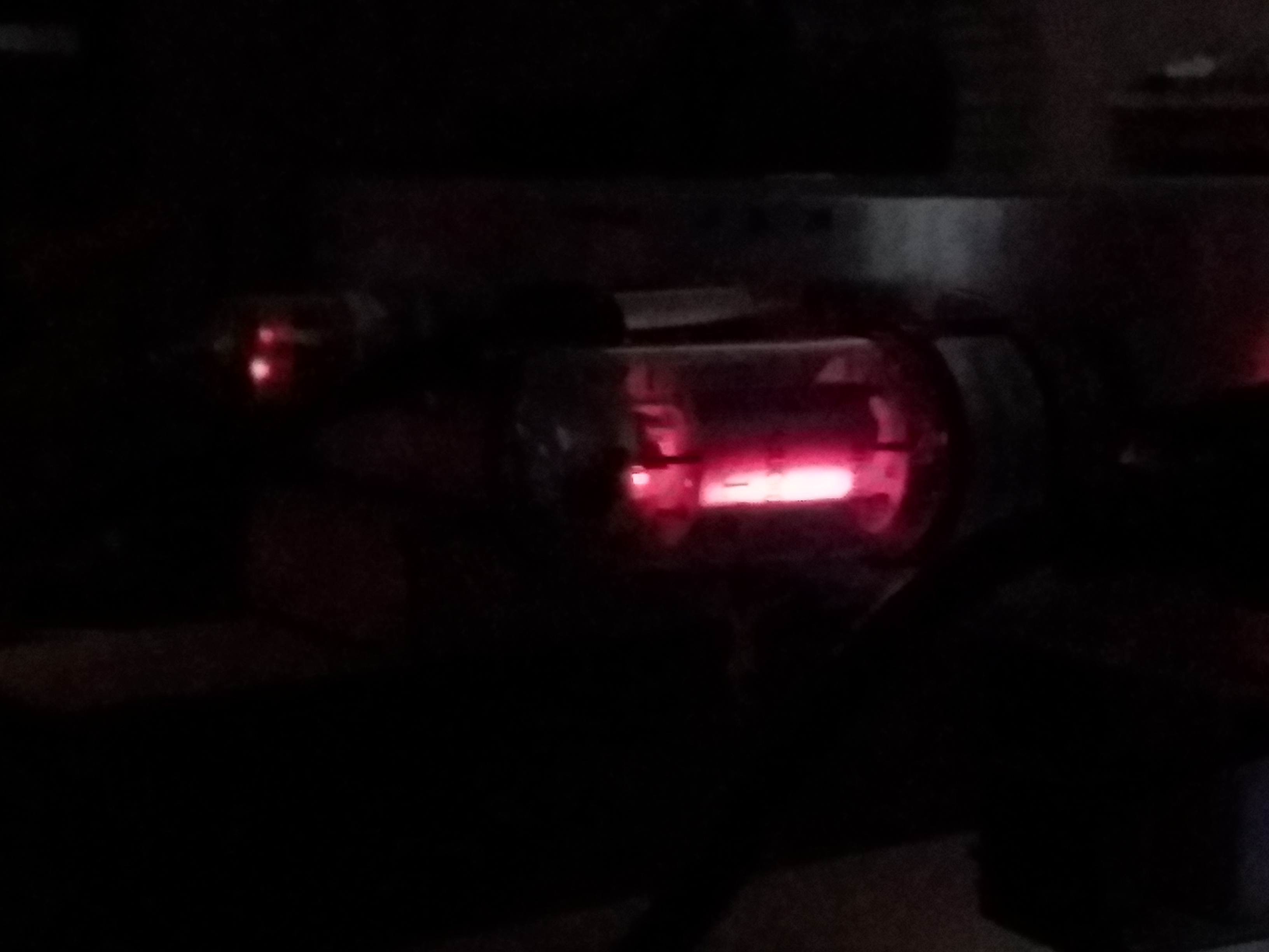

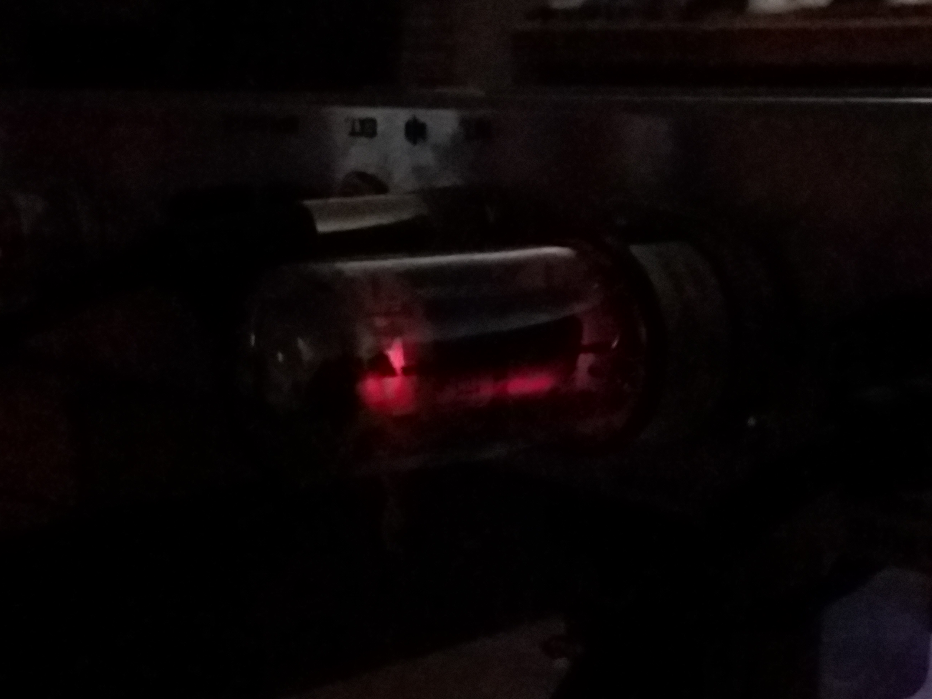

PostPosted: Mon May 13, 2019 10:07 pm
Tube is red-plating and that ain't good :bugeye: The only thing I can see is the two 47 uF filter caps (mine were 50 uF)and the resistor on the gate side of the VRM doesn't look like a power resistor(I have a blue, ceramic looking one there) , it looks more like 1/2 W carbon film. You have what looks like a power resistor in the R4 position next to the large .47uF yellow cap, but I don't know whether any of that could be causing your problem. I'm still learning, too. You might PM Stephen (Coco) from your User Control Panel (top right on screen). You can e-mail him directly from there. I wouldn't play it until you get some definite advice :!:

Sorry, I don't mean to be an alarmist, but the heaters should be the only things glowing. The long plates in the tube shouldn't, attached a diagram of 6L6 , the anatomy should be about the same as 6V6. https://www.tubesandmore.com/tech-corne ... be-diagram

I took some pictures of the power tube with the VRM set at 3 different settings, 10, 6 and idle. The glow became less as I went to the lower VRM settings. I've rechecked my voltages again and they all were within spec.

I tried something really simple. I flipped the switch for the bias setting from the low to the high setting. I figured if I had the 1K resistor for the EL34 wired to the wrong side of the switch, flipping the switch to the other position would put the bias to the low setting. It worked! With VRM@400vdc the tube doesn't start glowing like it did before. Amp seems to be working fine. The reason I decided to just flip the switch were two fold. For one, when I measured the voltage at pin 8 of the power tube I was getting 23.5vdc. This is way out of whack of where the pin voltage should be of 29v so I figured I must have the switch wired incorrectly. The second reason I just flipped the switch was that if I did have the 1K resistor wired to the wrong side of the switch, flipping it should give me the correct bias I need and I could verify it by measuring the voltage as well as checking the tube for any red plating. I guess I didn't really understand what hi and low bias meant in terms of the voltages that should be present at the cathode. I guess I understand that now. Now all I have to do is put the 1K resistor to the other side of the switch and all should be good. The link to the article you sent was my light bulb moment!

If you make some measurements, you can calculate the power dissipation of the 6V6 and it should be within spec. The JJ 6V6S supplied with the kit is good for 14 watts. With the numbers you provided (29V & 750R resistor), the dissipation is 13.2 watts.
