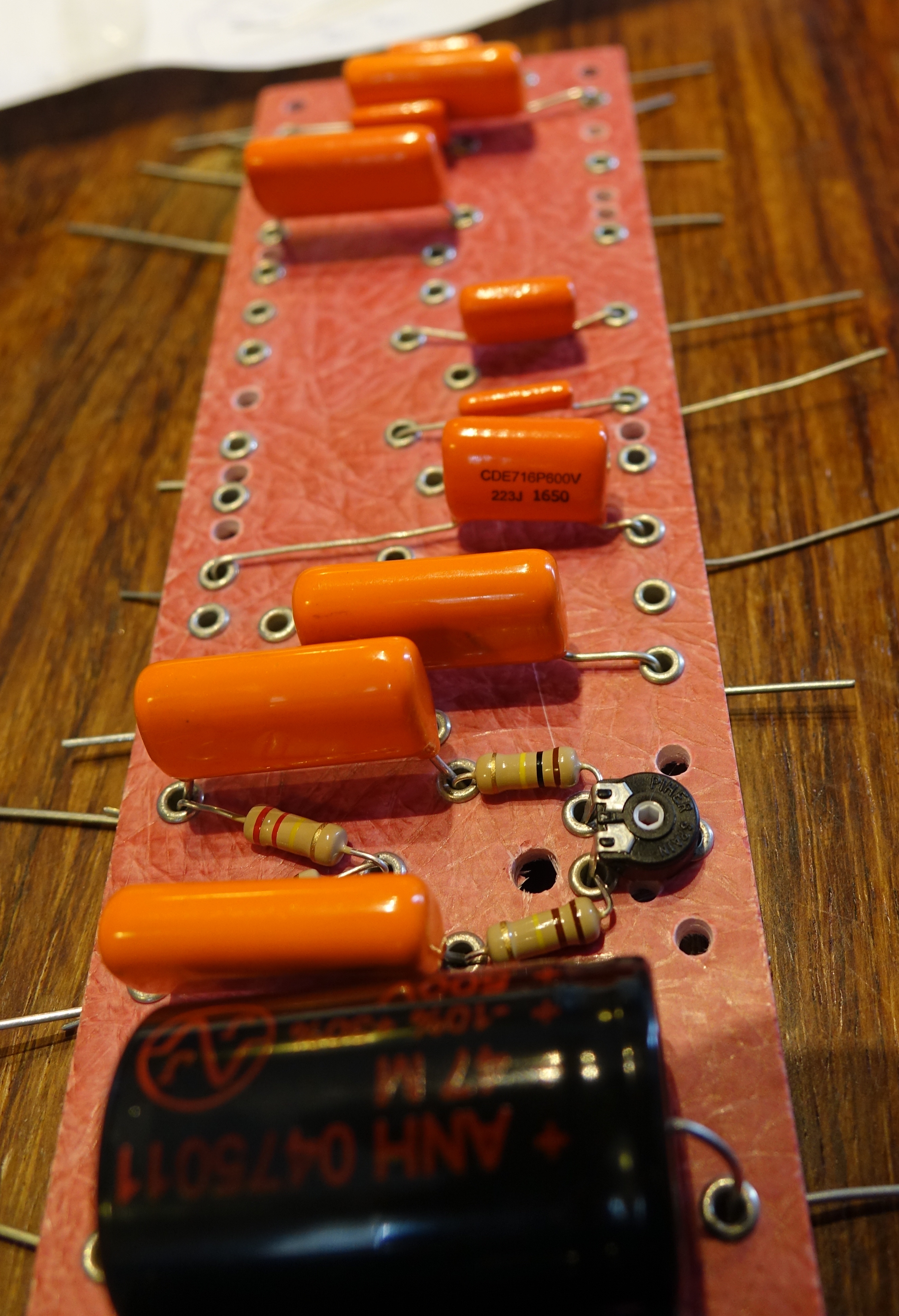

Todays effort.
The small Caps are hard to read, but with a magnifying glass its possible.
Tomorrow relay board.

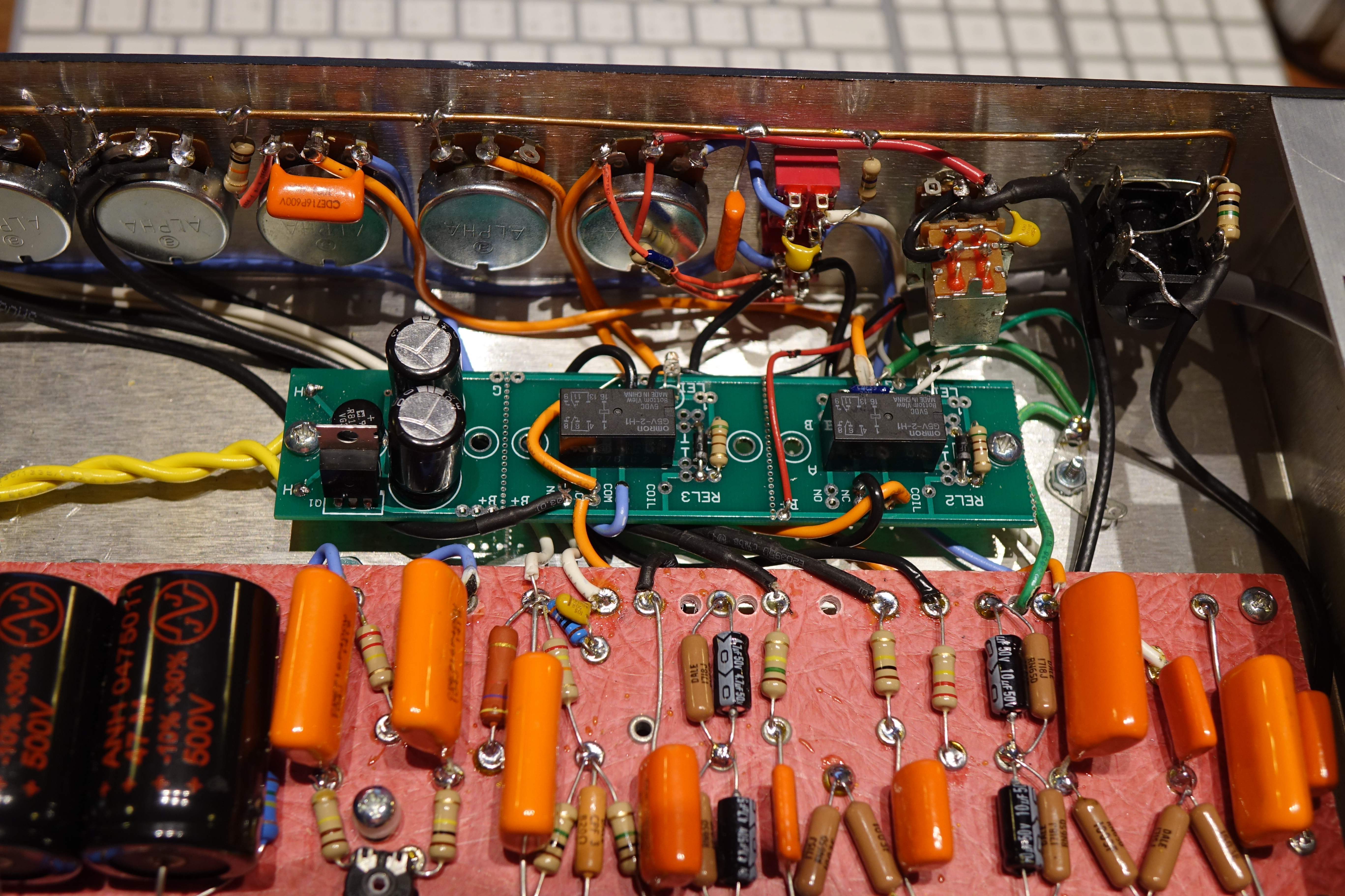

A couple of first hand observations.
Mid Switch is either very subtle, or is wired wrong. Jazz switch looses a lot of bottom, almost sounds out of phase.
Same with the preamp boost.
Maybe this is intentional, I dont know.
But the Rock side sounds fenomenal. As does the OD.
www.paradisepi.com

Can you post closeups of your toggle switch wiring showing Bass, Treble pots as well? The angle in your posted on here was not clear enough but I do suggest you compare it to the latest layout wiring.
Here is a snapshot of just the relay and toggle switch wiring .

Here are some better pics.
I Checked some more, and all seems good to me. Bass works in jazz mode, but in Rock mode, bass seems to be full on, and I can't turn it down. Please take a look when you have a minute. Maybe thats the reason Jazzmode seems a lot weaker. Anyway, The OD is absolute incredible.
www.paradisepi.com
PostPosted: Tue Apr 03, 2018 11:32 am
Does the Orange wire from Bass go to the correct pad on the PAB Relay board? Not the ground pad.
Does the Blue wire from the Rock/Jazz switch pin 4 go to 0.1 uF on the board??
Do the Black wires from the Rock/Jazz switch pins 2 & 5 go to the correct PAB pads on the relay board?
Can't get a good look at the Relay board connections.
I would confirm these all against the picture posted on the relay board connections.
Otherwise looks OK.
Mid boost looks correct.

PostPosted: Wed Apr 04, 2018 10:47 pm
Posts: 112
Location: Bangkok
Does the Blue wire from the Rock/Jazz switch pin 4 go to ground?
Otherwise looks OK.
All connections are good.
Two things though, I cant seem to measure the two 22M resistors. But I know I measured them before I soldered them.
Also, the 220k resistor that goes to the relay board, measure at 120k.
Other than that everything checks out.
I will try to find a 220 k res, and change that.
I actually had one, but looking at the colorcode on previous kits, it looked right.
I did have a couple of resistors in surplus after the kit was done.
www.paradisepi.com

PostPosted: Fri Apr 06, 2018 10:53 am
I went back to basics, checked the schematic, checked the layout, checked the reference build here and tested all the combinations with bass and all switches (no relay tho). Looking for a mistake at my end and all I can say is, it works fine.
So you should trace the connections / continuity through from component to component against the layout. Maybe check continuity to board/components with Rock ON an then switch Rock OFF to see if there are any changes.
By the way, the Blue wire from the Rock/Jazz switch pin 4 should go to the board .1uf cap, NOT to ground?
PostPosted: Sat Apr 07, 2018 1:15 am
Posts: 112
Location: Bangkok
Thanks Stephen.
I will do that.
The blue wire does connect to the .1uf cap, its just connected under the board.
www.paradisepi.com
PostPosted: Sat Apr 07, 2018 8:03 am
To test mine, I plugged in a guitar cable snd a speaker. Turned the vol down and touched the end to cause a hum.Then I started flipping switches to see what happened and they all workedq.
