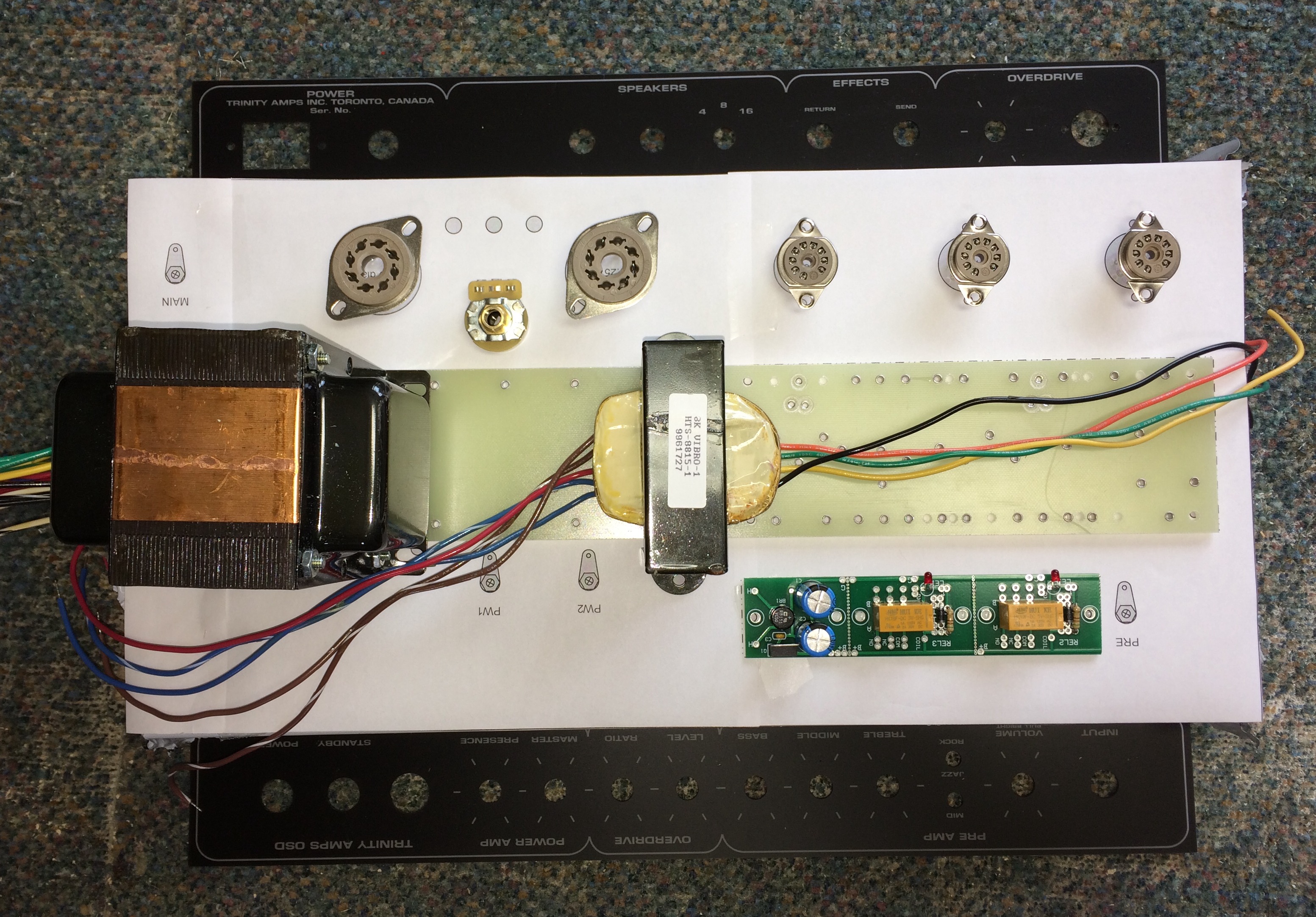

We used the "Headphone Trick" to establish the best location for the transformers.
"First set up the power transformer. Wire up the primaries to a power cord, but do not wire up any secondaries-- tape the ends of the secondaries.
Now set up the signal transformer (output, reverb, whatever). Hook one set of OT secondaries, the highest impedance and ground, to a set of headphones. Tape the primary leads.
Put the headphones on, plug in the power cord, and start moving the signal transformer around. Try it all over the chassis, and also rotate it. While you might expect the least hum with the transformers as far from each other as possible and at right angles (and that may be the case for you), it might come at an odd angle and/or position. Sometimes the least hum occurs when the transformers are side by side. When you find the quietest spot, use a permanent marker to mark where the mounting holes should be."
The bare eyelet board was built today.
