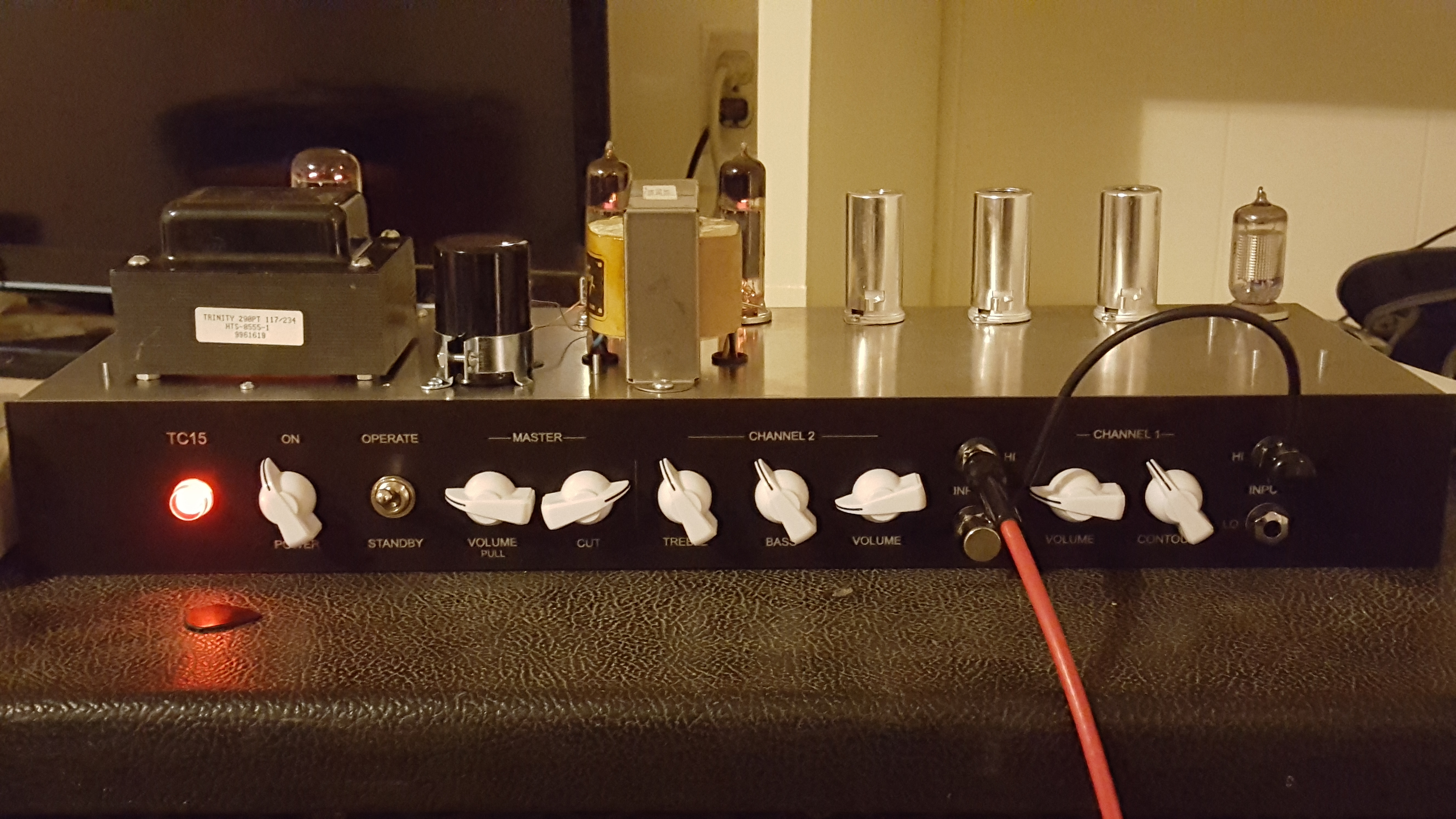

Well i finished my build tonight and everything looked pretty good so i decided to plug it in, no smoke, no sparks. Good right? Plugged some tubes in and they all lit up, still no smoke or sparks but unfortunately no sound either. Dead quiet...Where should i start? Input jacks?

It's working perfectly and the tone is amazing! Thanks to everyone for your help. I had a great time building this and am now saving up for a triwatt.
