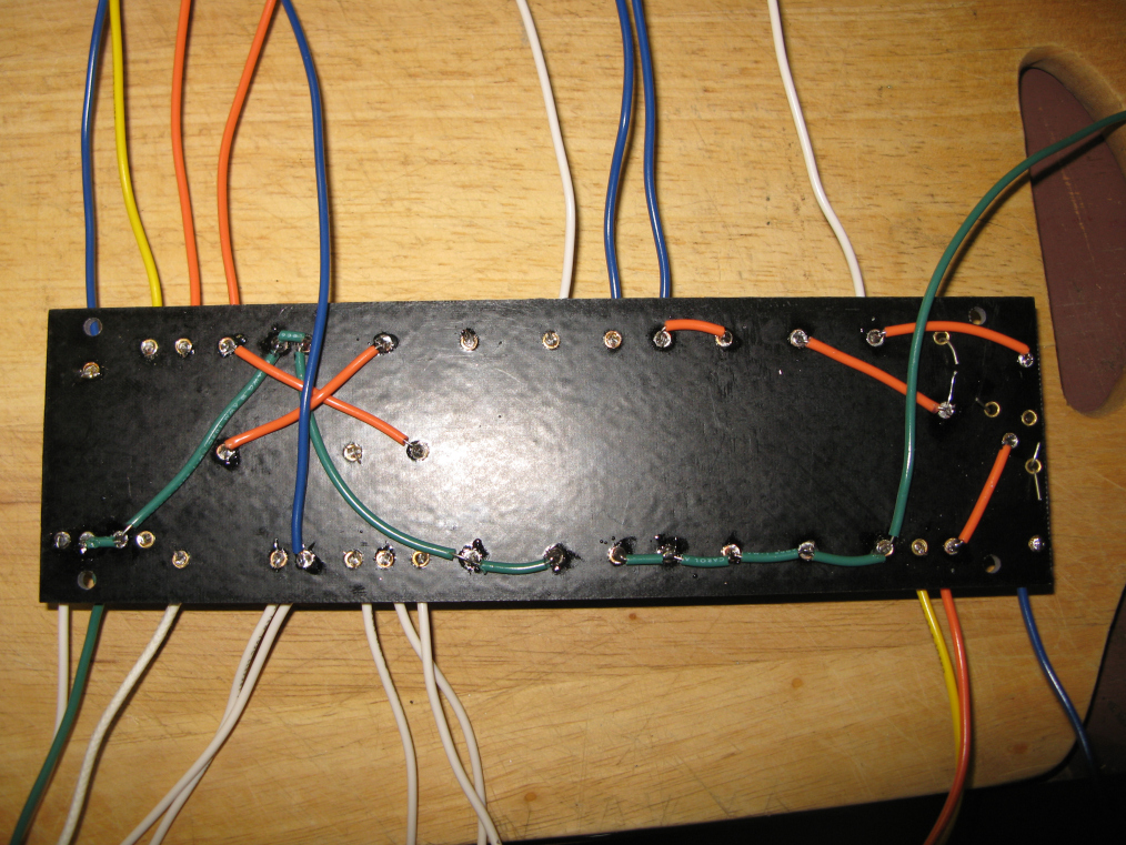

Posts: 85
Duke wrote:
Completed the board yesterday. Time to move on to the chassis.
Too bad I didn't show you the back, eh? I'll attempt to fix this problem today.
 Post subject: Re: New Amp Day
PostPosted: Sat Jun 25, 2016 12:17 pm
Yes, the preamp wouldn't work too well that way. It wouldn't work at all, actually!
Good thing you spotted that now. Wiring proiblems on the underside of the board are hard to fix once the board is installed. This should be easy to fix but you will need a longer jumper.
The build looks good so far. Slow and steady with lots of checking and double checking is the way to go.
PostPosted: Sat Jun 25, 2016 1:20 pm
Move that jumper one hole to the right on the top row.!
PostPosted: Sat Jun 25, 2016 11:09 pm
Posts: 85
I had to fix the misplaced jumper. Here’s how it went down. First I removed one side of the affected components.
The big problem was the jumper was on the underside of the board and I didn’t want to remove the board. I used copper braid to remove the solder from both eyelets. I could see the tips of the jumpers. I took an inflation needle and after heating the eyelets I pushed it through shoving the jumper leads out.
I ran the new jumper on top the board underneath the components. I made sure to get it right this time.
So I fired up the amp and everything looked fine…voltages great. I plugged in the Les Paul and it sounded great, then I tested it with the Tele. I switched the 6v6 out and tested it with a 6l6. I love the 6l6 in this amp. Later in the evening I took out the Strat and ran the amp through the full range of options, tone and volume. It’s great!
The board was already attached and wired in. It wasn't too difficult to remove the underside jumper once I figured out the above method. I took my time and thought that one out before removing it. :hmmm:
