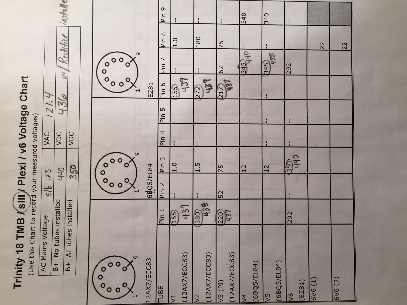

For some reason I am getting my B+ voltage on the plate pins of all power, PI, and Preamp tubes instead of the ballpark values shown in the Trinity 18 Voltage Chart.

I moved on to the next test, on page 67, where I installed the EZ81 rectifier tube. I powered up for 10 seconds then turned on the standby switch. B+ was 436 VDC at the first 1.5K 5W resistor and 440 VDC at the rectifier socket (pin 3) which seems normal.
Next I moved on to testing the plate voltages on the other power (pin 7), PI and preamp (pins 1 and 6) tube sockets. My results were between 437 - 439 VDC (aka B+ voltage) on every one of these plate pins. I believe something is wrong so I stopped testing at this point.
File comment: page 67 testing process
File comment: 18 watt voltage chart results so far

PostPosted: Sun Jan 04, 2015 6:08 pm
438V DC with the recto installed is good
Now did you install all the other tubes when reading the plate voltages on the other tubes? With the other tubes (preamp and output tubes) installed the amp won't be "loaded down" and you'll see weird high voltages across the amp.

See my attachment with the testing procedure. In this step only the rectifier tube should be installed.
PostPosted: Sun Jan 04, 2015 8:51 pm
If you only have the recto in the voltages are all going to be high and really mean nothing
Add the other tubes, hook up a speaker and test voltages again.
