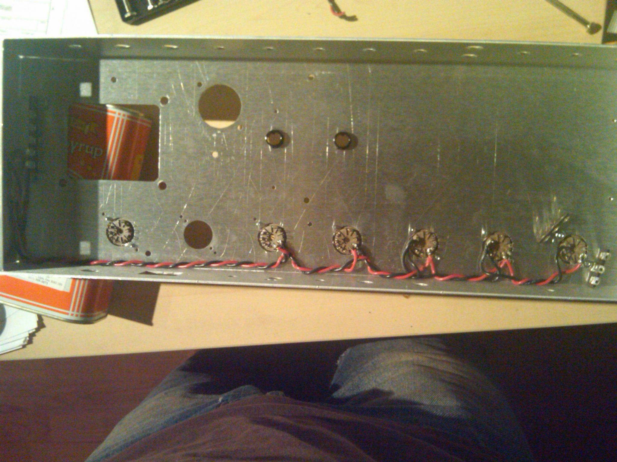

forgive me...i'm reading a lot here...i think i am following most...but here starts the questions...
1. more of an observation than a question...revisiting the wiring...i am thinking my heater wiring past the Power tubes needs to be re-done...not quite as tight as the rest of the pictures i've seen online...this is the first picture...i'm going to have to track down some new wire...i don't have any left...or...should it all be redone?

1. That's more than tight enough
