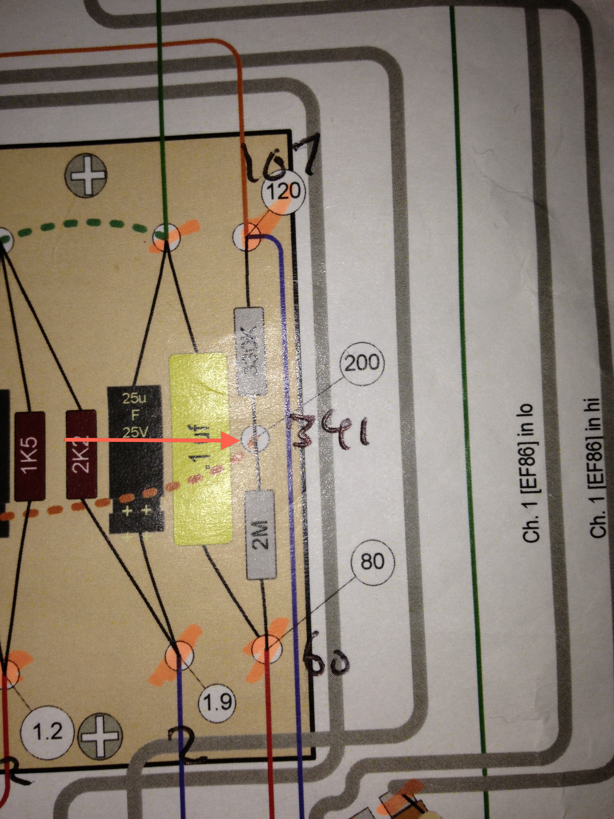

The biggest variant to the documentation is of one of the voltages on the board.
see the pics it should read 200v but reads 340v
Going to assume you meant pin 6 there.
That layout/pic is wrong and has not been updated. You will never measure 200V there, 340V is fine. My TC-15 measures the same there.
All your voltages are fine. I'd look for cold solder, bad joints, broken/loose wires in the phase inverter and output section. Could also be a bad pot/cap or something weird.

Ok, i'll try re-flowing phase inverter joints and any other suspicious areas and let you know what i find.
