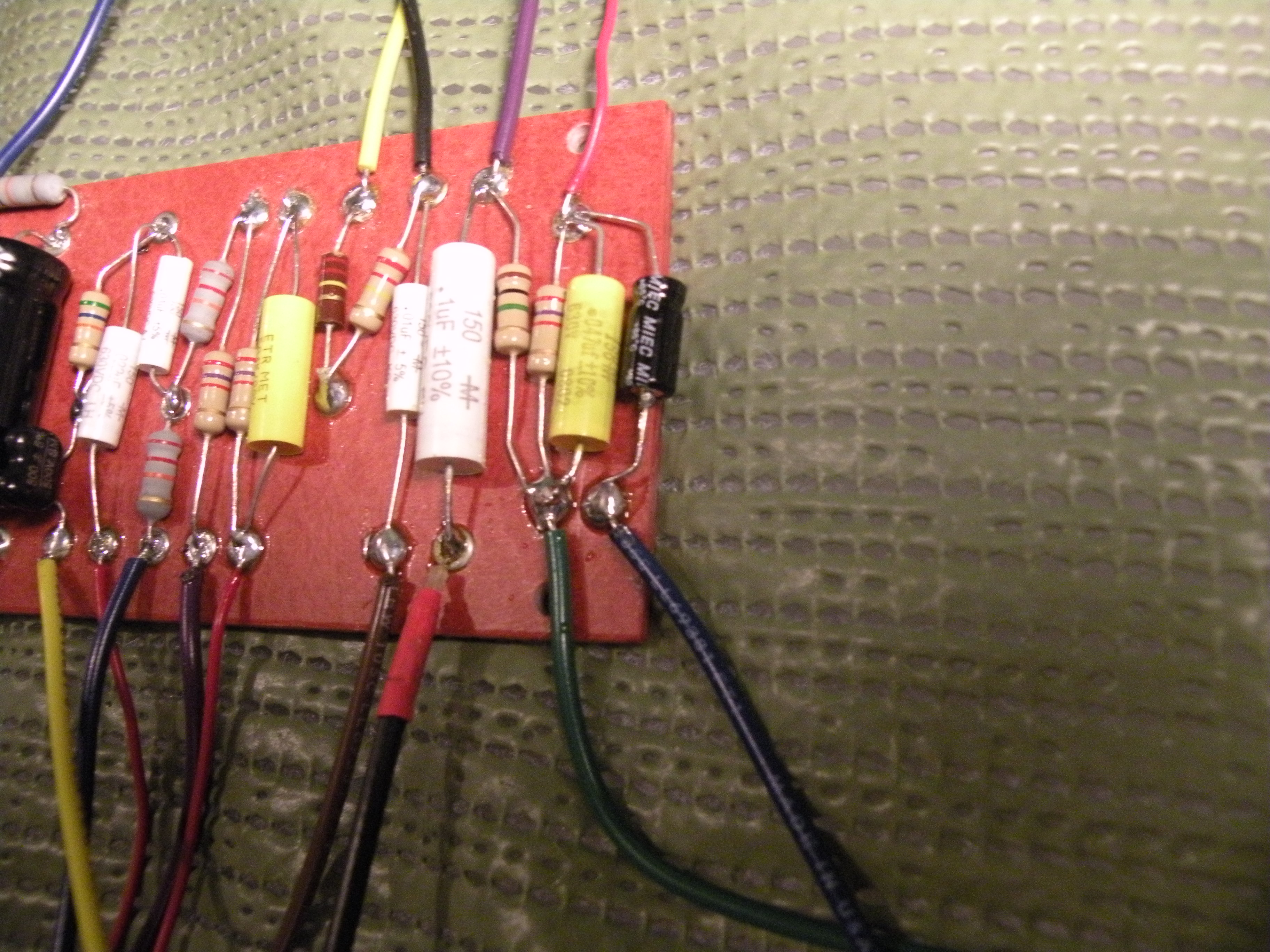

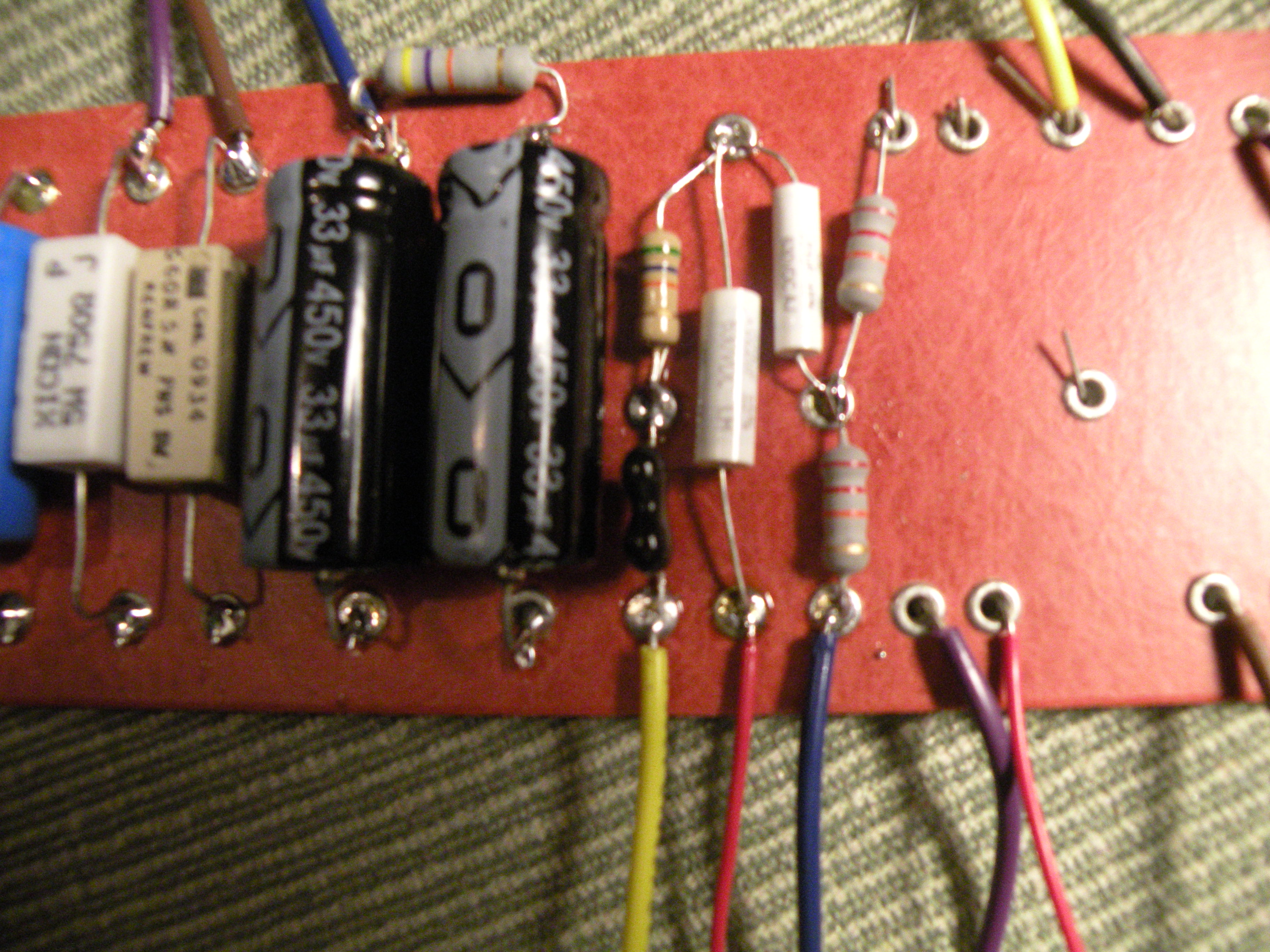

Started populating the preamp side of the eyelet board. I have only done half of this section. I find that it is easier to do a couple components and solder them; then move to the next. As I am right handed this gradual process makes it easier than trying to get the soldering iron in between components. So here are three pictures. The first is the large preamp capacitors and the second shows a couple of smaller capcitors and the two 22k resistors.
I had to stop here because the next steps required two 2k7 resistors, but my kit did not have any. I noticed that that the layout diagram shows a total of three 2k7 resistors in the preamp section. My kit did not have any 2k7's but did have three extra 220k resistors. I have sent a message to Stephen asking if the 220k's in my kit are new substitutes for the 2k7 resistors. I show a picture below of the three 220k's (red-red-yellow). I am waiting for directions before proceeding. Good to go slow.

So while I had the time today, I went on and populated the rest of the preamp side of the eyelet board except for the three 2k7 resistors. I also soldered the shielded cable and put a red heat shrink around the shielded mesh so as to avoid any possibility of it touching here; only on the jack side of this cable should the ground shield be attached.
While I am waiting on what to do about the three 2k7 resistors, my next steps will be to place the Mosfet VRM in place, and then start wiring the input jack and the potentiometers. The manual suggests that it is easier to wire these (jack and pots) with them temporarily removed from the chassis. Getting excited about nearing the finish. What a fun project. Can't wait to hear what it sounds like.

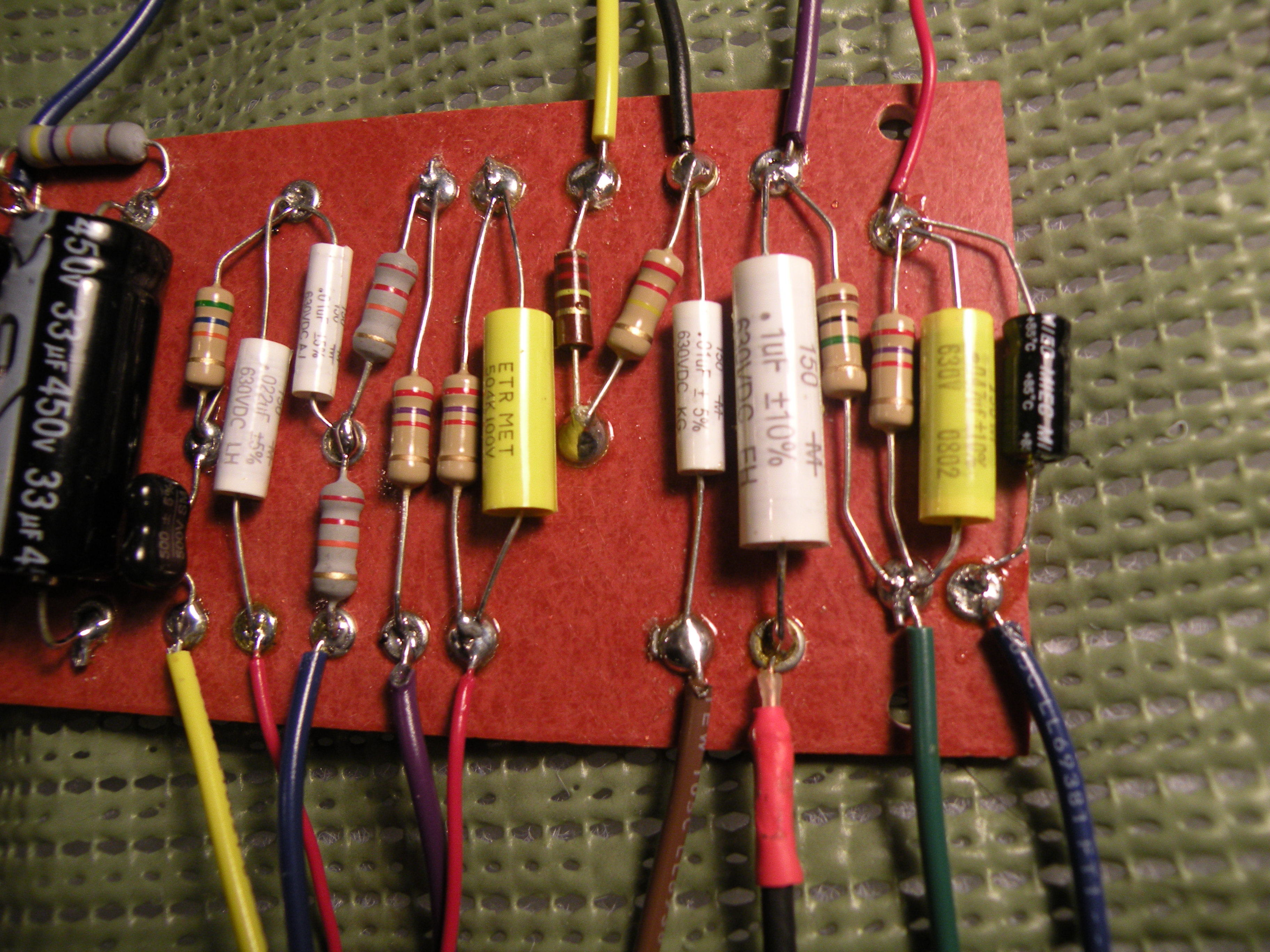

Hurray! My three 2k7 resistors arrived today (along with the three EL34 type tubes). I immediately soldered them in their places on the eyelet board. Here are two pictures: first picture is the three little culprits; second is them on the board. I hope to finally finish this project this weekend. More updates to come.
PostPosted: Wed Jan 09, 2013 10:00 pm
Might want to reflow the two joints on the bottom right hand side of the board.
PostPosted: Wed Jan 09, 2013 10:06 pm
Posts: 108
Thanks. I will definitely redo those. Appreciate the advice.
PostPosted: Wed Jan 09, 2013 10:22 pm
Posts: 108
Resoldered the two lower right eyelets and made sure it had a good flow. I also took my etching tool [edited to add a pic below]and made sure that the two do not touch. Thanks and please do give input and advice; I want to get it done right.

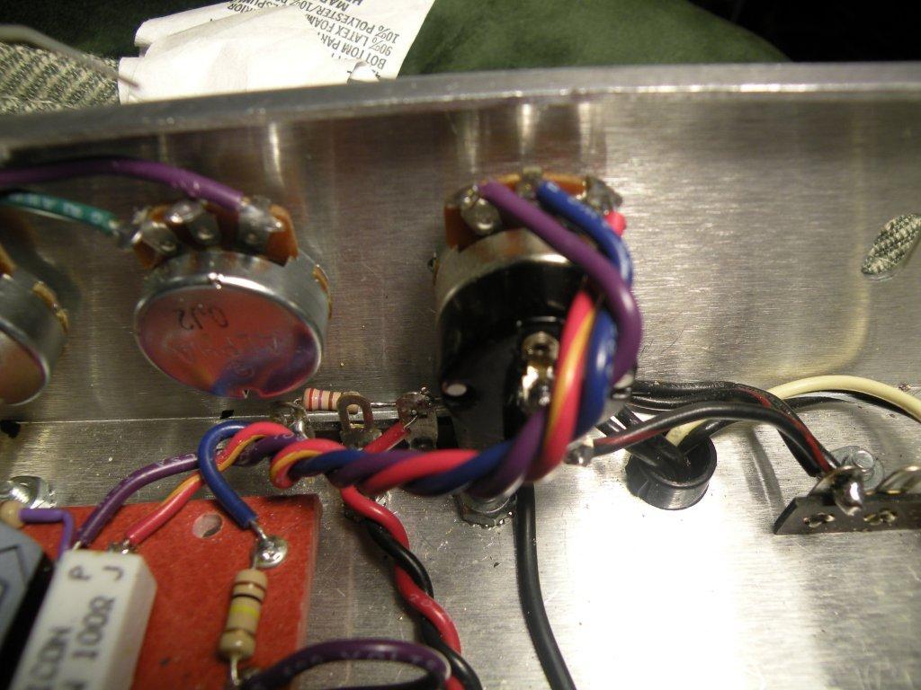

I got busy at it tonight and got a lot done. I took the pots off their temporary cardboard jig and put them and the attached eyelet board into the Tramp chassis. First I connected the green ground wire for the power side of the eyelet board, which runs from the star ground to the first large capacitor--this is underneath the board so it cannot be seen in any pictures, but it is done. I then started connecting the flying leads to the rear chassis components; I did this in an orderly fashion working from the left to the right. The first picture below is of the board with the connections now in the chassis.
I had a small problem with the bias switch--I ruined one of the posts trying to get the wires into the little, bitty small holes. So I bought a replacement DPDT switch. I then carefully wired it. I ended up using some of that thin red wire I mentioned earlier, which I stripped and used it as the bridges across the upper and middle posts on this switch. A picture below is provided of this switch now wired.
I also enclose a picture of the preamp tube socket now completely wired. I also show a picture of the push/pull pots now wired and in the chassis.
I then connected the two red power 630 VAC twisted lines to the eyelet board. And I connected the three small leads (Snowy's method) from the VRM Mosfet to the eyelet board. A picture below shows these connections on this end of the eyelet board.
Finally, I connected the three braided VRM wires that go from the eyelet board to the power level pot. A picture of this is also attached.
This weekend I plan to connect the preamp star ground, connect the yellow wire from the Power tube socket pin 6 to the master volume pot post 2, and connect the wire from the 22k resistor on the volume pot that goes to the 8 ohm (green) pin on the impedance rotary switch.

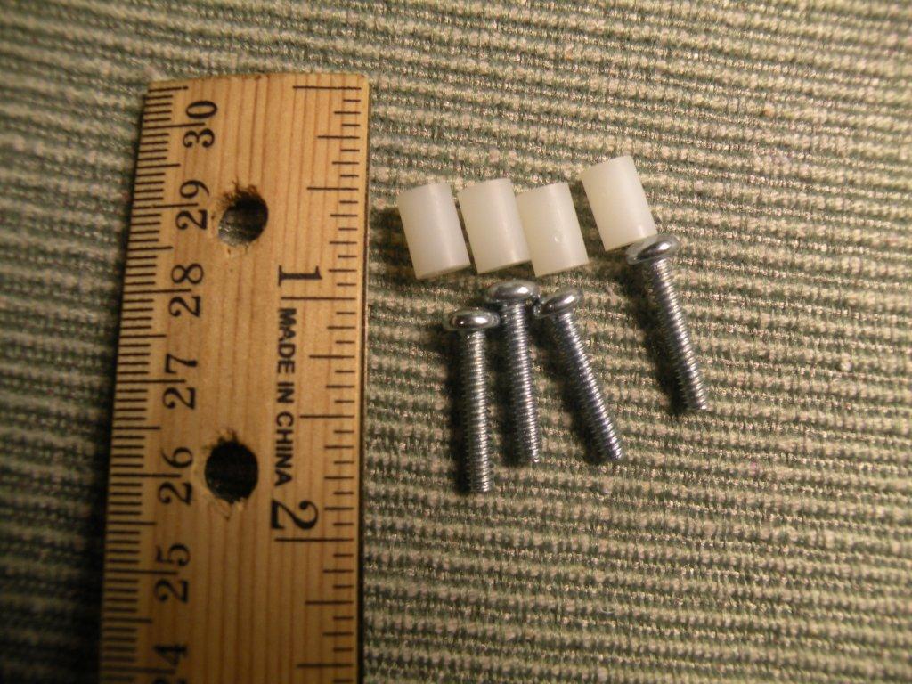

Today I finished installing the eyelet board in the Tramp.
First I used the four screws and four standoffs (picture below) and attached the eyelet board to the chassis. This was a two person job. My wife has smaller hands and she was able to hold the standoff in the correct place while I placed the screw and screwed it in--four times.
