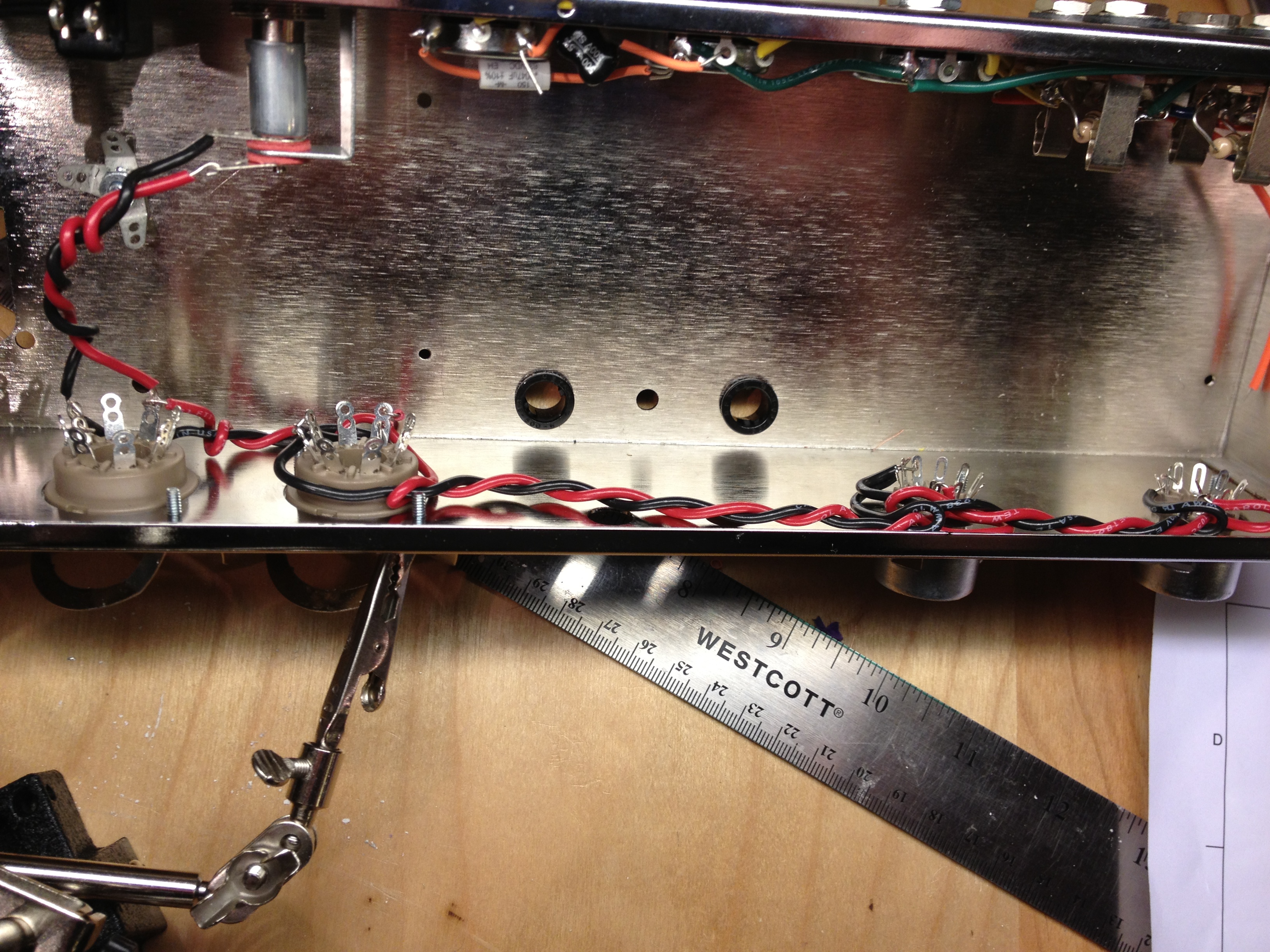

Well it didn't take long to have a question about heater wiring...Excuse my ignorance but I don't seem understand how V1 get the power passed to it? Unlike the power tubes where the wire runs from pin to pin on the preamp this it looks like a different route to me.
Is the wire bifurcated (split) so that it goes to both preamp tubes? Or are there two separate pairs of wire from the V3 tube to both preamp tubes?
Please chime in if you can help, thanks.
Muddy
Calgary,AB
 Post subject: Re: First Build (Tweed)
PostPosted: Wed Dec 26, 2012 10:52 pm
Daisy chain the wires from the power tubes to preamp tube heaters. Keep the polarity consistent from tube to tube, I.e. keep pins 4-5 connected on both tubes with the same wire. Same for pins 9. Review the layout.

I guess I don't know what daisy chain topology is, I admit to being out of league with wiring. Does this mean that there is 2 sets of wire (Red+ and black-) running out from V3 to each of the preamp tubes?
Explicitly this would mean from V3 Pin 2 has two red wires from it; one goes to V2 Pin 9 and the second red wire goes to V1 pin 9.
Likewise there is two wires from V3 pin 7 (black) that travels to V2 Pins 4 and 5 as well as a second wire travels to from V3 pin 7 that travel to V3 Pins 4 and 5
There are also jumpers from Pin 4 and 5 for each pre-amp config.
Let me know if this correct, thanks. Maybe I am reading the diagram too literally? I don't see two sets of wire just one.

run the wires from tube to tube. aka serial.

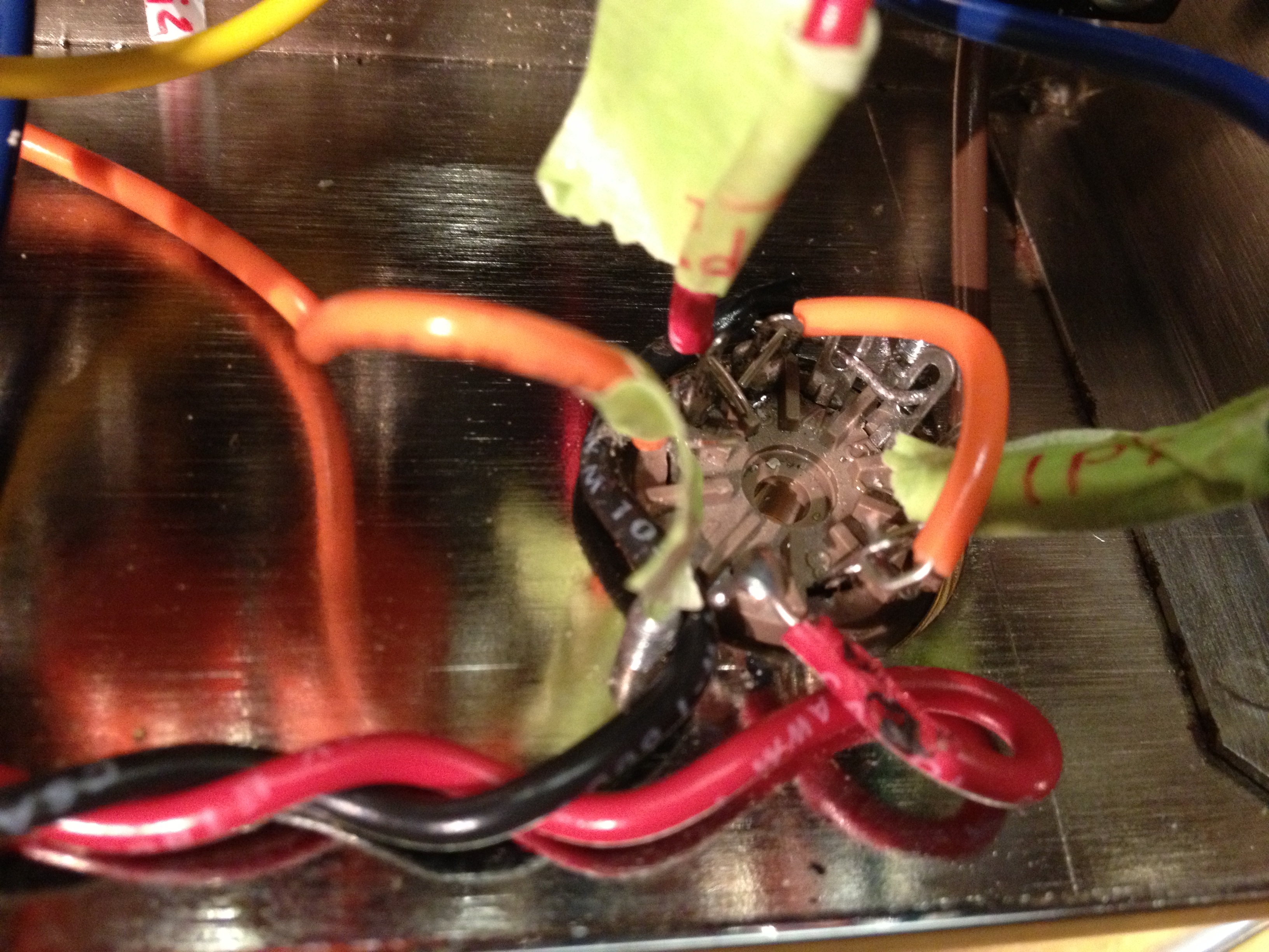

Thanks; I think I've got it now. Please comment on the images if I have screwed this up.
1) Heater wires complete; V2 gets juice from V3 pin7 (negative) and pin 2 (positive). V1 gets (negative) from V2 pin 2 and (positive) from Pin 9. Pins 4and 5 are jumped. Nothing soldered please let me know if I have this right!
2) Jumpers mounted not soldered.
3) special coax wire prepared not installed.
I found the actual placing of the wires somewhat finicky; difficulty ID-ing the right pin. Ok now time for scotch.

Jumpers aren't correct. Compare it to the attached pic.
I think the heaters are ok.v4 gets power from the light socket, v3 from v4 etc. There is no positive or negative in the heater voltage btw. It is AC volts.

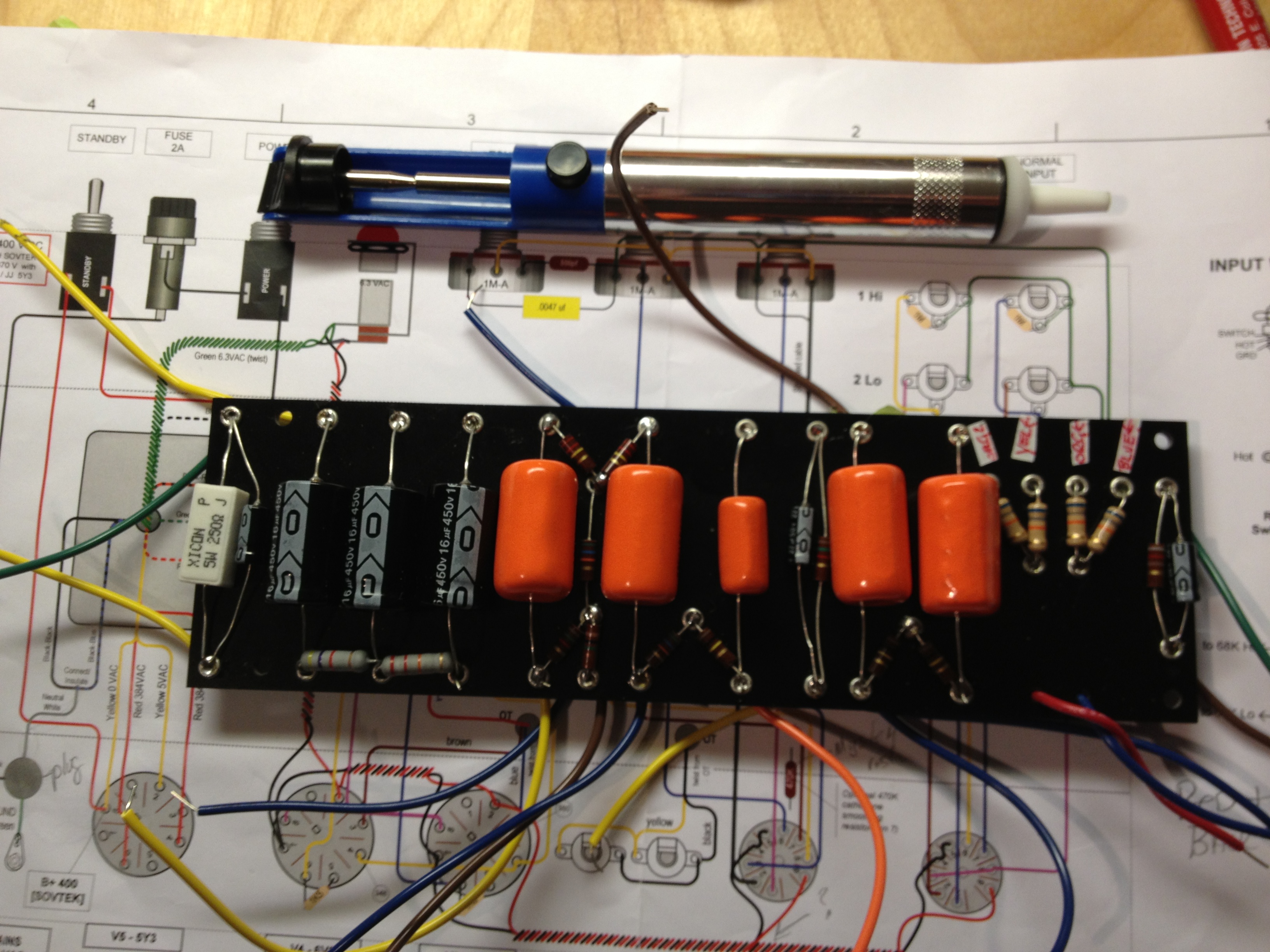

Yeah thanks Stephen; I had thought the two long leads were jumpers but when in fact they feed the power tubes V4 and V3 to pin 6. From the diagram it would appear the two leads don't make an appearance on the top side of the board and poke out from underneath near the 6V6 sockets.
Here is a pic of dry mounted board and now I will heat up the old iron....

That last image has a mistake with a resistor on the dry mount. Can you find it?

hard to see in the shadow, but it looked OK. Which one?

It is a good thing I am taking my time with this; double/triple checking so far it working to find errors; thanks for the tips and help.
The 4K7 and 22K ceramic resistors were in the wrong position. Luckily I had not soldered anything.

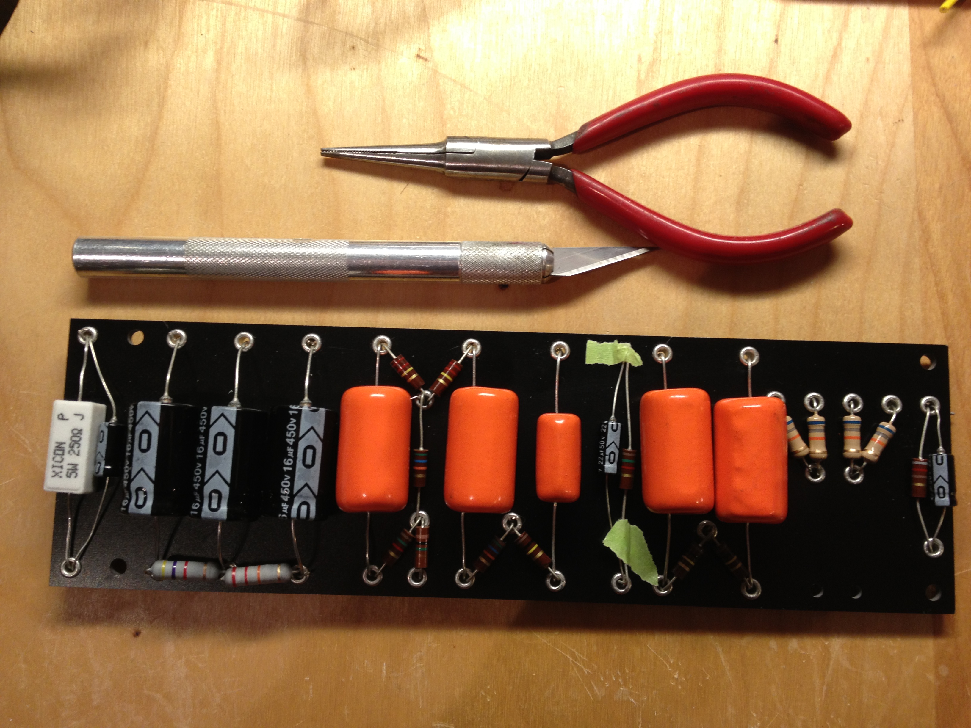

Here is the board on the last day of the year; good steady progress. Will install trannies next and solder heater wires.

The resistors look like they are still in the same position (the right position).

Kurt: yes I may have confused myself, the photos do look similar but are now correctly positioned; I think I took the ceramic resistors out to bend the wires so there was more room for soldering as they are tight between the caps. At that time I then put them in backwards. :oops:

A had a set back on Sunday :( as I discovered a mistake in the heater wiring pins for V1 and V2. Pins 9 for both sockets were Ok but where I should have had pins 4-5 I had pins 3-4 by mistake. I think i was thrown off by the diagram as my sockets are orientated 25 degrees different than the diagram. Maybe the diagram could use updating or maybe it is my lack of experience dealing with tube sockets on the business side. :damntech:
Before I resolder them perhaps a comment on keeping the signal wires out of the way of the heater wires. See my V1 setup.
