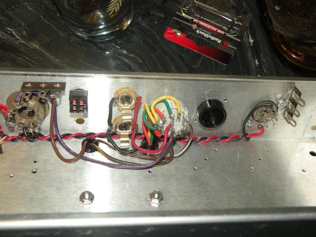

Posts: 108
Next I choose to wire the impedance rotary switch. Here I followed the online instructions for a six position switch so the Tramp can take 6V6, 6L6, EL34 and KT88 by rotating the switch and selecting the appropriate bias; see this thread for instructions: http://www.trinityamps.com/phpbb/viewto ... =16&t=2919 . I also wired the two output jacks for the speakers. Notice also that I am using a purple wire to go from the rotary switch to pin 3 of the power tube. The brown wire from the output transformer is not yet soldered to the terminal as I am waiting to put the resister in and solder them together at the same time.
[[edited: I also have the impedance wires separated out from the red & black heater wires in an attempt to keep power and signal wires separated and hopefully reduce hum.]]
Earlier I omitted a picture of the red & black twisted wire that connects the power and preamp tubes at this initial stage of wiring; however, you can see that wiring here.

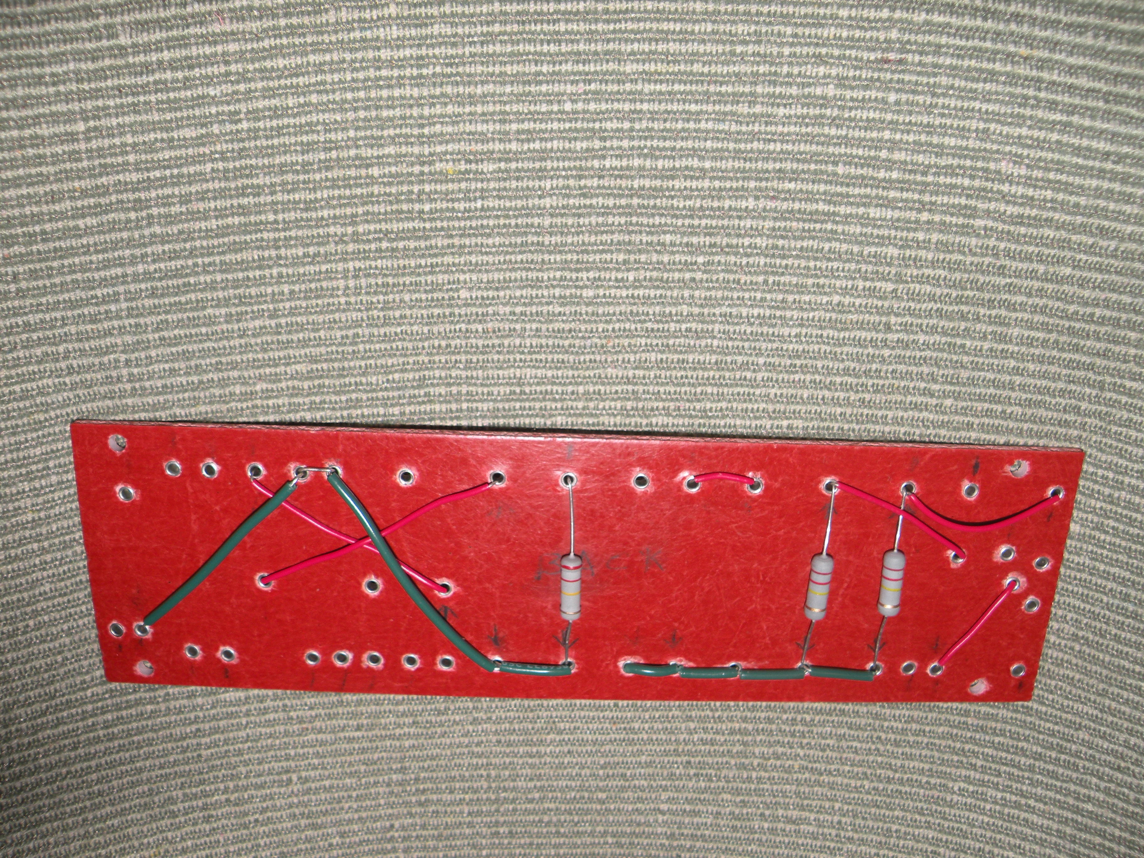

Need some help with this very thin red wire.
I began prepping the eyelet board for population and particularly had a question about the back of the board. I looked for 20 or 22 guage red wire but could not find any in my kit. I have green 20 gauge wire, but the only red wire that was included my my packet is very thin, so thin that even with magnifying glass and two pairs of glasses I still can not determine the gauge, but it looks like 64 gauge--I can see that it is 300v with 80c temp. I checked the photos of other builds on this forum like Snowy's and I can't find anywhere on their builds where this ultra thin red wire was used. His build looks like the red wire was 20 or 22 gauge; whereas the one included in my kit is probably 64 gauge. So here is my question:
Is this very thin red wire the one to be used for the back of the eyelet board (to be used in addition to the green 20 gauge ground wire)? It seems so thin that I want to make sure before I run it everywhere and potentially have a problem down the line. There is not enough of the red wire on the PT to use it through out or even for the back of the eyelet board.
So attached is a picture of the red wire with the green 20 gauge for comparison to this thin red wire (again, this is the only red wire included in my kit). I will wait for your guidance before proceeding forth. Thanks.
PostPosted: Thu Nov 29, 2012 10:57 pm
That red wire is the 22 AWG (might be 24 AWG I forget).
Use it for jumpers under the board and also for the connections to the push pull pots. You'll see the pots switch lugs are very fine. This thin gauge wire will fit the lugs.

So while I was waiting, I went ahead and marked the back of the eyelet board [for connections and leads], and also placed the three (hidden) resisters ready for soldering later. We never get to see these resisters; so this is itself a helpful exercise.

Back of eyelet board is done, but nothing will be soldered until the front is populated and the lead wires are added for connecting to the pots and tubes. Like the manual said, wait till the board has all the components and then solder.
[Edited: I see from hindsight that I put up here a picture of the back of the eyelet board that is flipped over (top to bottom] and may confuse some one. So I am adding a second picture of the back side [flipped end over end] and this one conforms to the same perspective as the picture in the manual. Hope this will prevent any confusion.]
