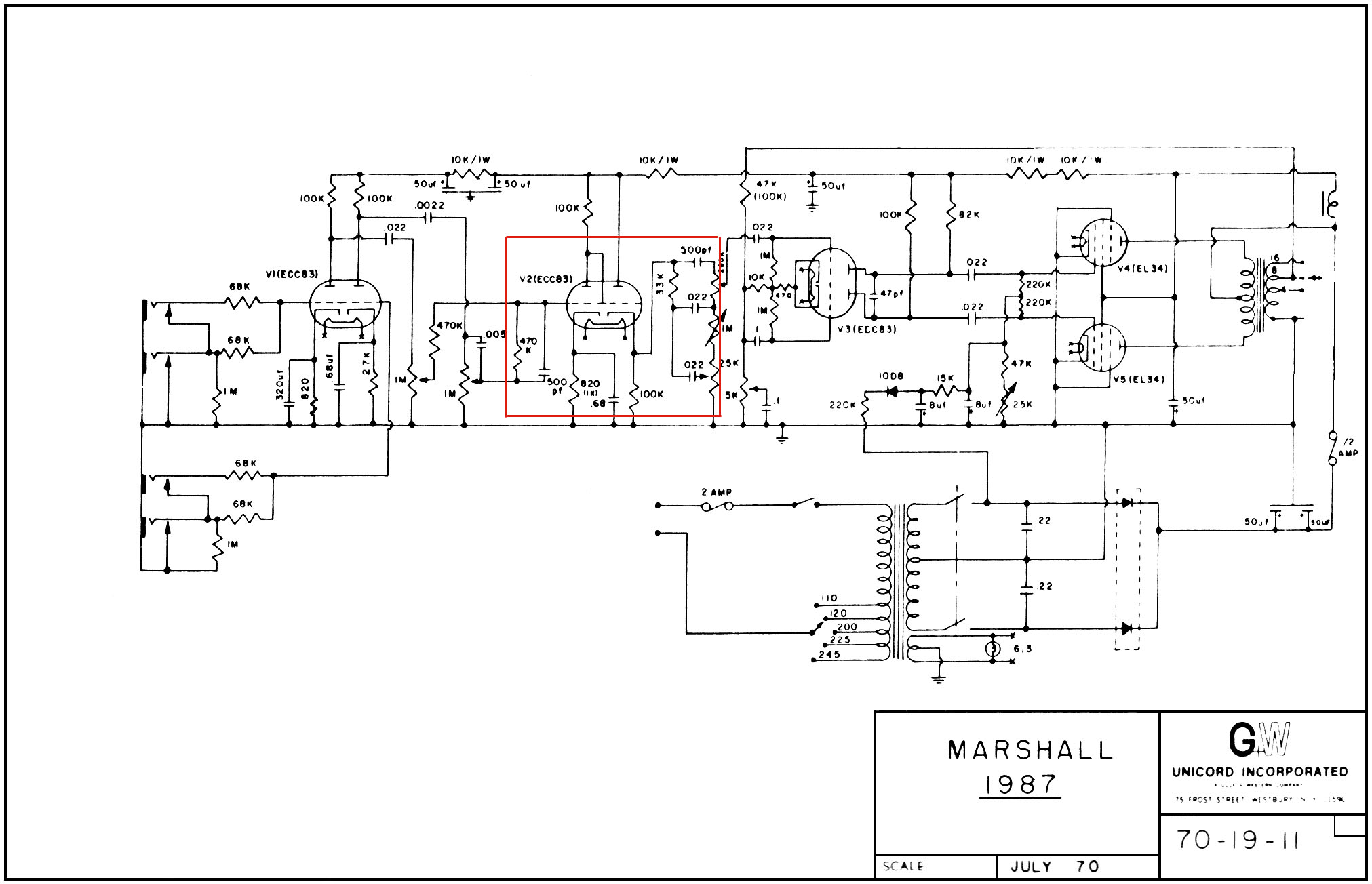

The R42 is the mix resistor for the TMB channel entering V2 and the 500pf is the bypass cap for that resistor.
I have highlighted the V2 and tone stack in the schematic below and that is exactly what I now have in my amp. Notice also the .68uf cathode bypass on V2A. That is where I have my FAT switch.
Incidentally, my amp now has the stock 1959/1987 spec. (i.e. no brown values) :bugeye: :oops: :oops:
