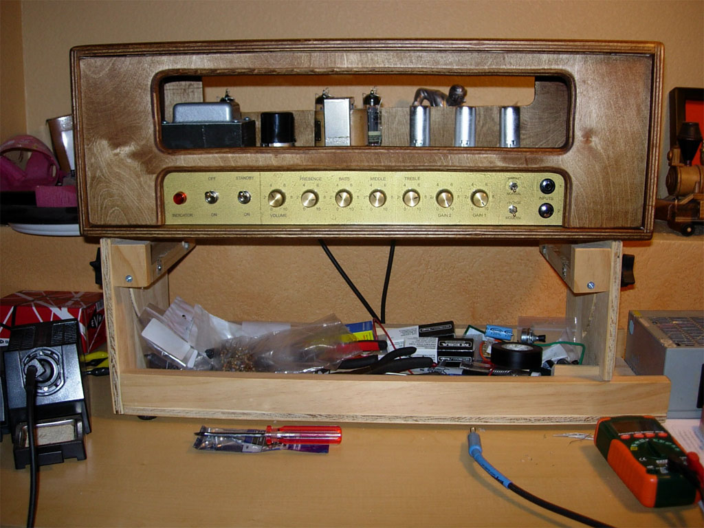

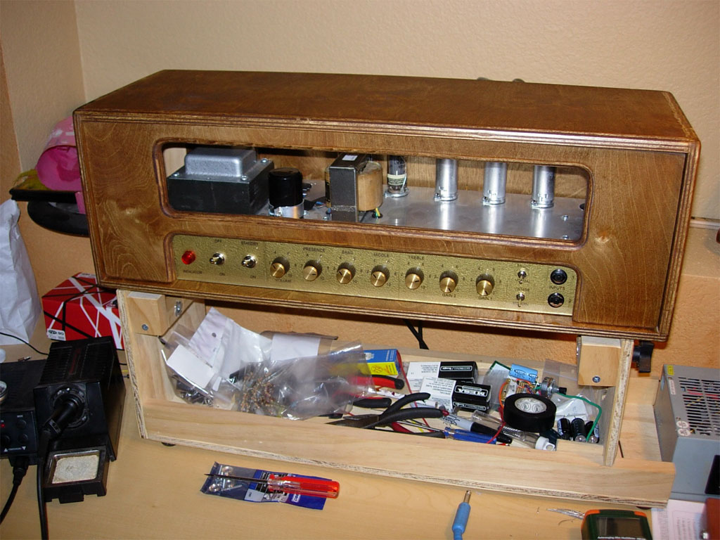

I finally got around to making a cabinet for my amp. Not done yet but here is the first time the amp and cab have come together. Please disregard my attempt at making a faceplate. I will be ordering a real one someday.
Les
 Post subject: Re: My DIY Head Cab
PostPosted: Wed Feb 22, 2012 10:36 am
Looks pretty good from here. Plates cost about $60 unless a local engraver can do it for less.
I dont think that panel matches the schematic labels, does it? Maybe we should synch them, or have you just moved on and done more? I see presence which we didnt do and I'm guessing feedback & cascade switches, but I cant read the labels on the pic.
