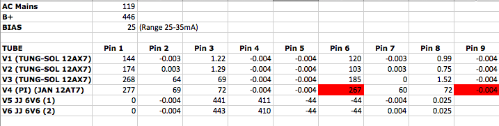

Started this build two years ago, but due to travel and life the amp has just been finished up recently. Initially the checks on the amp where good, however once I fired it up and started playing it... obviously there's a problem.
When switched to standby, everything is good (tubes glow, no fuses pop). Switch to ON, w/ or w/o a guitar plugged in the amp hums quite a bit. With a guitar hooked up the notes are very distorted almost sounds like an oscillation. (This is all on channels no overdrive.
Below are my tube readings, I see there is a problem with the PI section. However I checked everything and it looks/measures fine. I'll post pics and a clip later. Thanks.

I would think the PI would be OK, the voltages follow the correct pattern and are closeenough allowing for different tubes.
With hum, you have to go back and check the grouding and cable dress and look at the coax closely to make sure there is no shorts or stray pieces of wire.

So I rechecked my voltages, V4 is way off. Sort of fixed an issue with the bias only going up to 11 mA. I unplugged the 910K resistor from the switch. HT2 is 418 VDC and HT3 is 406 VDC. I wonder if C22 and C23 were damaged? They look fine.
PostPosted: Tue Dec 04, 2012 11:17 am
Looks like the caps (incredibly) survived. But the PI is way off. Check cathode path to ground, and voltage ahead of the plate resisitors. There's something way wrong there.
