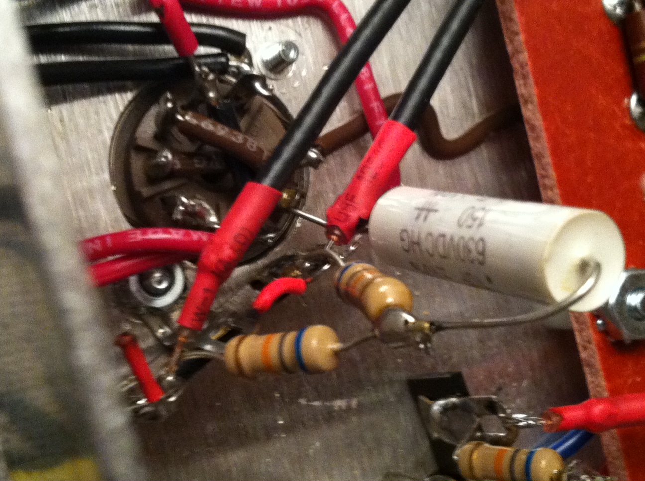

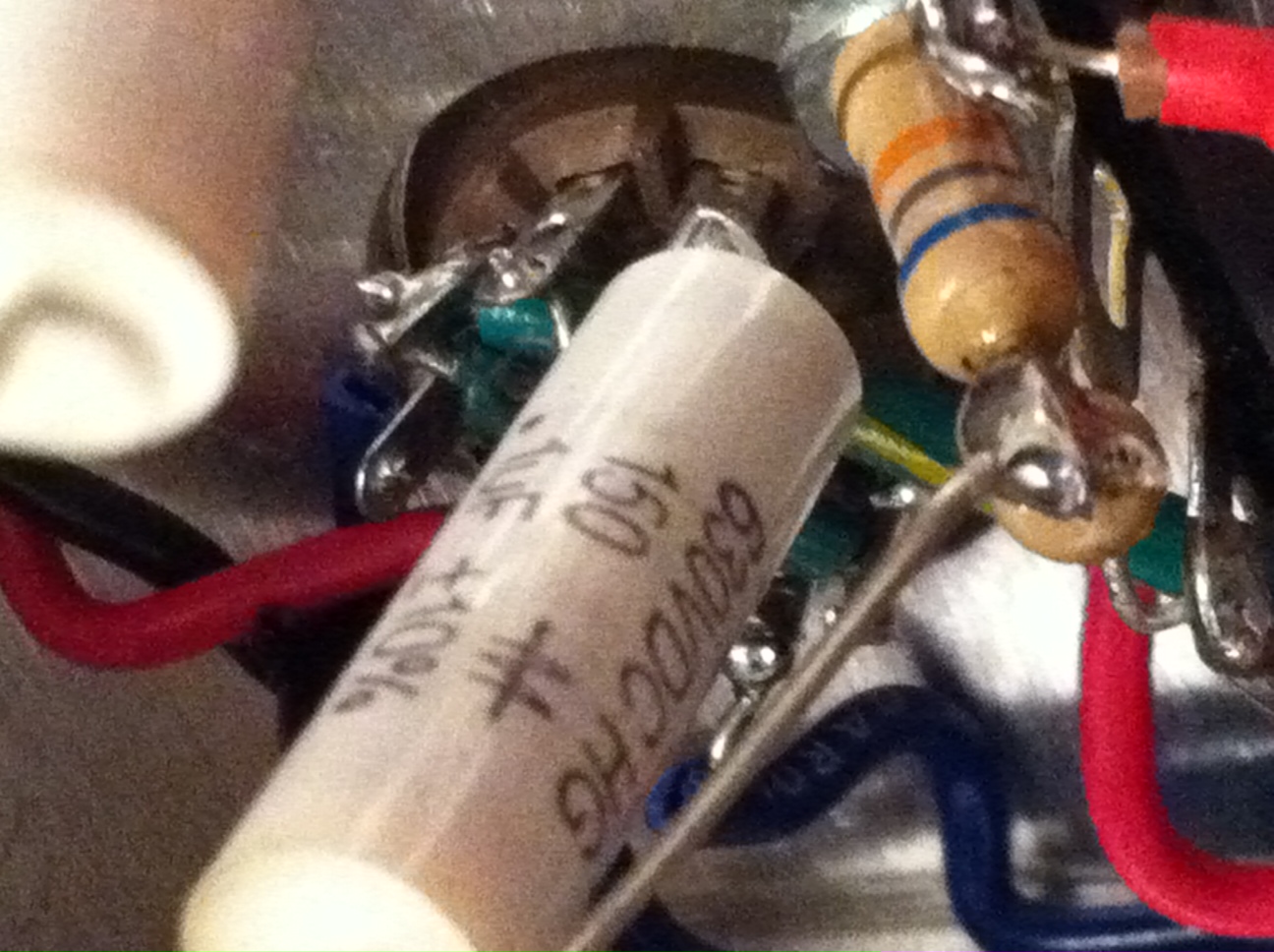

Stephen, here are the pictures of the 68 k resistors at the tube pins. please let me know if you think that could be the source of the noise. there is only noise when the VRM is engaged otherwise it is dead silent. thank you
File comment: EF 86 tube pins
File comment: 12AX7 tube pins
 Post subject: Re: VRM install help
PostPosted: Tue Dec 27, 2011 10:49 pm
What about the lead dress around the VRM control, can you snap a picture of that.
This looks OK, except for the 1M resistor.

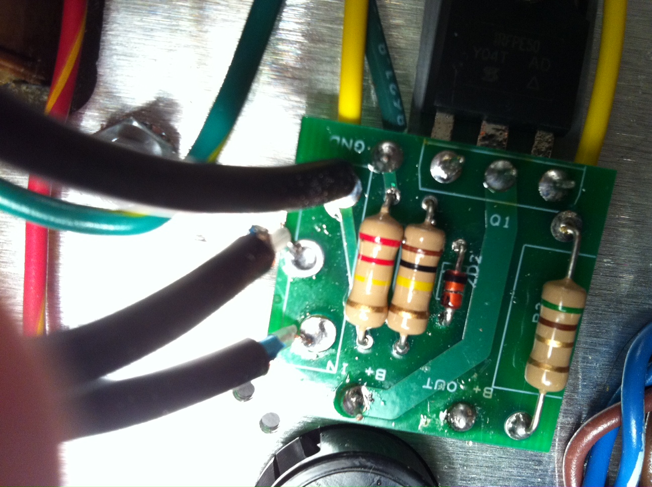

sorry it took me so long to get the additional pictures I have been swamped, and traveling everyday including weekends, anyways here is the pic of the VRM
PostPosted: Sun Feb 05, 2012 4:32 pm
All I can suggest is to braid the wires from the board to the control. They dont have to be shielded. I never do. Just use some 22Ga, twisted together or braided from control pot to board. How far away is the board from the control?
PostPosted: Mon Feb 06, 2012 10:40 pm
Joined: Fri Jun 24, 2011 5:26 pm
Posts: 14
the VRM is towards the back of the amp. but still close the transformer. I guess that is why I used the shielded wire. I will try to move the whole VRM rig to the front of the amp as close as possible to the Pot so that I can use a very short run of wire from the VRM to the pot. I will let you know how it goes, I know it is not supposed to be this difficult.
