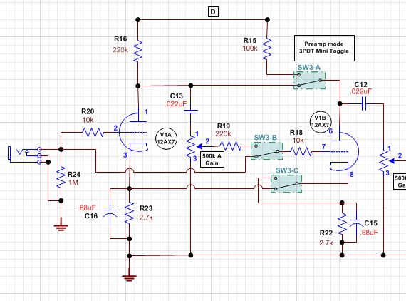

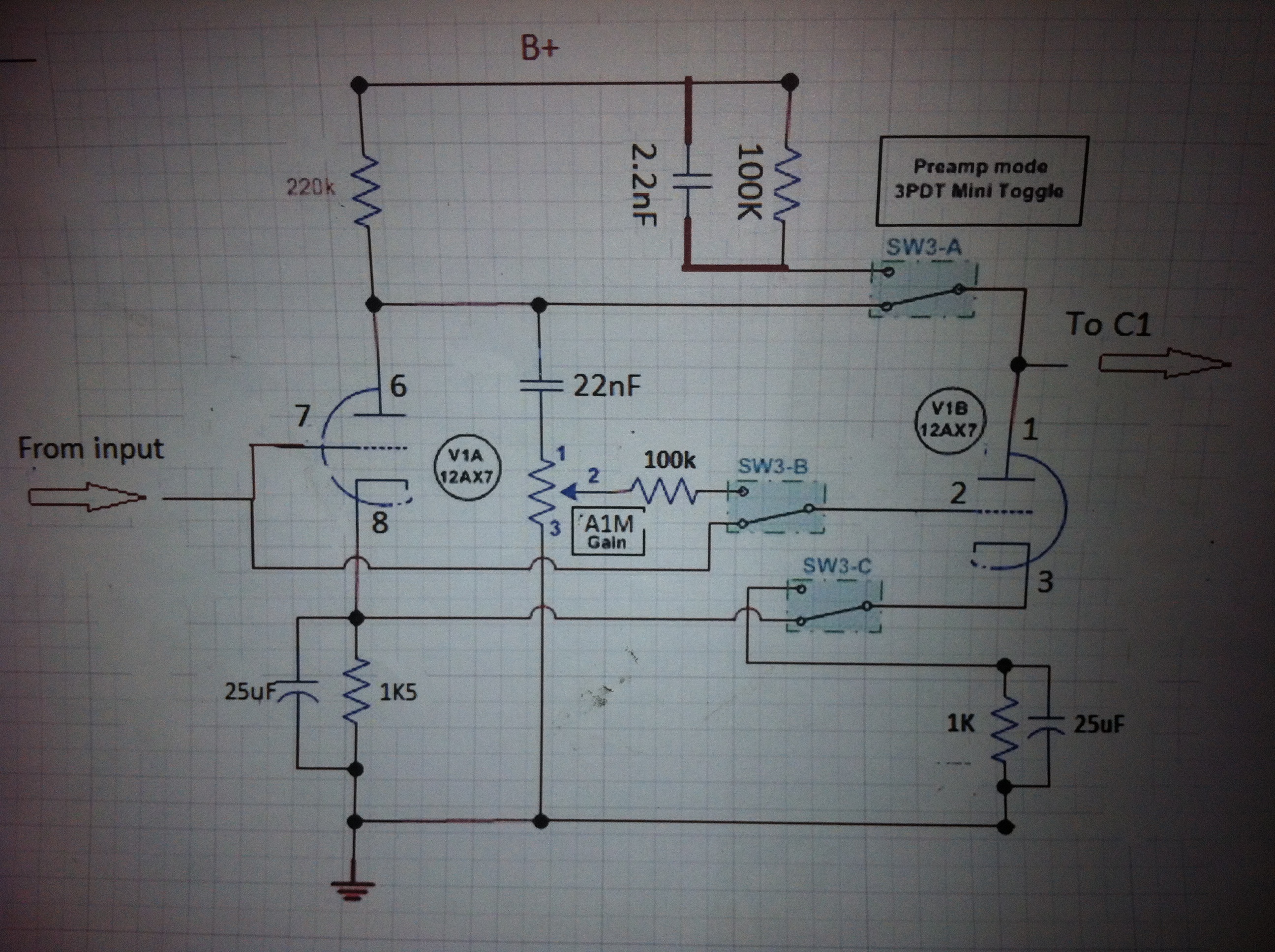

Hi, Following kurtlives schematic posted in a new TC is born, I've drawn up where I think I can get connections on the layout.
Not quite sure if i should take the B+ where I have...Any thoughts?

Take the B+ from the filter cap on the far right (the one with the 220K plate resistor on it).
I'll check switching when I get a minute.

Like this.....
The 22nf cap, 680K, R1 & R2 seem to be in circuit at all times. Do these have any effect on the parallel mode?

Switch wiring is not correct. Check pin 1 against my schem. (you might need to add an extra eyelet)
It's close but it looks like you mixed up some of the switch contacts. Notice which ones are common and which are the throws.

Also, in the sketch, aren't the 680k/R1/R2 combo serving as basically a static gain dump? These become redundant when you include the gain pot, if I'm seeing this correctly......with the 680K across pins 1 and 3 of the 1M pot, you're effectively converting it to ~400k pot & changing the curve a bit. This isn't necessarily a bad thing, but if you're looking for the frequency response & curve of a 1M pot, I don't think this will get you there. Here's what I came up with for one of my amps.......very much based on your original diagram. Many thanks for posting it. My amp is much different than the TC-15 so the resistor & cap values don't apply here.....but the topography is very similar.

Sorry, I've missed the B+ supply to pin 6 when in cascade mode. Not sure where I need an extra eyelet.I've moved the B+ supply from pin 1 to pin 6. Bobo, I had a quick look at your schematic. Thanks for posting it. Looks very similar to what I'm trying to get. What about the 500k gain pot in parallel mode, does it lose any gain because of it?

Your close!
- Cathode switching is correct
- Grid switching is not correct (look at where the you have pins 2 and 7 mixed up essentially, study the schem)
- Plate switching is not correct, you got some of the lugs mixed up

Right, here's what I've done. It works perfectly! 8) I didn' use an extra eyelet (would've been handy if I had one!) Changed Gain pot to 500k. A1M overloads the amp! fitted pot on front of amp with a black knob, looks angry! Massive amount of distortion available but can also do clean if the gain is dropped off. Different sound to parallel clean, less warmth but quite useful. Distortion gets a very convincing whole lotta love type sound right up to ACDC.
