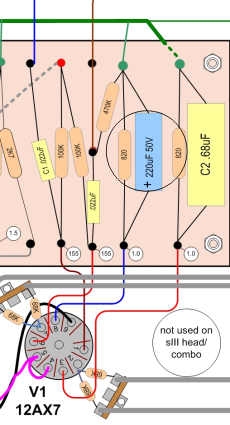

Can I use 16v cap here?
PostPosted: Sun Sep 25, 2011 5:37 pm
Yes, cathode voltage is only 1 V or so.
