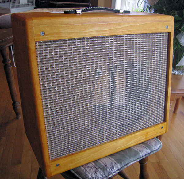

Here are a few pics of the aged blue white silver grill cloth I have just received. I put it next to my cabinet to see what it would look like. I have never seen such a cloth color/cabinet color combination, but I like it.

Nice looking job Gotie,
The Silver cloth looks better than I would have thought, TBH :thumbsup:
I still like the "earthy " colors on natural woods, but what is important is that you like this and it represents your vision of how your cab should look. That's what DIY is about.
I am looking forward to seeing the finished cabinet.

Thank you Casey. Here are two pictures taken today of the finished cabinet, minus the speaker and amplifier.
Edited to say that the grill cloth is a little off horizontal in these pics. This has since been corrected.

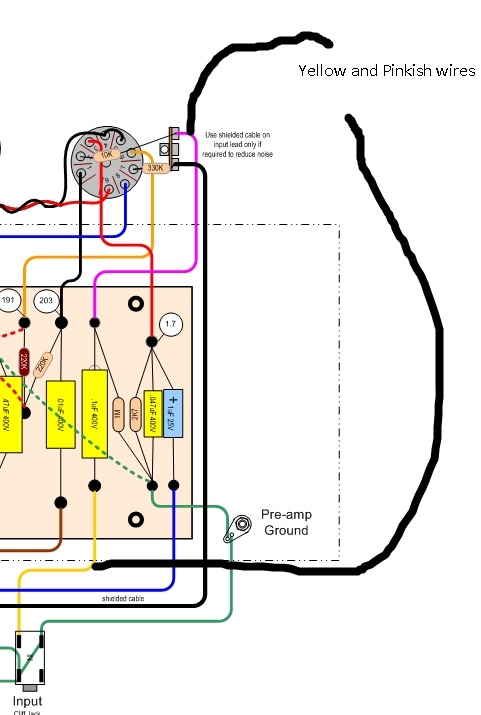

Slowly working on the tramp kit, but have a few questions. In the attached pic, my drawing shows the yellow and pinkish wires, that I have indicated with a black line, as black shielded cable. The drawings I received obviously are out dated. The pic is of the latest posted drawing. Which one is correct.
PostPosted: Wed May 25, 2011 9:59 pm
Those wires are now shielded.
The amp will work either way but the shielded cable will help with noise and make the amp more stable.
PostPosted: Wed May 25, 2011 10:11 pm
Posts: 31
Location: Manitoba
Thanks kurtlives. So the tramp drawing that is posted in the "tramp resources" is an older drawing?
PostPosted: Wed May 25, 2011 11:08 pm
Shield the line from the input jack to the board. The other to the terminal strip is less suceptible to noise.
Use this updated Layout (now shipping with all kits)

Oops, I used unshielded wire from the input jack to the board. :oops:
Works fine though and I don't find it noisy.
The sound coming from it is so good and musical that once I start using it I don't want to stop.
May I leave it like that or should I change the wire for a shielded one?
Its working fine and you like it, leave it. Its not critical to operation. Mines the same, although the cfls in the area are shut off when we play as they add noise to everything.
