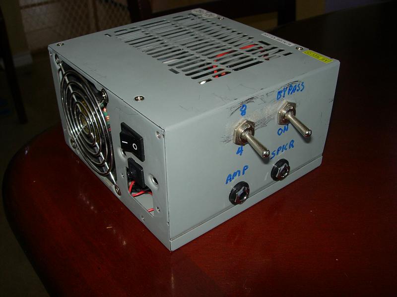

I've been looking into building an attenuator. Any chance of seeing the attenuator schematic?
** b0b0 **
- This Space For Rent -
 Post subject: Re: New Plexi Build
PostPosted: Fri Mar 18, 2011 1:52 pm
Posts: 226
Location: Dallas, Tx
This is the one I built. http://www.regiscoyne.com/coppertone/ Mine is not as pretty.
The schematic is on this page. http://www.regiscoyne.com/havanatone/ Scroll down toward the bottom for the schematic.
The main part is the 100W Stereo LPAD which I got from Parts Express.
http://www.parts-express.com/pe/showdet ... er=260-264
Here's mine.
Les
PostPosted: Fri Mar 18, 2011 4:44 pm
Posts: 126
Using an old computer power supply case & fan is a great idea. One thing concerns me a bit about the schematic.....the switched jack on the spkr out. If the unit is set to bypass & nothing is plugged into the jack, wouldn't it be a dead short to the amp? :shock:
** b0b0 **
I guess it would be but just like the amp I would never run it without a speaker plugged in.
Les
