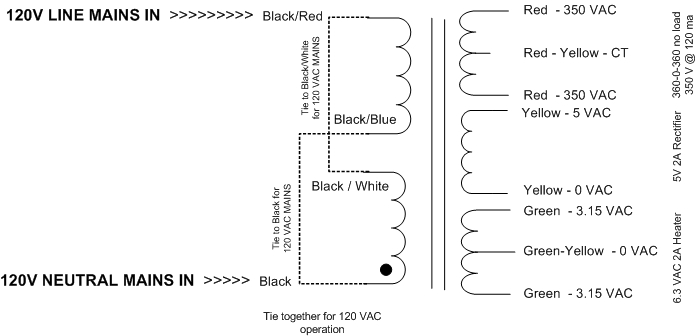

On the Tweed Power Trasnformers, there are 4 Mains leads. We have actually moving to this for all our PT now. There are tow primary windings
120V PRIMARY CONNECTIONS
120 V - use the primary in parallel hooking Black/Red to Black/White and Black to Black/Blue
Connect 120 mains across Black/Red and Black.

So, to put this in layman terms, I would tie both the black and the black/blue from the PT together, and connect these to the white (neutral) coming in to the box?

That's right. Slide a piece of heat shrink tubing over the black and black/blue pair before connecting to the white and then slide the tubing over the joint and shrink.
