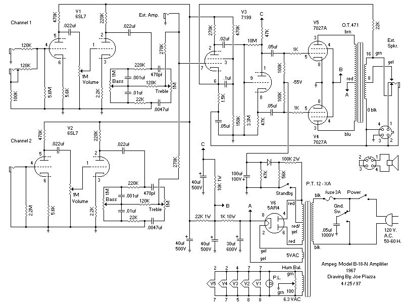

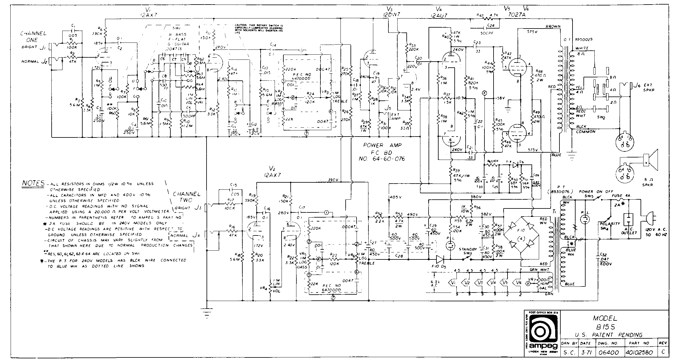

Doing some research and there are a lot of B15s versions out there. Just curious if there is a particular circuit that is considered the best. What one do you have?
So far:
B-15-N 1962
B-15-N 1964
B-15-N 1968
B-15-NC
B-15-NF
B-15-S
... and then there was a B18-N ...
B1-18-X
