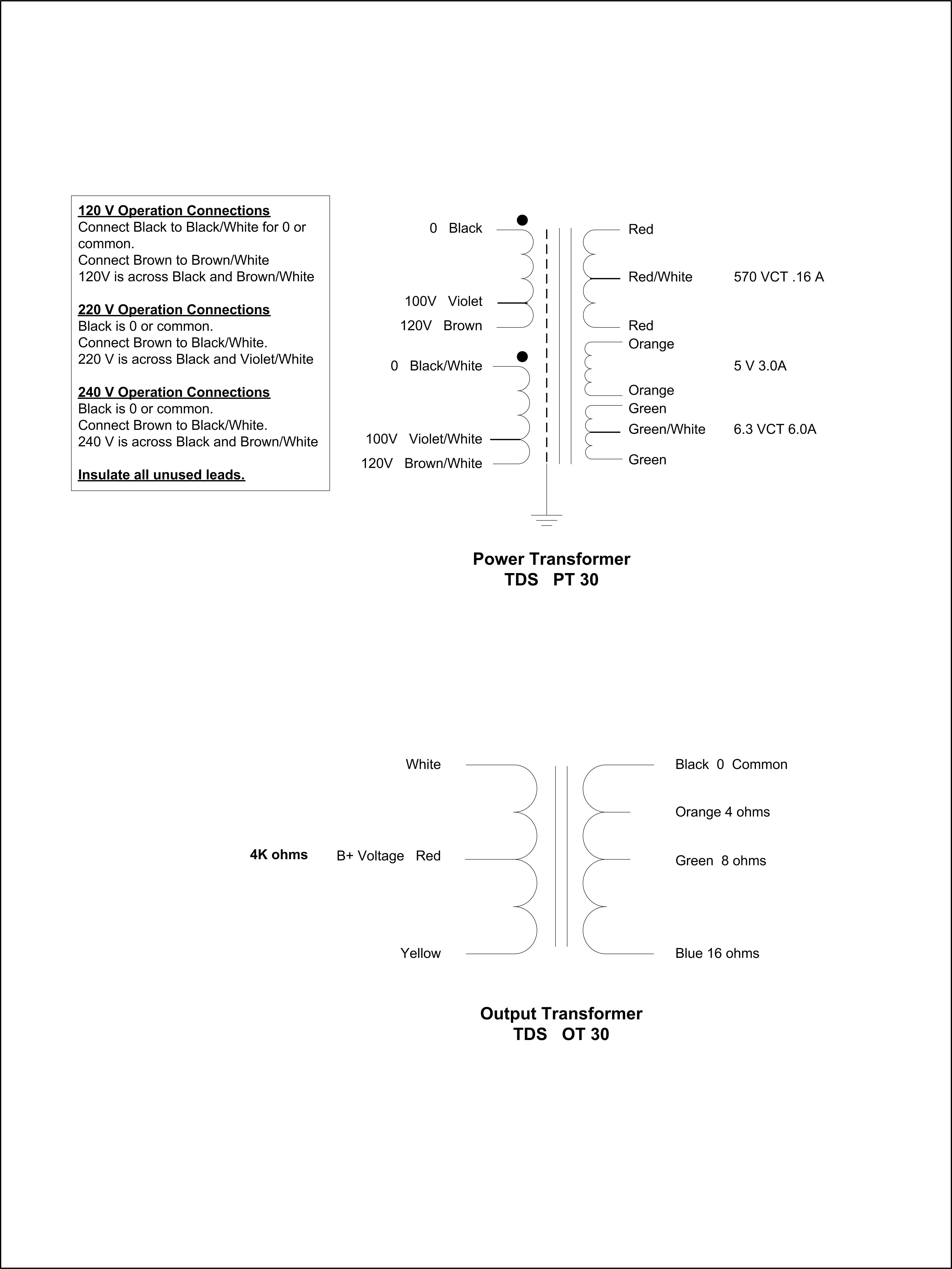

I bought a set of transformers from Dave West about twenty years ago, as yet still unused. I don’t remember if I bought a 15 watt or 30 watt set. Does anyone here know the part numbers of the transformers for each set? I can’t find my choke but have the power and output.
A Connection diagram would be nice, there is one on this forum for a West power transformer but no part numbers and no diagram for the output.

We got ours from TDS Transformers. They actually made them for Matchless. TDS15 & TDS30
We have this West Labs info:
They should be compatible.
The 15W powers West was selling here looks identical to many TDS made for Matchless in the past. These are different dimensions than the ones we had. You can tell these are not TDS because of the stickers on them.
