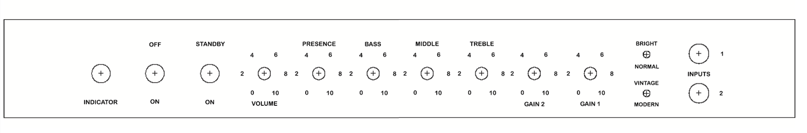

Looks pretty good from here. Plates cost about $60 unless a local engraver can do it for less.
I dont think that panel matches the schematic labels, does it? Maybe we should synch them, or have you just moved on and done more? I see presence which we didnt do and I'm guessing feedback & cascade switches, but I cant read the labels on the pic.

I have done more. Here is the faceplate template:
The Vintage/Modern switch switches between the Plexi(1959) and JCM800(2203) modes. Basically just a cascade switch. Gain 2 is only available in Modern mode. Here is my latest schematic: http://www.unimind.us/images/18_PLEXI_800_Schematic.jpg .

Damm I Thought you'd have the face plate go to 11 :D
