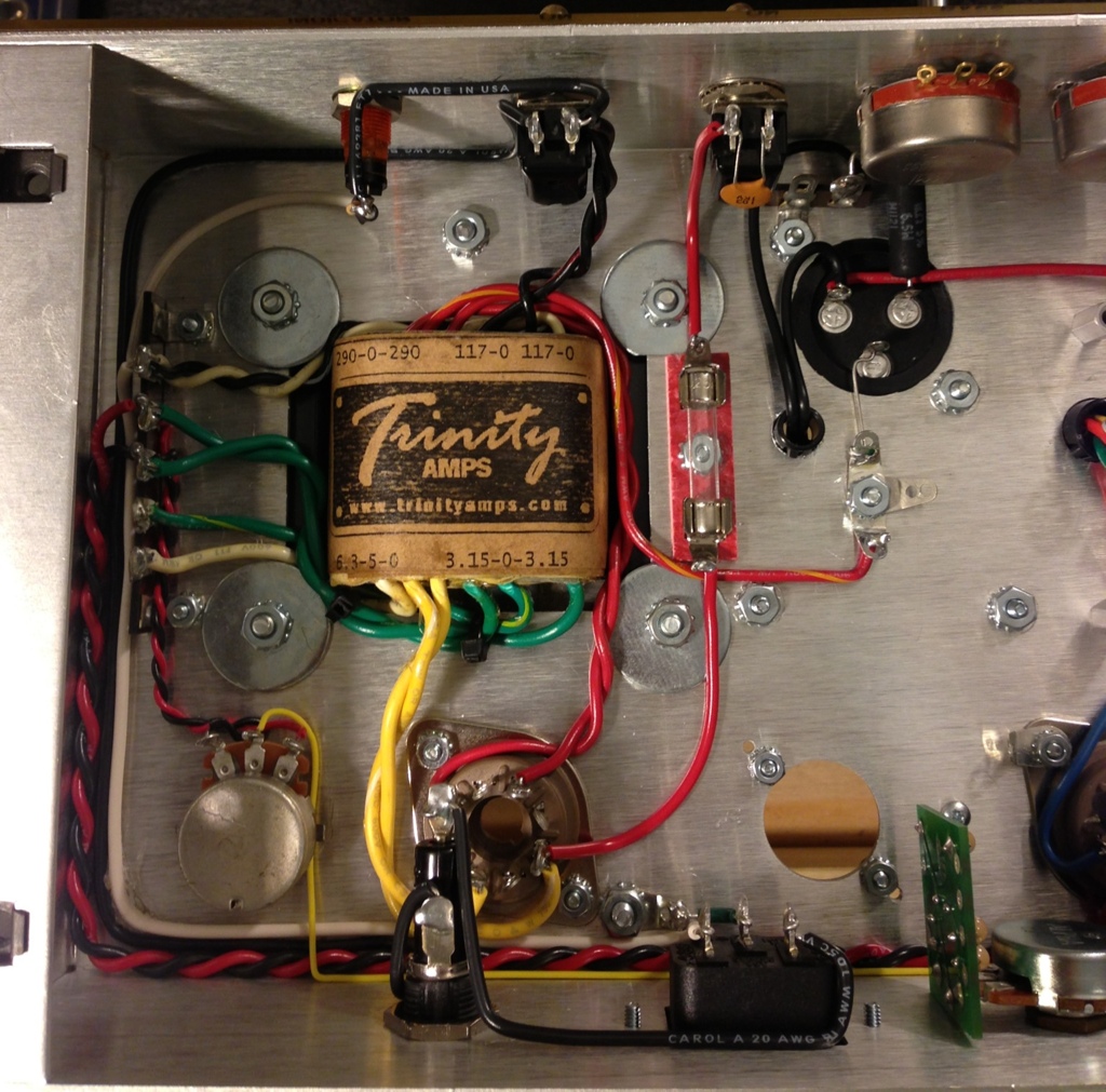

forgive me...i'm reading a lot here...i think i am following most...but here starts the questions...
1. more of an observation than a question...revisiting the wiring...i am thinking my heater wiring past the Power tubes needs to be re-done...not quite as tight as the rest of the pictures i've seen online...this is the first picture...i'm going to have to track down some new wire...i don't have any left...or...should it all be redone?
2. i'm following your schematic for the heater balance pot...so...i take a 2W 200k pot...and tie into the heaters...then...you said send it to ground...which would be presumable a close tie in...why, may i ask, did you take it to pin 8 of the power tubes in your 20W?
http://i0.wp.com/pdfelectronics.com/wp- ... atic_0.jpg?
3. elevate the centre tap...ok...so right now...the centre tap is wired to the terminal strip and goes nowhere...the 0V green w/yellow stripe...if i understand that 'the valve wizard' site is saying...if i actually ground that wire...it should help with the hum? can it be tied into the 'power ground' lug or should it have its own? (revisiting my amp...that wire is already grounded...as per the schematic to the power ground lug)

 Post subject: Re: tracking noise...
PostPosted: Thu Jun 20, 2013 7:53 pm
Posts: 138
Addendum...the only thing different about my centre tap being grounded...I out my bleed resistor on the same lug...

PostPosted: Thu Jun 20, 2013 9:23 pm
1. That's more than tight enough
2. 2W 200R (ohms) not 200K! Yes you got it right there. I took the wiper to pin 8 of the power tubes becaue that is heater elevation. The wiper of the pot is the same as the centre tap here. And just like can take the CT to a voltage for heater elevation you can take the wiper of the pot to a voltage (cathode voltage of output tubes) for heater elevation.
3. The green/yellow wire should already be grounded if your amp is built stock. For heater elevation you take that green/yellow to a voltage for heater elevation.
I think the fact that I added a hum balance pot is throwing you off here.
PostPosted: Sat Jul 13, 2013 8:40 am
Posts: 138
here are some some guts shots...
https://www.dropbox.com/s/lx0akegia9...712_064758.jpg
https://www.dropbox.com/s/esy02pr1cs...712_064901.jpg
https://www.dropbox.com/s/oo4k0xrd25...712_064811.jpg
https://www.dropbox.com/s/jxrk5xmwwt...712_064805.jpg
it was prettier...but in try to track this down i've re-wired a couple wires...
to re-interate...nothing is plugged into the jacks...the phone was about 8" from the cab and VRM and vol/gains at 3 oclock
and i am talking about both of those noises...the hiss right now is whats driving me nuts...
