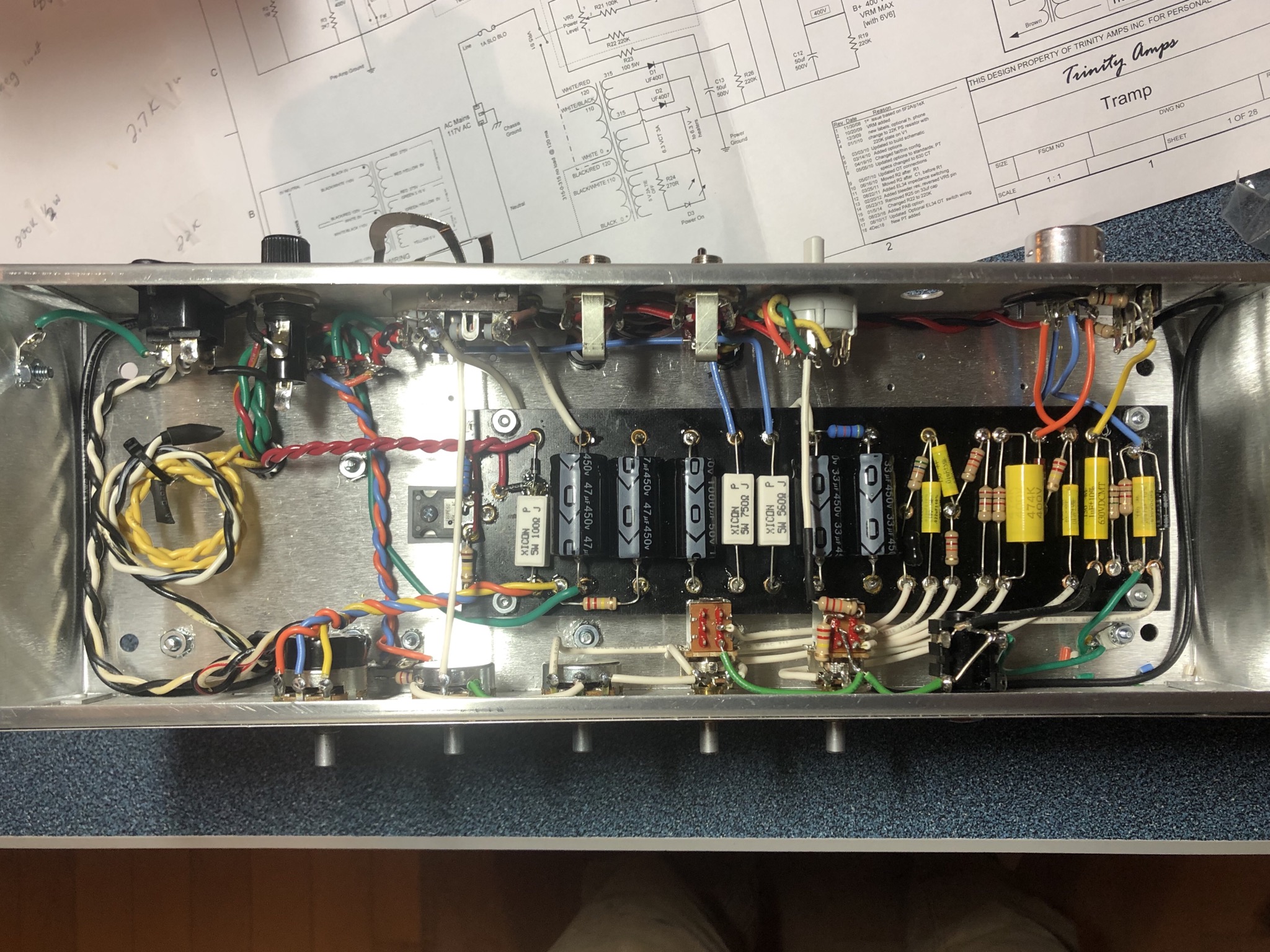

All wired. Now double check everything.
PostPosted: Tue Dec 03, 2019 1:16 pm
Looks good, I can't see it in your final photo, is the blue jumper there between eyelets 3 and 2 on the Bass control? and thanks for the gut shot , always good to see other people's wiring style. Always looking to improve mine :!:
PostPosted: Wed Dec 04, 2019 12:14 am
Posts: 38
Good eyes.
I just took the pliers & bent pin2 over to touch pin3, so when I soldered the wire on, all in joined together.

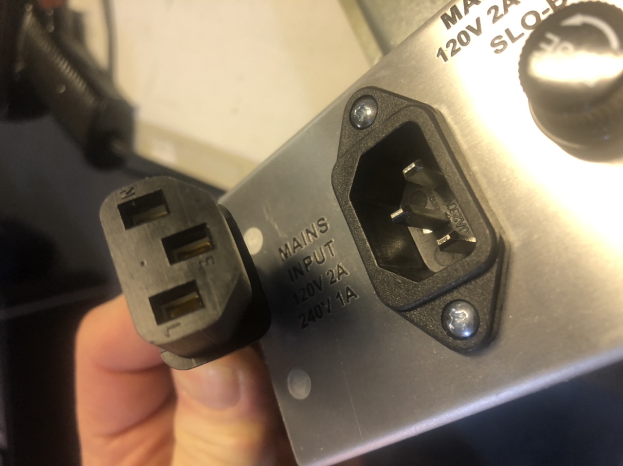

From the pictures, it looks like you've put the fuse on the neutral side of your mains connection, rather than the hot side. If I'm seeing that right, the fuse won't protect you from hot-side shorts upstream of the power transformer.
Does this match what you see in person?
PostPosted: Mon Dec 16, 2019 2:21 am
Posts: 38
You made me double check things, but it was correct.
The lettering is on the end of the input cable.
Scott

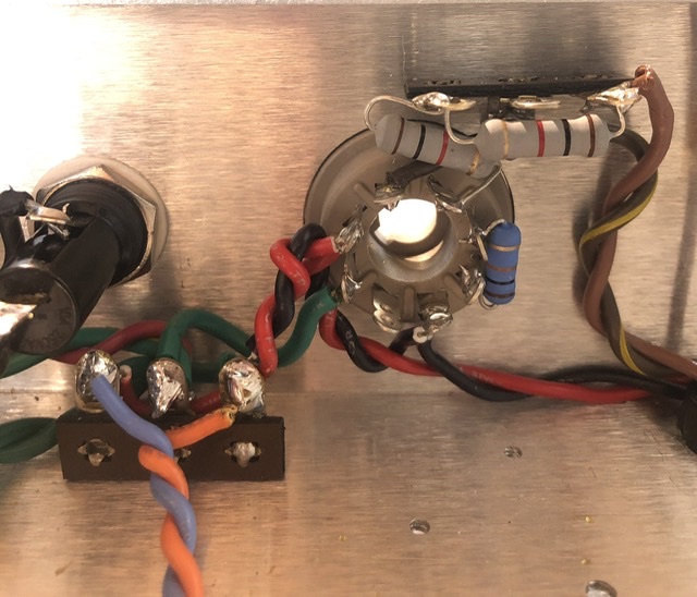

PostPosted: Wed Dec 18, 2019 12:17 am
Posts: 38
I was following the voltage, & before the 5k - 100ohm, 460VDC, but nothing after.
Could it have failed?
So then nothing would be getting to the VRM.
Scott
PostPosted: Wed Dec 18, 2019 5:46 am
The resistor could have failed. Does it still measure 100 ohms? It could also be a bad connection to the jumper that goes to the Mosfet.
