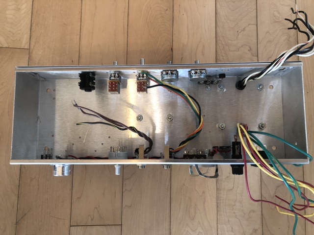

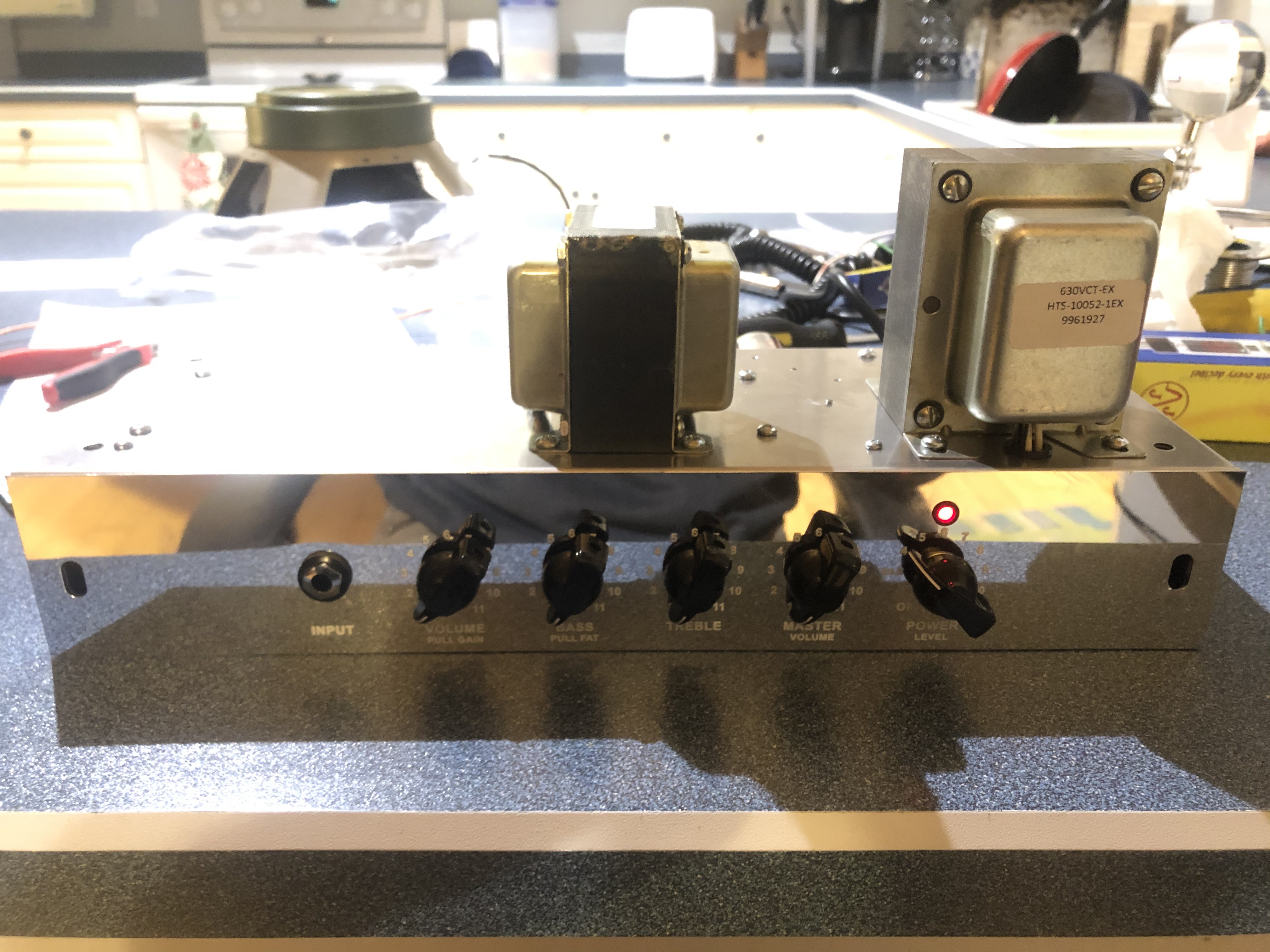

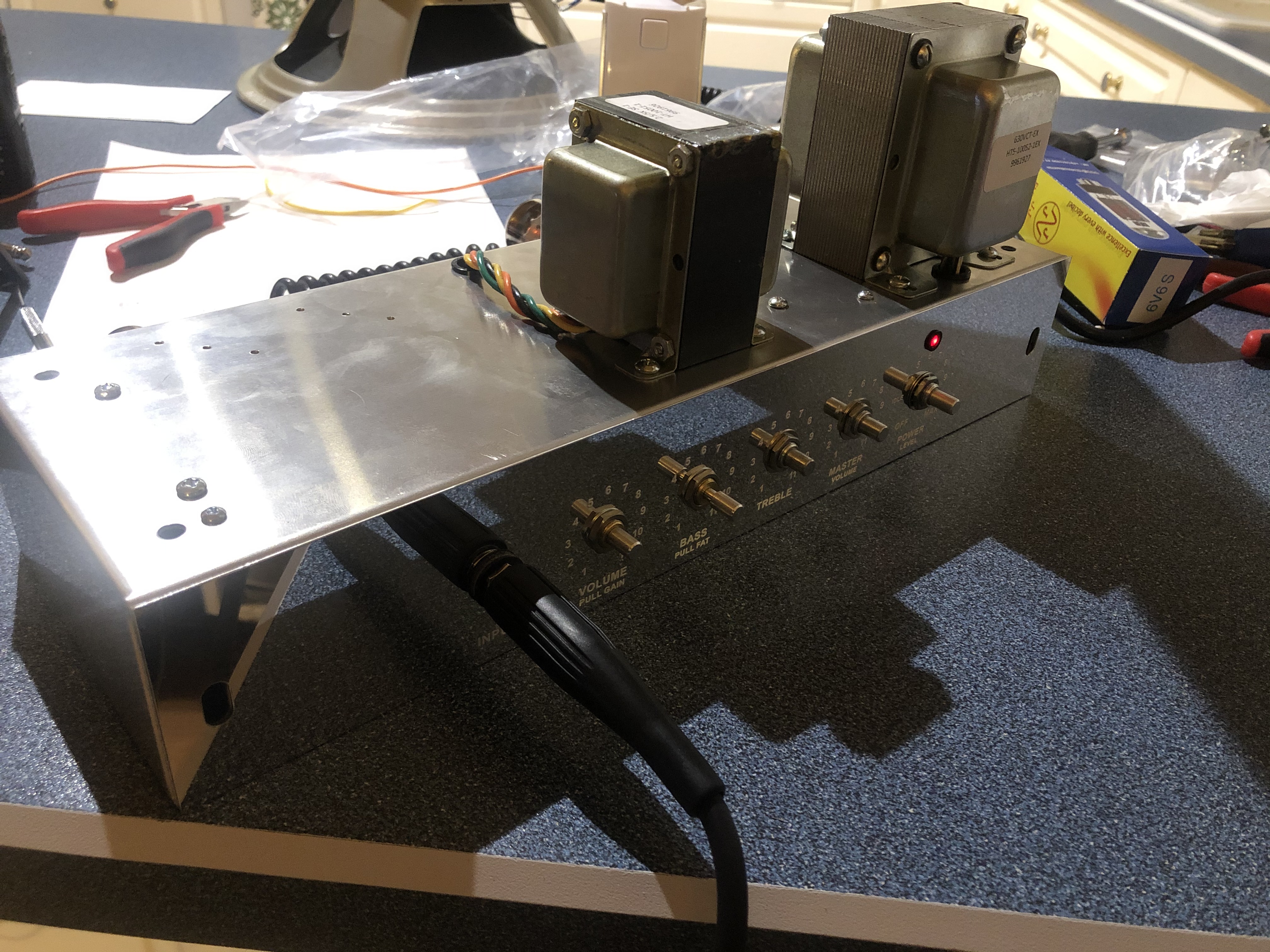

Coming along. Worked on it this weekend.
Wiring this evening.

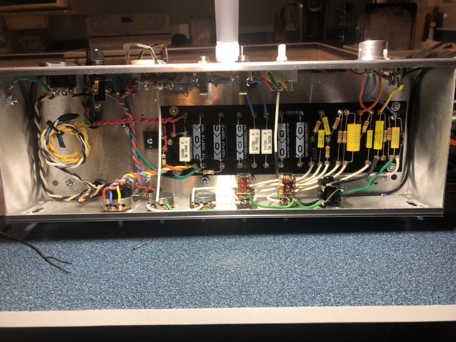

All wired. Now double check everything.
PostPosted: Tue Dec 03, 2019 1:16 pm
Looks good, I can't see it in your final photo, is the blue jumper there between eyelets 3 and 2 on the Bass control? and thanks for the gut shot , always good to see other people's wiring style. Always looking to improve mine :!:
PostPosted: Wed Dec 04, 2019 12:14 am
Posts: 38
Good eyes.
I just took the pliers & bent pin2 over to touch pin3, so when I soldered the wire on, all in joined together.

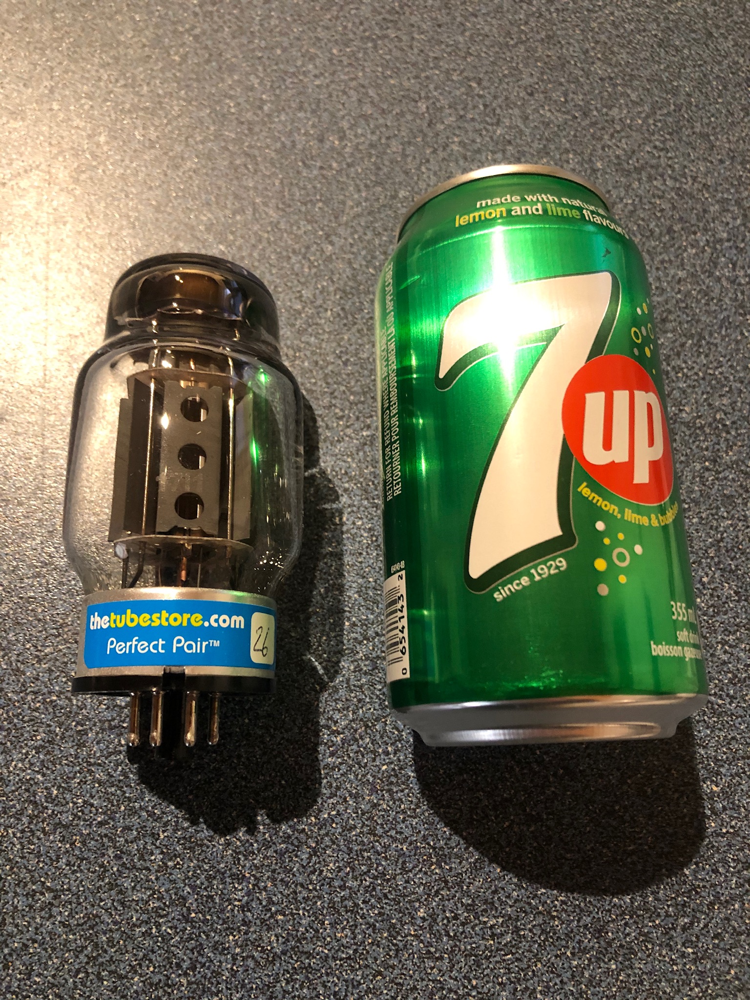

Got some new tubes to play with.
KT88

KT 88 works well in the Tramp, but you'll have to remove the supplied tube retainer clip (tube base too large), if you haven't already discovered that :(
