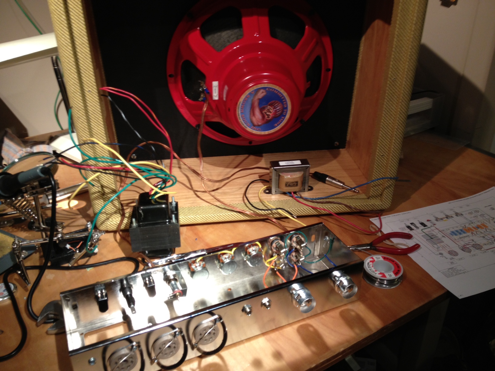

To test the image upload here is my first pic of the progress so far;
1) Hardware jewelry installed and some wiring started.
2) Cabinet drilled and Speaker readied.
Next is the heater wiring I believe.....

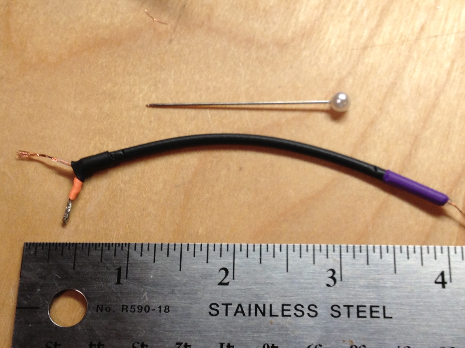

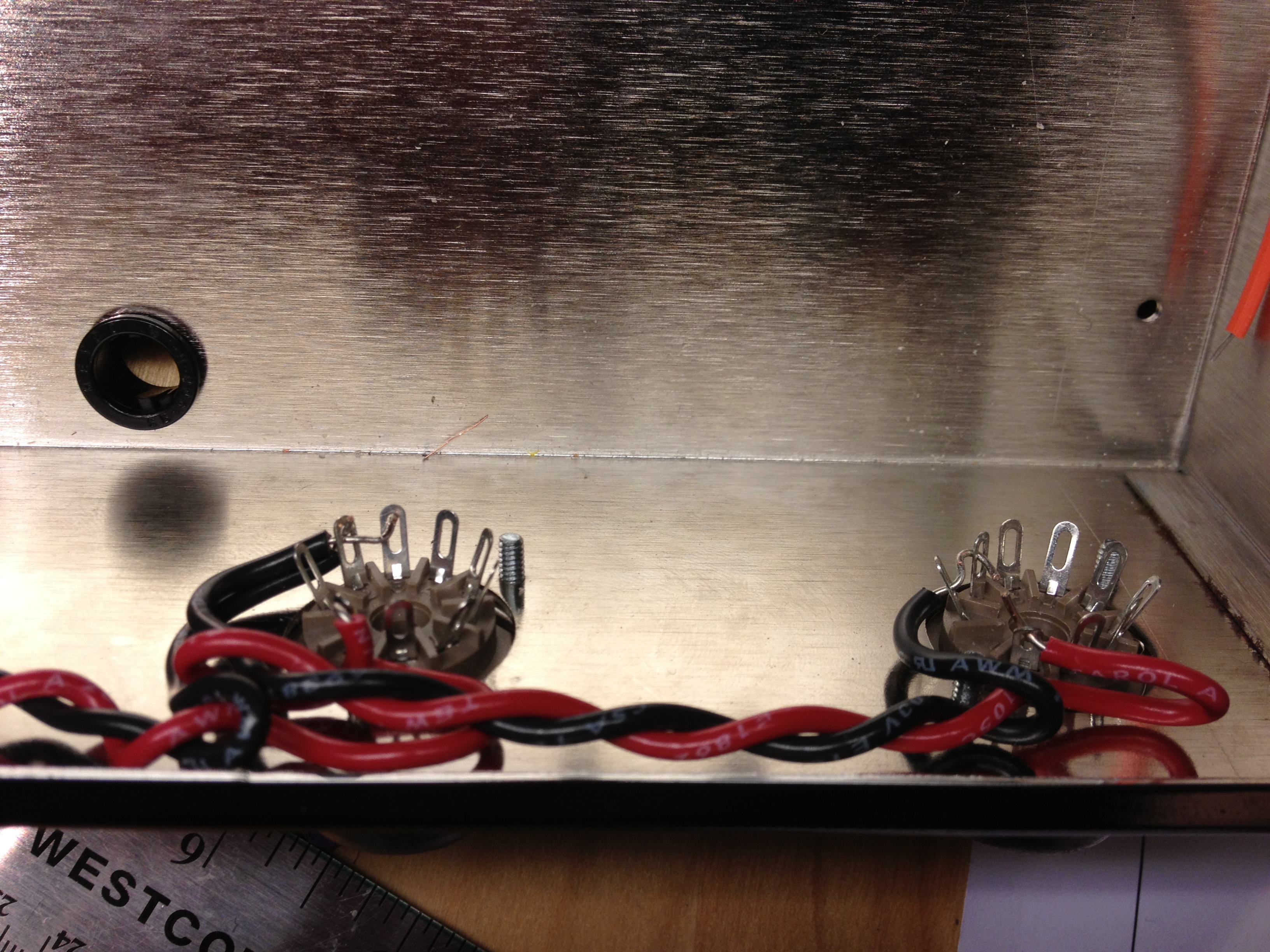

Thanks; I think I've got it now. Please comment on the images if I have screwed this up.
1) Heater wires complete; V2 gets juice from V3 pin7 (negative) and pin 2 (positive). V1 gets (negative) from V2 pin 2 and (positive) from Pin 9. Pins 4and 5 are jumped. Nothing soldered please let me know if I have this right!
2) Jumpers mounted not soldered.
3) special coax wire prepared not installed.
I found the actual placing of the wires somewhat finicky; difficulty ID-ing the right pin. Ok now time for scotch.

Jumpers aren't correct. Compare it to the attached pic.
I think the heaters are ok.v4 gets power from the light socket, v3 from v4 etc. There is no positive or negative in the heater voltage btw. It is AC volts.

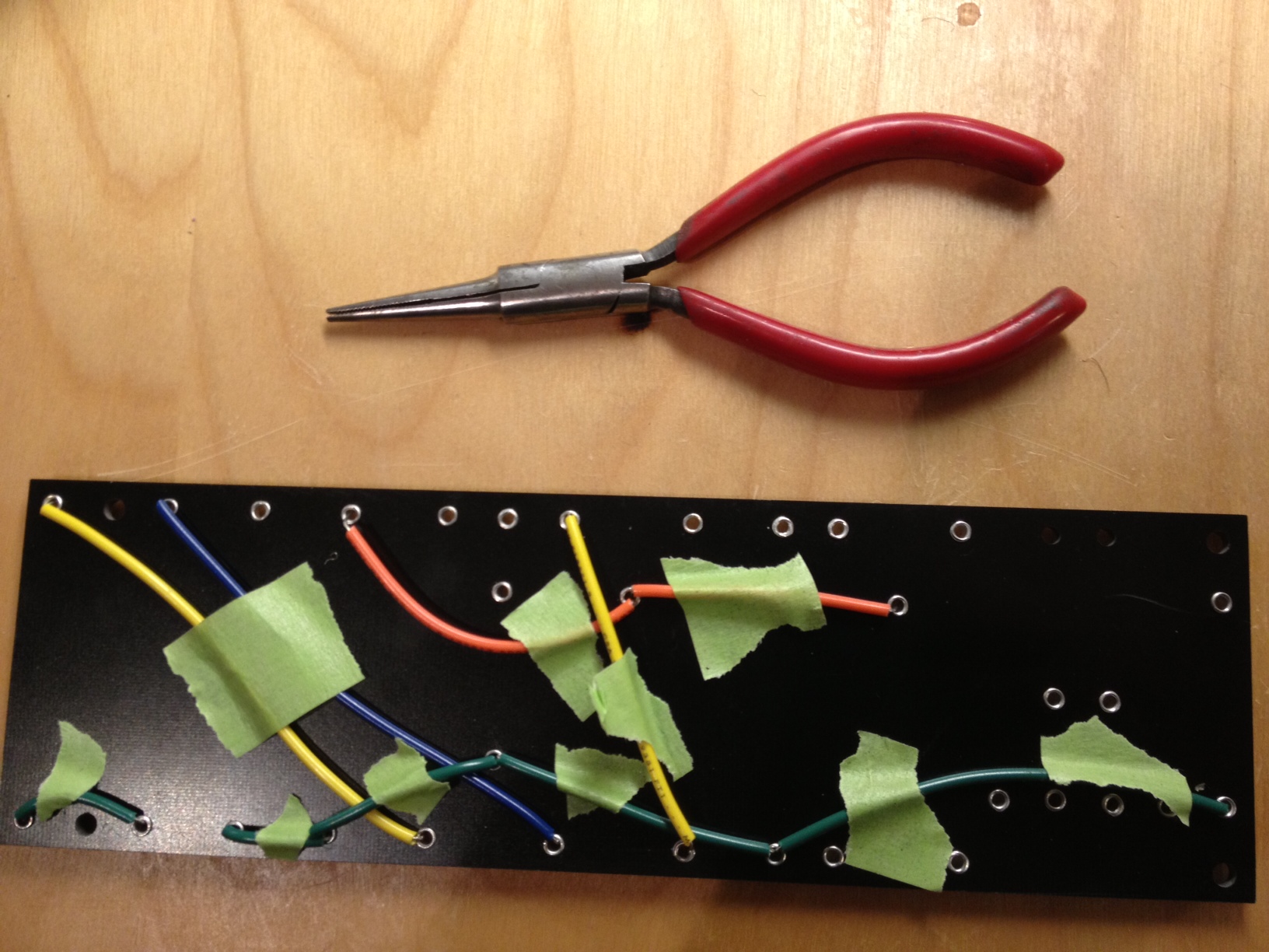

Yeah thanks Stephen; I had thought the two long leads were jumpers but when in fact they feed the power tubes V4 and V3 to pin 6. From the diagram it would appear the two leads don't make an appearance on the top side of the board and poke out from underneath near the 6V6 sockets.
Here is a pic of dry mounted board and now I will heat up the old iron....

That last image has a mistake with a resistor on the dry mount. Can you find it?

hard to see in the shadow, but it looked OK. Which one?

It is a good thing I am taking my time with this; double/triple checking so far it working to find errors; thanks for the tips and help.
The 4K7 and 22K ceramic resistors were in the wrong position. Luckily I had not soldered anything.

The resistors look like they are still in the same position (the right position).

Kurt: yes I may have confused myself, the photos do look similar but are now correctly positioned; I think I took the ceramic resistors out to bend the wires so there was more room for soldering as they are tight between the caps. At that time I then put them in backwards. :oops:

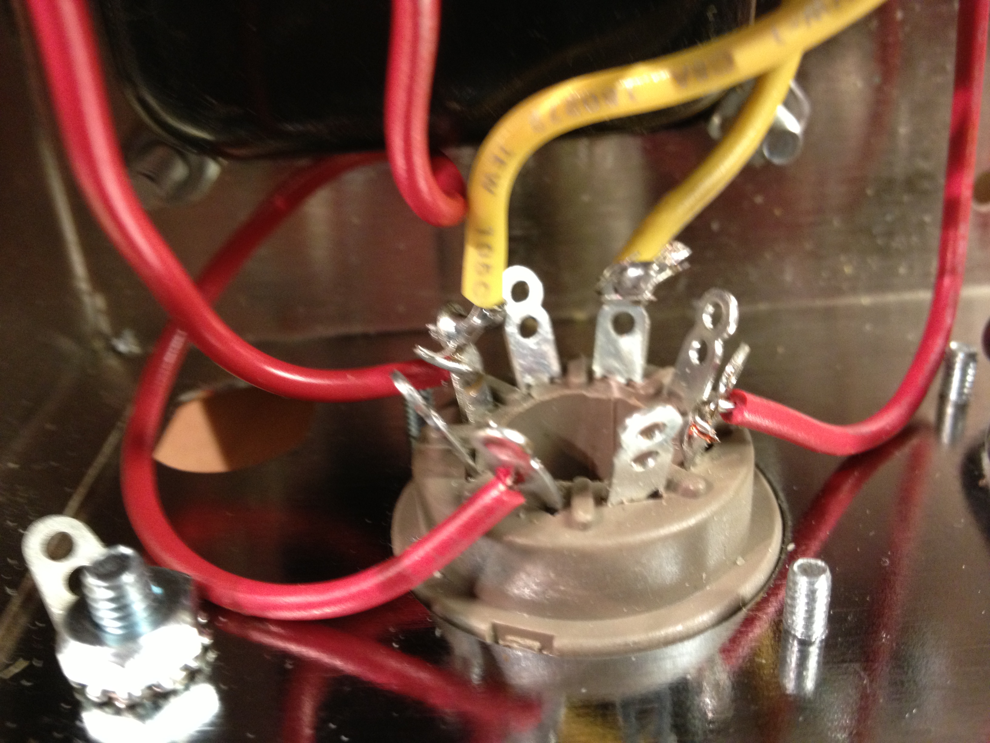

Question: If I am following the diagram both the black/white wire and the black/red wire connect to the live part of the power switch because they get the power from the main?
Question 2: There is no special order for the Yellow transformer lead to the recto socket. As in it doesn't matter which yellow lead is connected to pins 9 (B+) or pin 2. If this correct then why?
Photo of my Recto wiring. THX in advance for any help.

PostPosted: Thu Jan 03, 2013 7:06 pm
Strain Relief help - viewtopic.php?f=12&t=1296
The Black/white wire and the black/red wire connect to the SWITCHED part of the power switch because they are connected in series for 117V mains.
There is no special order for the Yellow transformer lead to the recto socket. It doesn't matter which yellow lead is connected to pins 8 (B+) or pin 2 because it is AC voltage and AC has no polarity.
Need to see the "keyway" in the tube socket to confirm it is wired correctly.

Sunday AM update:
Thing are really converging as now the transformers are in place and board is installed in the chassis. Next step is soldering the jack and pot leads to the board and doing the rest of the tube socket hookup. As you can see from today's photo I used little pieces of tape to remind me the destination of the flying leads. Other thing I have learned; I made some of the flying leads too short and had to resolder longer leads to give me more options for trying to separate the signal from heater circuits.

Muddy,
I inspected your hi res pic of your board. There are some suspsect solder joints. I suggest you reheat them all (use enough heat, they look like they are a bit "cold") and fill each eyelet with solder.
you might have some issues with the board with noise & reliability of you dont.

Hmm.. could be the lighting some appear shinier than others due to the angle of light. Some solder points on the board had the solder "crater" into the hole so they look different than the joints that "puddled" on top. Perhaps you could tell me which ones are suspect? Thanks.
A had a set back on Sunday :( as I discovered a mistake in the heater wiring pins for V1 and V2. Pins 9 for both sockets were Ok but where I should have had pins 4-5 I had pins 3-4 by mistake. I think i was thrown off by the diagram as my sockets are orientated 25 degrees different than the diagram. Maybe the diagram could use updating or maybe it is my lack of experience dealing with tube sockets on the business side. :damntech:
Before I resolder them perhaps a comment on keeping the signal wires out of the way of the heater wires. See my V1 setup.
