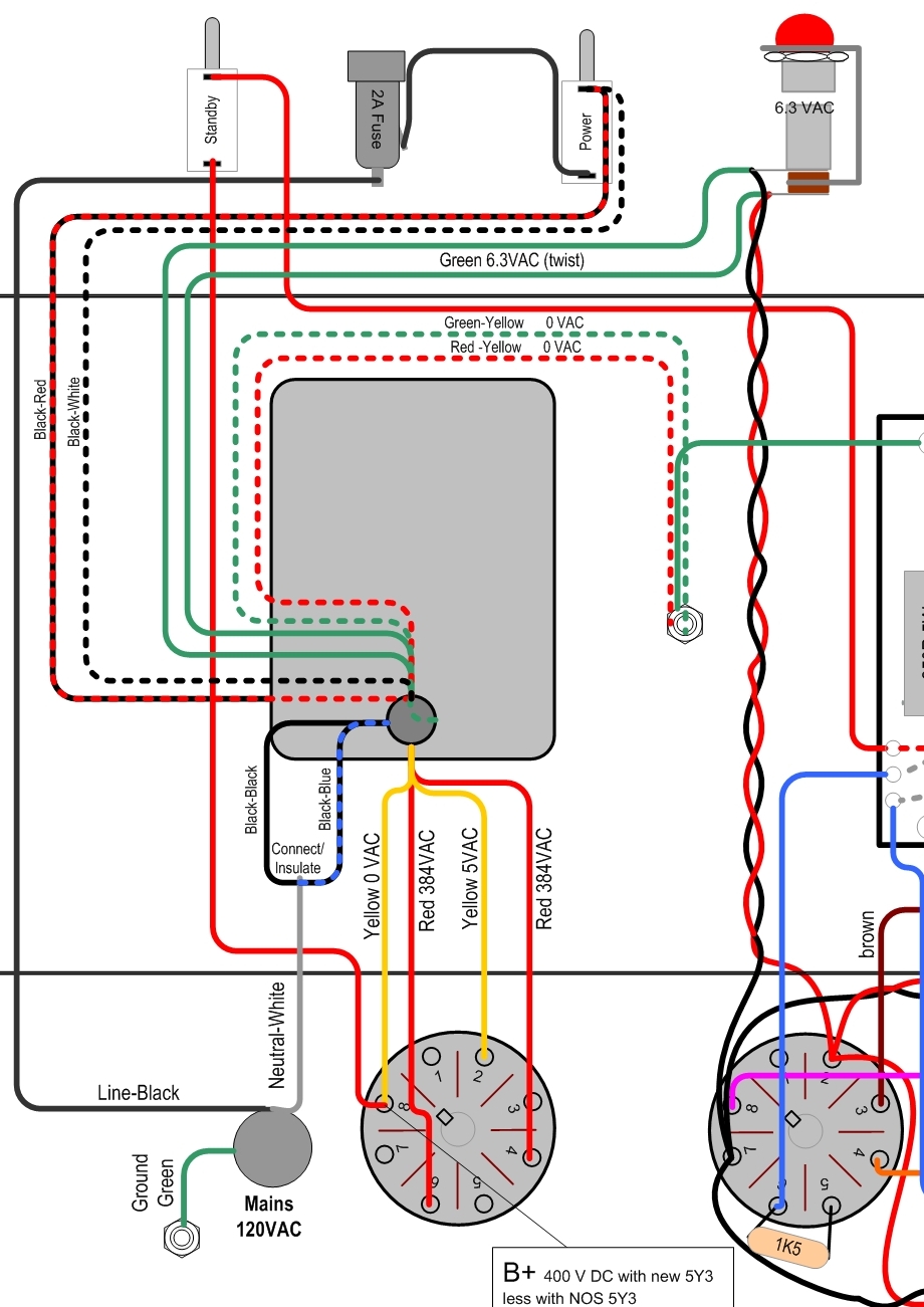

The voltages are off. 5VAC across pin 8 & 2 on the rectifier and 6 VAC across pin 4-5 and 9 on the 12 AX/AY. Check that and the AC volts across the Red secondary wires.
Maybe you wired the transformer for 240 volts?
PostPosted: Wed May 18, 2011 1:35 pm
Soory about any confusion, this is how it should be wired up.
PostPosted: Thu May 19, 2011 8:35 pm
Joined: Sun May 01, 2011 11:53 pm
That was exactly what I needed Stephen. The layout with the wire colours was perfect. I was able to confirm that I did indeed have my power supply wired correctly. I bought myself a decent quality digital multiple meter today and rechecked all my voltages. Here is where I am. In brackets is suggested values
