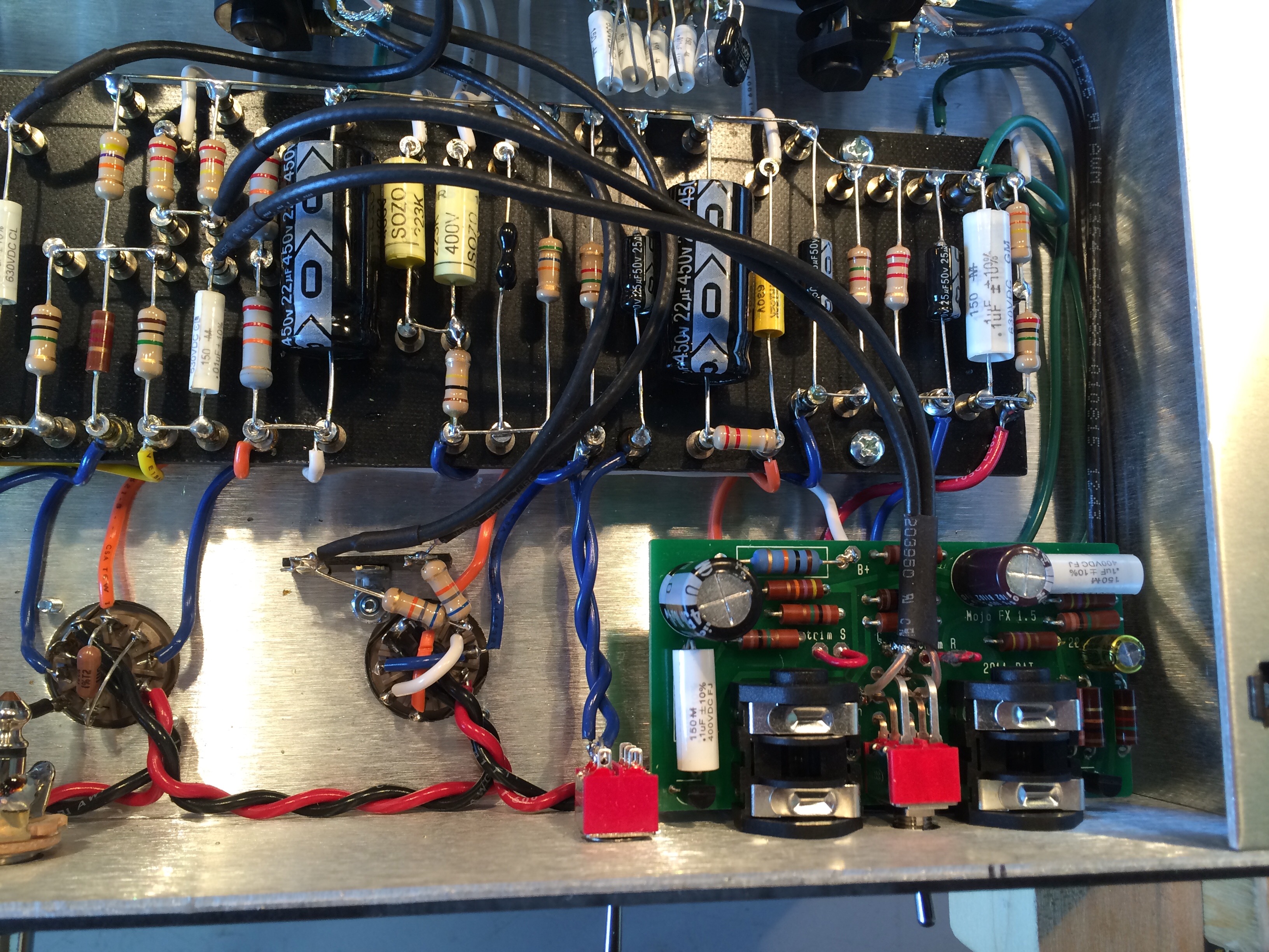

PostPosted: Sat Nov 12, 2016 8:22 am
Here is a picture of a TC15 with a Mojo effect loop installed.
It comes on channel 2 just after the 220K divider.
Power comes via same pream filter stage as the PI via the white wire from the 22uf filter cap.
Green ground to preamp ground.
Shielded cables used and were grounded on PCB board
Split the connection and run the Send and Return coax between the 220K and coupling cap as per picture.
We found the Mojo loop, which uses carbon comp resistors, to be noisy but otherwise it worked very well. Let is know how your works out. The Ironspunds installation looks more complicated than the Mojo.

Thanks Stephen! Your picture definitely helps! I see exactly where I need to insert the audio send and return.
Since the power section PCB is separated from the audio signal PCB (per Ironsounds recommendation), I might get my B+ from the 2nd 22uf power cap and ground to the 3 point power ground. But then again grounding might be best at the preamp because of the send/return coax wire ground will ultimately ground with the power section of the PCB. :hmmm:

JRS wrote:
Since the power section PCB is separated from the audio signal PCB (per Ironsounds recommendation), I might get my B+ from the 2nd 22uf power cap and ground to the 3 point power ground. But then again grounding might be best at the preamp because of the send/return coax wire ground will ultimately ground with the power section of the PCB. .
Suggest that you round at Pre-amp end, both the PSU and shields & loop board.
Thanks!! Makes sense, thats what I was thinking.
Since I am grounding everything at the pre-amp ground, I'm thinking that it makes sense to get my power from the pre-amp 22uf cap, like you did with the mojo loop....keeping my power and ground from the same part of the circuit to reduce hum
