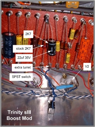

I put a boost switch in and I added 2K7 in parallel with V2 cathode plus a 22 uF cap across the extra resistor.
A 1 uf works fine, but accentuates the high end. 47 is also fine but allows a lot more signal through - good and dirty. 22 uf seems to be just right for lbet & my tastes. I'll see what others think in the coming week.
It's a switch tho, not a foot switch. That would be an enhancement I think, for some players anyway.
:?: I'd like to hear about people using foot switches. Did they use shielded cable? What kind? Did it add hum? Did they build the pedal themselves and how???
Pic showing sIII Boost Mod. Same value bypass cap as a Trainwreck!

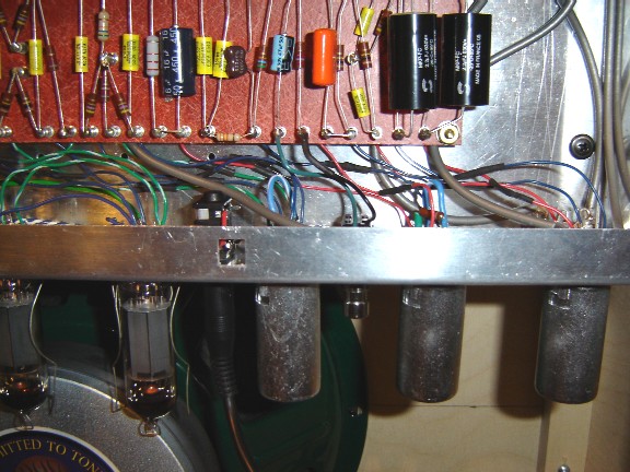

I have added the 47uf cap with a footswitch type switch mounted in the chassis between V2 & V3. Its a combo, so I can reach around the back and depress the switch to change sounds. I have a footswitch attached but, that's for switching between 6V6 & EL84's. I sent you a photo Stephen. I'll have to try differant values of cap and resistors but, so far I like the 47uf.
Edit by coco. Picture added.

PostPosted: Tue Jan 23, 2007 5:05 pm
On the above labelled picture, it says 35V but I'm sure 25 would work.

The layout shows a jumper and one wire going to the switch and the picture shows no jumper and two wires to the switch. :shock:
Which is it or which is better :?:

PostPosted: Wed Jan 24, 2007 9:01 pm
Posts: 148
Location: Mississippi
jac,
Either way is right. I used the layout version. The wire from V2 pin 3 to R9 can be tied to on either end by the switch. What the switch does is place an extra 2k7 resistor and a 22uF cap in parallel with R9. In effect giving a 1K35 resistor and a bypass cap. With the switch off the cap and one resistor are removed and you are back to 2K7.
LeeMo
PostPosted: Wed Jan 24, 2007 9:31 pm
Posts: 1078
Location: PA
Thanks LeeMo,
Using the layout version, it does not show which turret will attach to what on the switch. Which is hot and which one is ground.
Thanks again
Jac
PostPosted: Wed Jan 24, 2007 9:56 pm
Jac,
You're correct. The sIII layout doesnt show the connections. Refer to the v6 layout. It shows the connections.
viewtopic.php?t=763
Or just follow the picture above ^
