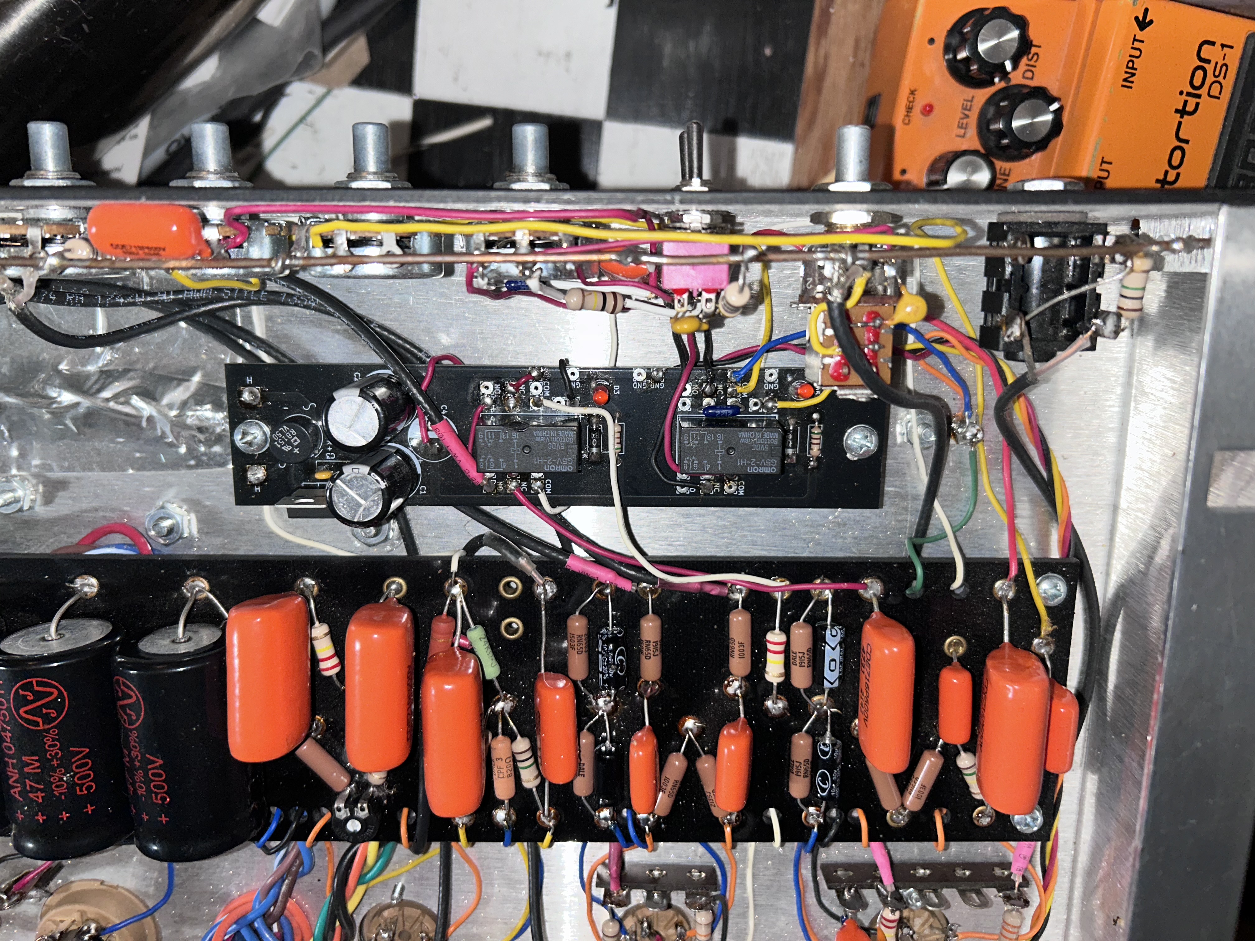

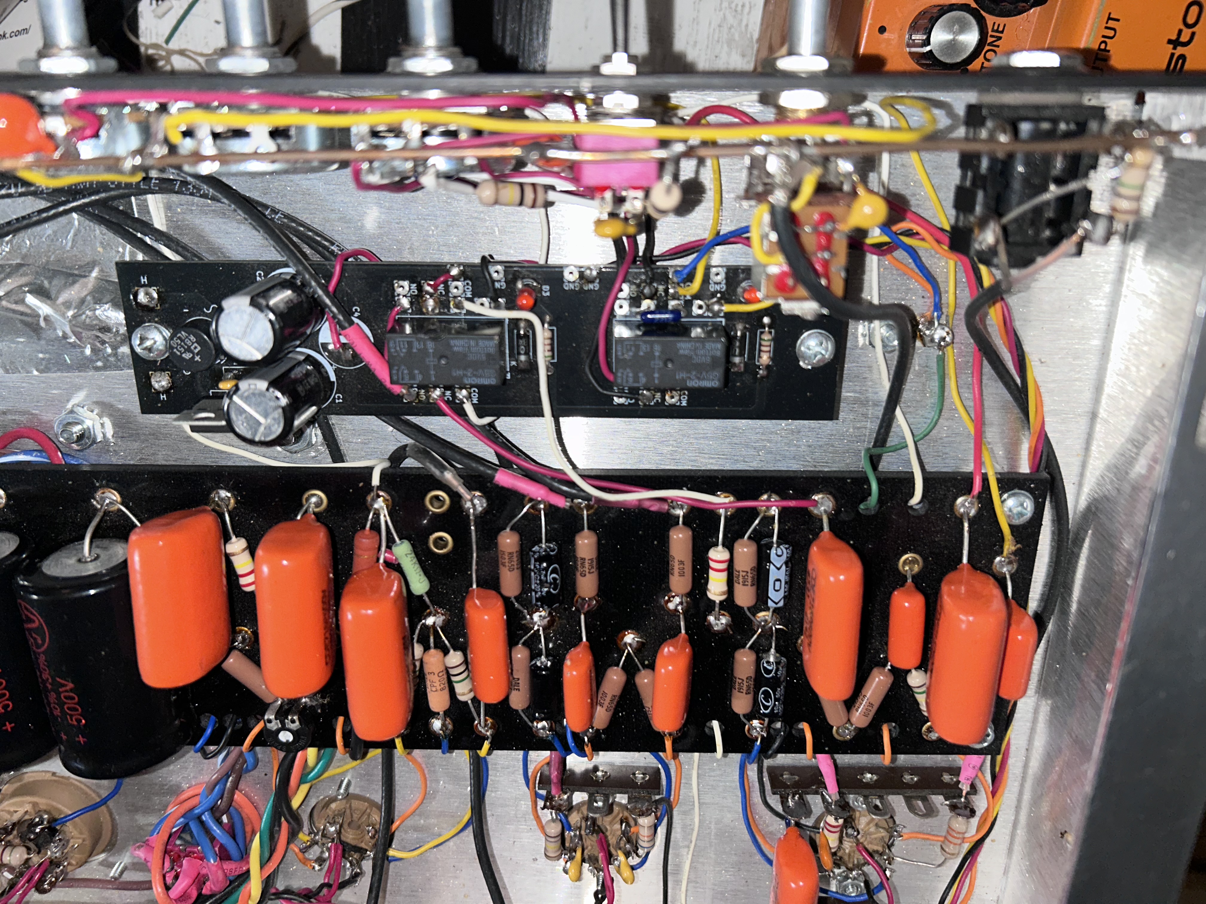

I built the Triwatt, TC15, Tramp all sucessfully and 30 plus other amps.
I got to startup testing and I had tubes in place.
Nothing but a little crackle is all I heard. Not loud. I heard guitar for a moment but not solid, kinda far away. Turning vol a little crackle, pull bright a harsh Buzz and lots of crackle.
Where do I start searching first?
I can add pictures soon.
 Post subject: Crackles pops new build.
PostPosted: Mon Dec 23, 2024 1:34 am
Posts: 30
Reflowed solder on the socket side of the board including all sockets
Turned it on and there is a sharp pop as it gets turned on.
Slightly tapping the input jack with 1/4” jack makes single loud pop too
Volume does change a little when turning volume up in master volume up.
Every potentiometer crackles when turned.

Well I couldn’t bias the amp and was thinking the bias pot was bad or writing writing but it turns out the diode failed that feeds into bias circuit.
Got some diodes coming.
But also the clean channel out without engaging the od is a bit weird. Very quiet but when when I engage the bright switch it is loud. Gonna have to figure that out next.
