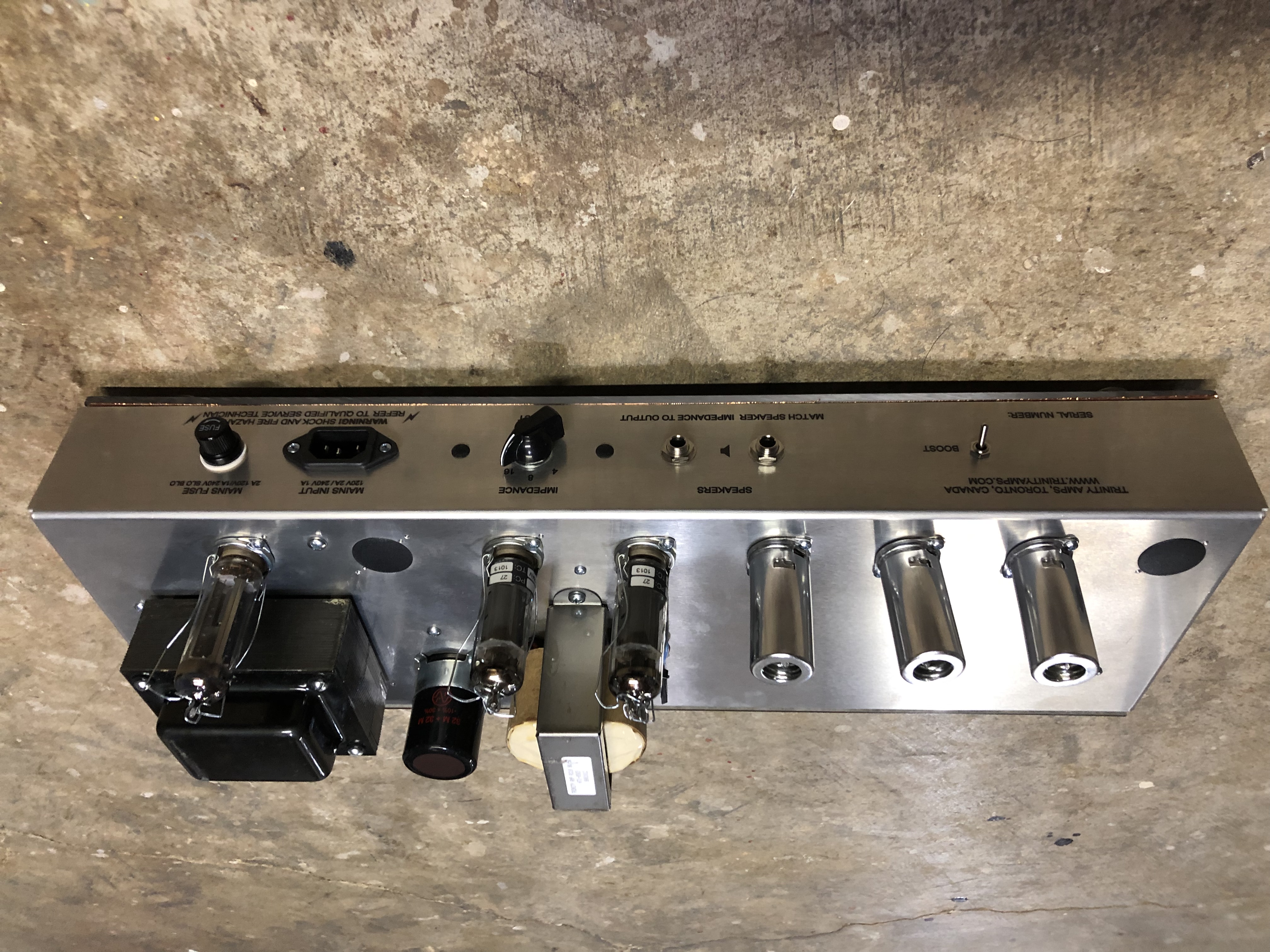

PostPosted: Tue Feb 19, 2019 7:11 pm
Posts: 91
Location: Ontario, Canada
PostPosted: Tue Feb 19, 2019 7:13 pm
Posts: 91
PostPosted: Tue Feb 19, 2019 7:15 pm
Posts: 91
Looks like that worked. I’ve ordered a Trinity head cabinet for this great amp. I was going to build my own but it deserves better than what I’d make.
PostPosted: Tue Feb 19, 2019 7:42 pm
The amp looks very nicely built. Congratulations!
The cabinet is being tolexed this week!
PostPosted: Tue Feb 19, 2019 7:47 pm
Posts: 91
Thanks! Your great build manual, layout and schematic made it all possible. Can’t wait to see the cabinet!!
PostPosted: Tue Feb 19, 2019 11:16 pm
Verrry nice. You gave me some good ideas on how to make a nice, clean build. Fantastisch!
PostPosted: Wed Feb 20, 2019 7:17 am
Posts: 85
I reckon I could eat off that build....very clean. Those Sozo caps sure look purdy in there. :sneaky:
