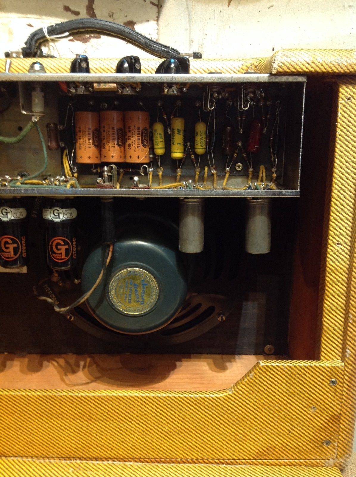

The original was about (H) 16'' x (W) 20'' x (D) 9-1/2'' . I think the bells were smaller.
