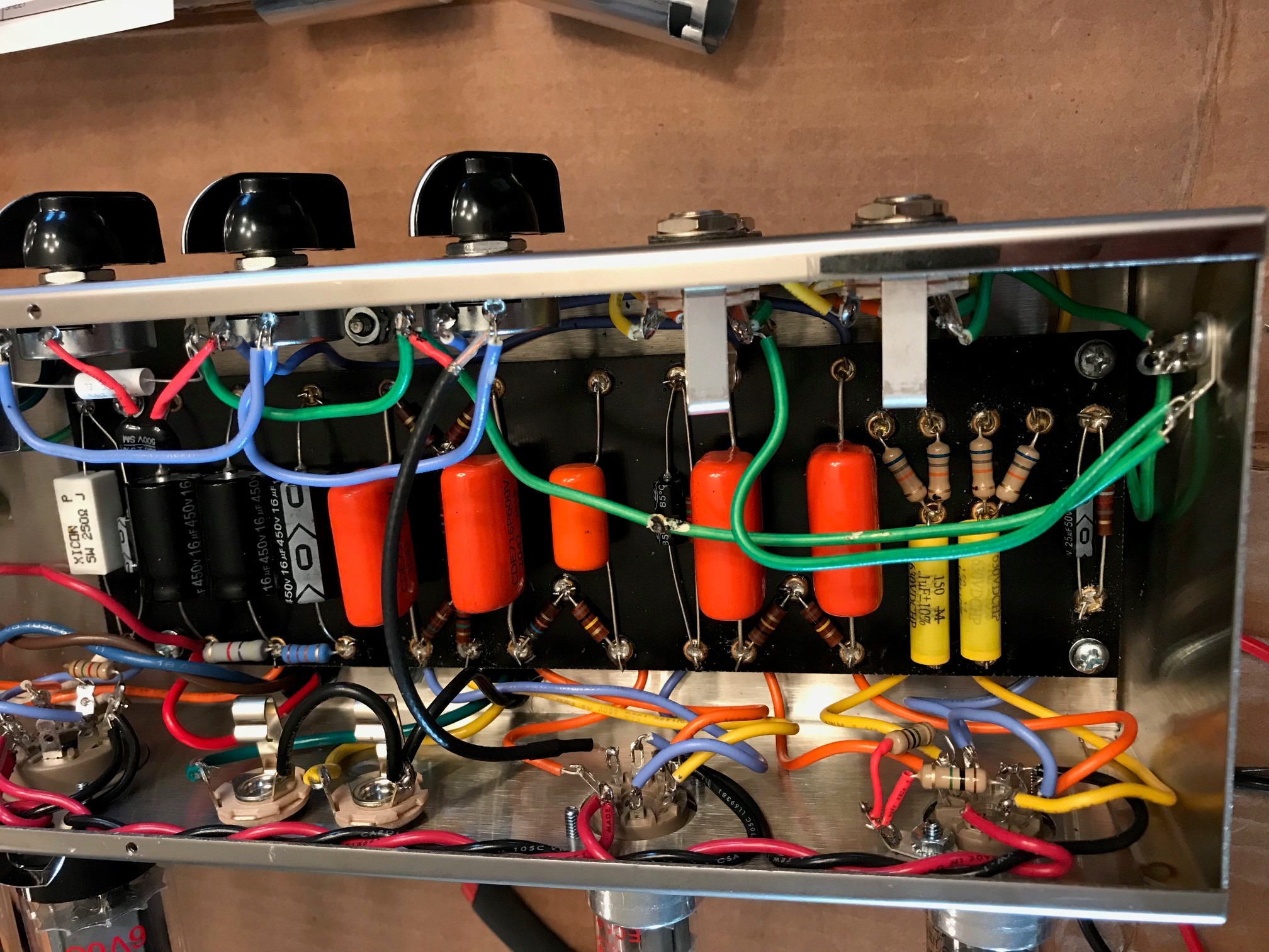

Attaching a photo of my build and the pre-amp area.
Worth noting that I have prepped for a VRM, so I have installed .1uF filter caps and relocated the 1M input resistors directly to V1.
