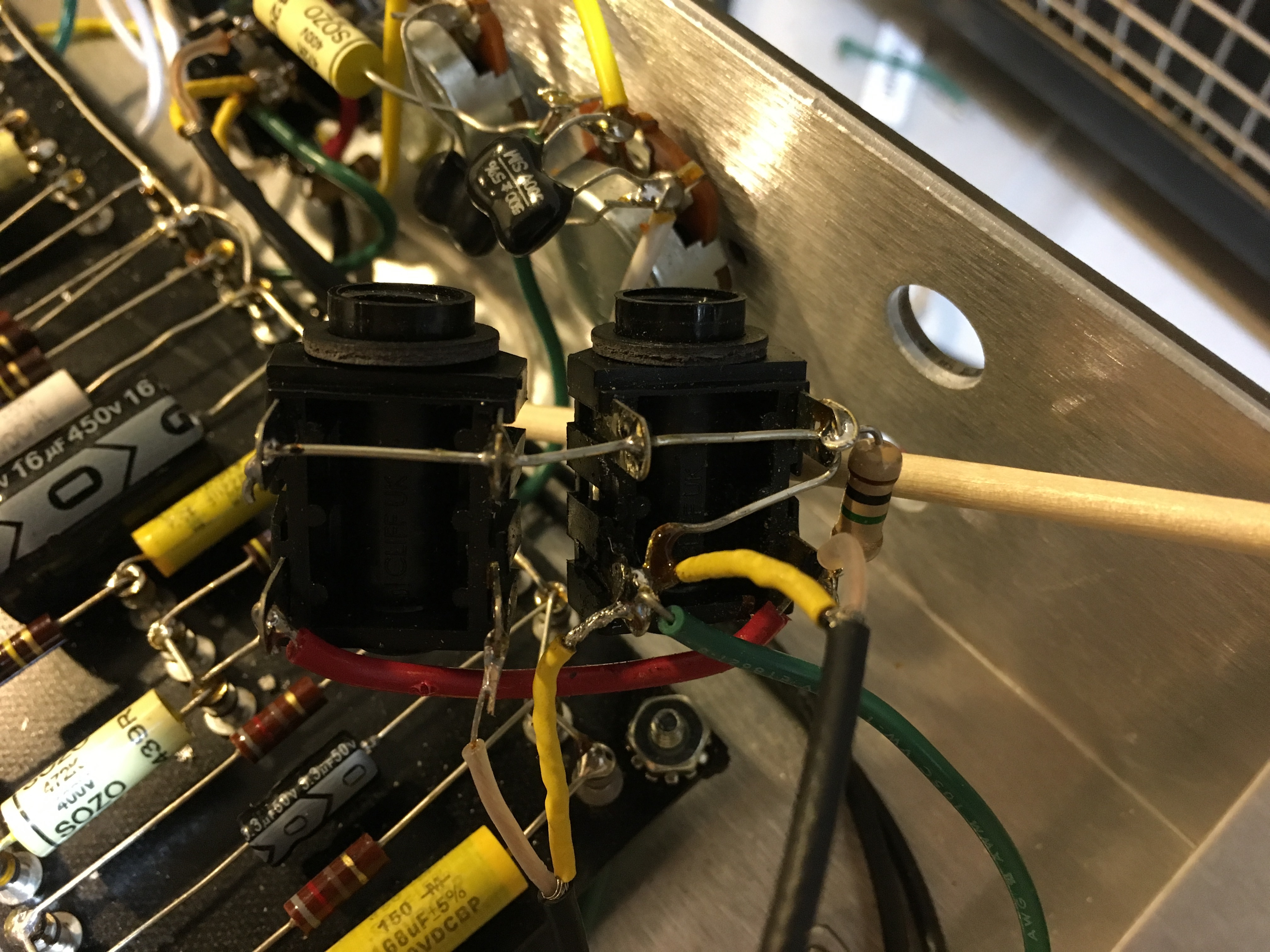

took a picture of the power end of the turret board. The R-21 resister shows a resistance of 2166 ohms. Added a photo of the regular channel input jacks disconnected from the chassis. A moot point if there is a short.
I have solid solder connections of the elements on the turret board (chop stick probing shows nothing loose.) My continuity tester buzzes when I probe virtually everything on the board to ground. Once again, My ignorance of the basic procedures is exposed here. The manual for the tester says that buzzer sounds if the resistance of a circuit under test is less than 100 ohms.Does this buzzing with probing of the capacitors / resistors to ground indicate that there is no continuity? / no ground?
Stephen told me to check the coaxial cables for a potential connection between the shielded inner cable and the ground sheath. The continuity tester buzzes when probing the coaxial cables to the overdrive channel, but not the normal channel. Once again, can you help me interpret this. I took another look at his note, and he said to disconnect these to test them. I tested this in place. Will disconnect and test again.
virtually certain that the leads to the capacitors / resisters on the volume / tone pots are not touching each other, but will check this more closely.

With nothing plugged into the input jacks, you should read a short from the hot terminals to ground. You should see this at the 68K resistors, too (the ends not connected to the tubes). This is the switch on the jack connecting hot to ground to mute the channel if nothing is plugged in.
With a patch cord plugged into a jack, the switch opens and you should no longer see the short from hot to ground at that jack. You should see continuity from the tip of the free end of the cord right to the 68K resistor that's associated with that jack.
With your tester, beeping means continuity. If you are looking for shorts that shouldn't be there, you should hear no sound. If you are looking for something that should be connected, there should be a beep.
I prefer a good digital ohm meter when looking for continuity. If you see 0 or .1 ohms, you know for sure the connection is good. A cold solder joint that's gone reisistive might show good if the tester's threshold is 100 ohms.
