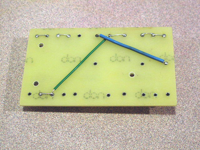

I wired the power supply and the power amp for the new circuitry point-to-point. But the Tramp preamp is more complex than what the Bogen originally had. It was easier to build this on a turret board rather than wire it point-to-point. There's enough room in the chassis for a small turret board so I made one similar to the preamp section from the Tramp board.

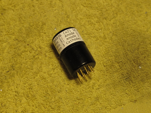

The Bogen originally had a tube rectifier using a EZ81. I left the wiring for it in place but I could only get about 340 volts out it. The Tramp circuit calls for 400 volts for the B+. It also uses solid state diodes which are more efficient than tubes so you get more voltage. Rather than wire in a couple of diodes, I made a little plug-in solid state rectifier to replace the EZ81. I used a couple of tube socket extenders and wired two diodes to the pins inside.
I can easily switch between tube and solid state rectification now, although that doesn't make much difference with a single-ended amp. I didn't implement the Tramp's VRM circuit. If I want to run the amp at lower B+ I can plug in the tube rectifier. It doesn't change the volume much, though.
